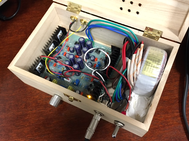

+1 on JLH head phone amp. $20 can't beat the sound quality for the price. Very easy to build.
2016 NEW JLH HOOD1969 Class A Headphone Amplifier PRE AMP KIT DIY-in Headphone Amplifier from Consumer Electronics on Aliexpress.com | Alibaba Group
Need to add an $11 25va 15v toroidal trafo for the PS.
AN-0215 - 25VA 15V Transformer - AnTek Products Corp
Here it is installed in a small $5 craft box from Michaels's crafts store.

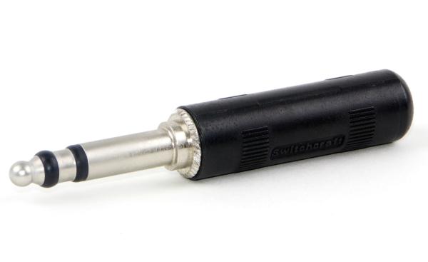

the B22 is known to lunch its output Q when "hot plugging" the standard TRS connector - headphone amps need to be able to survive shorting the outputs to each other with signal present

wrong, the TRS temporary short on insertion/removal is R,L channel-to-channel, not to gnd and does happen with 2-channel
"3-channel" is just wrong by itself - technically flawed arguments, waste of resource for worse result - a unfortunate headwize fad that I keep having to explain
The cheap consumer plugs do. Not the real deal. Unfortunately the real deal doesn't work with the cheap consumer jacks.
