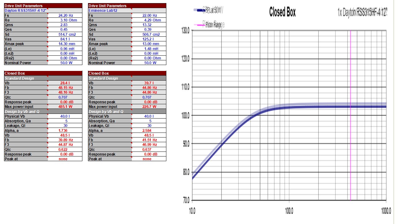

These woofers can be driven by more than 50 W. The displacement limited SPL is about equal for these woofers.
You might want to take a look at the Dayton RSS315HF-4. This works better in smalld, sealed boxes than the HO version.

Modelled in UniBox the Lab12 and the Dayton RSS315HO. 40 liters is not a hard constraint, but used 40 liters for comparison purposes, and sealed (for now).
I still don't know how to insert an image inside the text in a post here, so it's attached. The superimposed FR shows the lab12 having more SPL for most of the usable band. Am I being unfair to the Dayton? For the % price difference it's not bad at all, but additional $55 get me about 4dB SPL extra, which seems worth it.
Vb for the Dayton is 9.7L ?

Thanks for the hint! Indeed, this one performs as the Lab12 (see attached) and is cheaper. Will look into sourcing options.
TBTL: isn't this a moot point as both drivers can be driven by more than 50W? Regardless of the amp I choose I will get about 4dB additional SPL with the Lab12
