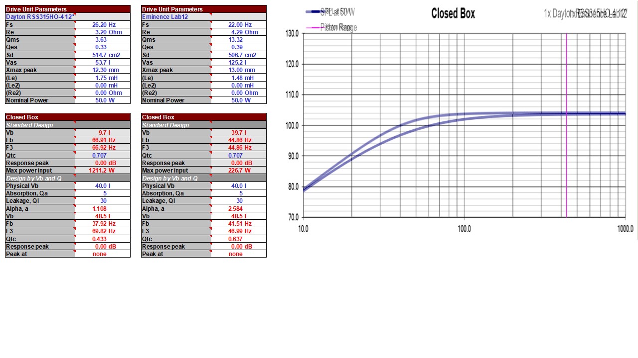

Modelled in UniBox the Lab12 and the Dayton RSS315HO. 40 liters is not a hard constraint, but used 40 liters for comparison purposes, and sealed (for now).
I still don't know how to insert an image inside the text in a post here, so it's attached. The superimposed FR shows the lab12 having more SPL for most of the usable band. Am I being unfair to the Dayton? For the % price difference it's not bad at all, but additional $55 get me about 4dB SPL extra, which seems worth it.
Vb for the Dayton is 9.7L ?
You might want to take a look at the Dayton RSS315HF-4. This works better in smalld, sealed boxes than the HO version.
Johan-Kr
Thanks for the hint! Indeed, this one performs as the Lab12 (see attached) and is cheaper. Will look into sourcing options.
These woofers can be driven by more than 50 W. The displacement limited SPL is about equal for these woofers.
TBTL: isn't this a moot point as both drivers can be driven by more than 50W? Regardless of the amp I choose I will get about 4dB additional SPL with the Lab12

In my music system I have two sealed DIY boxes with 12" Rythmik kits in. Want to build one or two additional sealed boxes, this time with pro drivers and powered from a class D amp.
