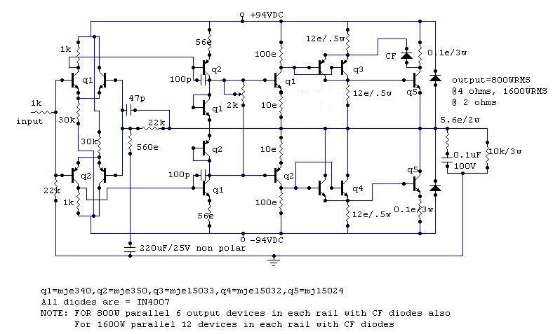

What about this amplifier?

amp_man_1: That looks really good, simple too easy just to parallell more devices to be able to go lower.
Any other guys have an opinion on the circuit.
It can't be to hard to make a PCB for this card.
Thought's??

djchrisquad, Rod Eilliot does.. and his PCB's are not very expensive... actually the price is very reasonable.

I might like an additional emitter follower in the output stage driver (like Leach's Low TIM Amp project) if I'm going to try to get lots of current out of this amp.

Hi Guys....
Was going to build an amp posted by hugobross i think.... but was looking at this thread... and some of the amps looked much simpler (elector and npn?).... is it easy to modify these to run mj21194/93? i've got 20 of each and wanted 2 monoblocks for my pa.... anywhere around 700 odd watts? can anyone help me... i've been doing electronics for ages... but all this analogue gives me a headache.... much as i love it...
