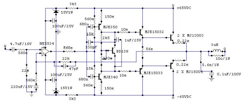

Good 300 W 8 Ohm power amplifier
Reply
CHECK THIS OUT
Hi Guys....
Was going to build an amp posted by hugobross i think.... but was looking at this thread... and some of the amps looked much simpler (elector and npn?).... is it easy to modify these to run mj21194/93? i've got 20 of each and wanted 2 monoblocks for my pa.... anywhere around 700 odd watts? can anyone help me... i've been doing electronics for ages... but all this analogue gives me a headache.... much as i love it...
