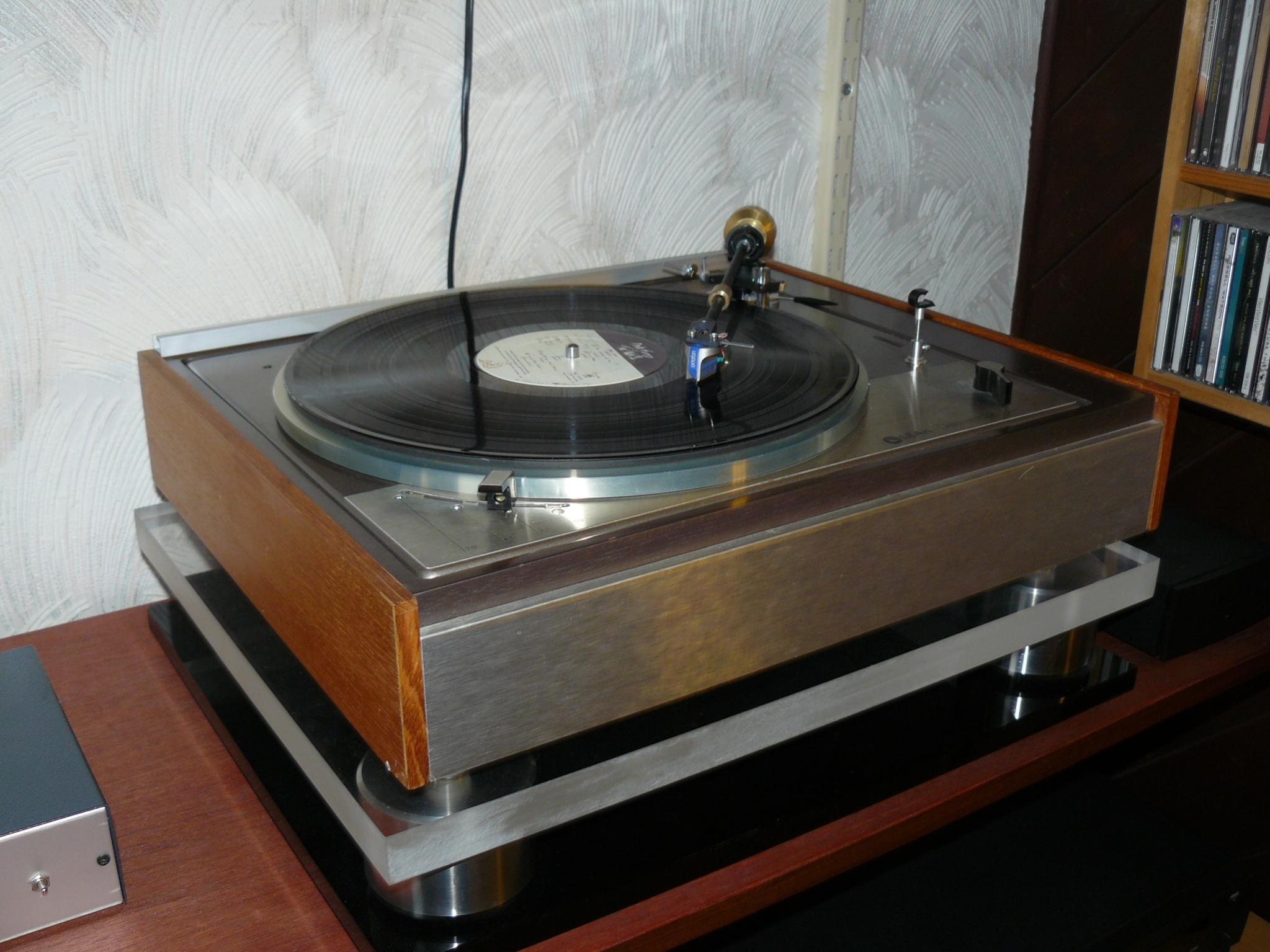

Don't write off the Lenco tonearm just yet. I've been playing around with Lencos for a fair old while and recently I picked up a mint 75. This deck really is too good to butcher so I've decided to see if I can do something with it. The arm is the weak link, the rest can be sorted so I've stripped it down and rewired it and fitted new Desmo V blocks. These are hard blocks and very nicely made so I'm expecting some good results. Keith the guy who supplied the V blocks has shown me how to make the droopy end stub solid and I'll be finishing that off tomorrow. A new external arm cable will be added as well as a better cartridge mounting platform. I'm confident I can get a Denon DL103 to work well in this arm. I'll post a few pics of my progress tomorrow.
I should add that the deck is working fine at the moment fitted with a modified Grace arm and Kontrapunkt B cartridge but it would be nice if it could be made to sound something like with its own arm.
