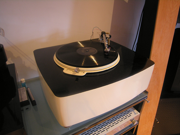

I have a replinthed lenco L75 and in another room a Teres 360 clone. Very little difference in SQ between them - and I can tell you the lenco is a lot easier build.
You do need to relube the motor and main bearing, get rid of the arm and fit something god an decent. All points like idler wheel etc need to be fettled to prime working order.
An air bearing arm, or shroder clone, or cantus arm would match very well.

Nice builds Fran !
I guess after all those mods calling that table a lenco is a bit "rich", better Fran-Lenco, so a Fran-lenco sounds good ...? 🙂

woodturner-fran: absolutely beautiful work. I bet it sounds amazing. Particularly when you compare it to your Teres.

Yes indeed. There's a lot of the info you'll need on lenco heaven - when I did mine I used their plans to make a plywood plinth, but also drilled some large holes through the plinth and filled that will lead shot for extra damping. Make sure as much as possible of the metal plate mates with the plinth.
I since found a second L75 in pretty much perfect shape and I intend doing a PTP build. A lot of guys are talking about slate being ideal, so I might just have to investigate getting some. Another bit of me would like some kind of cement/resin type plinth - perhaps CLD or something. I need to think and investigate more on that.
Personally, I think the arm is pretty much crap and just dump it, along with its associated mechanics. Add something like a rega rb250/300 etc and you jump up a serious number of notches.

woodturner-fran: This (the RB250 particularly) surely has to be one of the best buys in audio history. Hot-rodding one can provide very good results at a very reasonable price. Even doing a complete modification build less bearing(s) can get you a long way towards an ultimate. Is it a SME (I have a 309 mag)? NO, but it doesn't cost like one either.

The OEM arm on the Goldring GR1.2 is a Rega. It can be improved to near "super arm" levels of performance.
How can I achieve this? Thanks
Basically three or four steps:
- Replace the end stub of the RB250 or RB 300 as per Origin Live or similar.
- Replace the internal wiring of the tonearm with improved wiring (you can purchase kits from Origin Live and Audio Oragami as well as Ingognito). A complete DIY version can be done for much less as long as you can solder. To do so requires a pair of good quality RCA plugs, 4 cartridge clips (you may be able to salvage these or get some new ones), and 20' or so of a better tonearm wire. Cardas, Discover, eyc come to mind, but there is some commercially available wire that is suitable. I prefer single runs from the cartridge clips to the RCA inputs on your phono stage/preamp/integrated, or receiver.
- Buy or build an improved counter-weight. I really like (and have used) the JA Michelle "Tecno-weight which is excellent.
- Get a VTA adjuster nut or create your own. Thus you will be ale to adjust VTA for best performance of your cartridge. (Here again I have used and like the JA Michelle one.).
