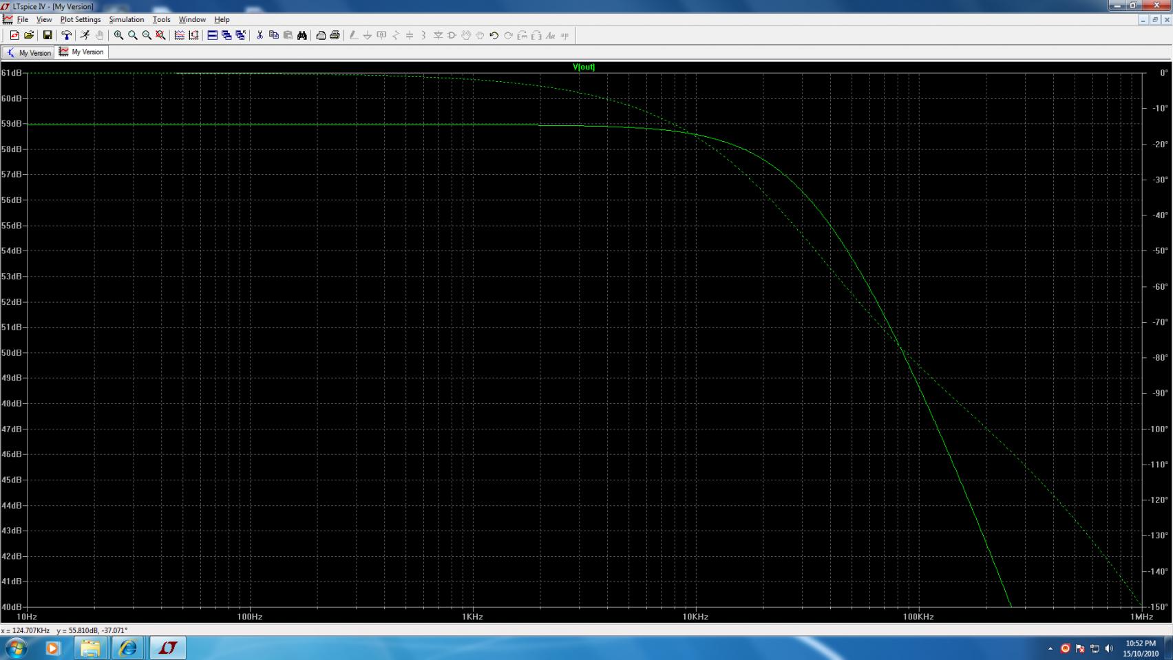

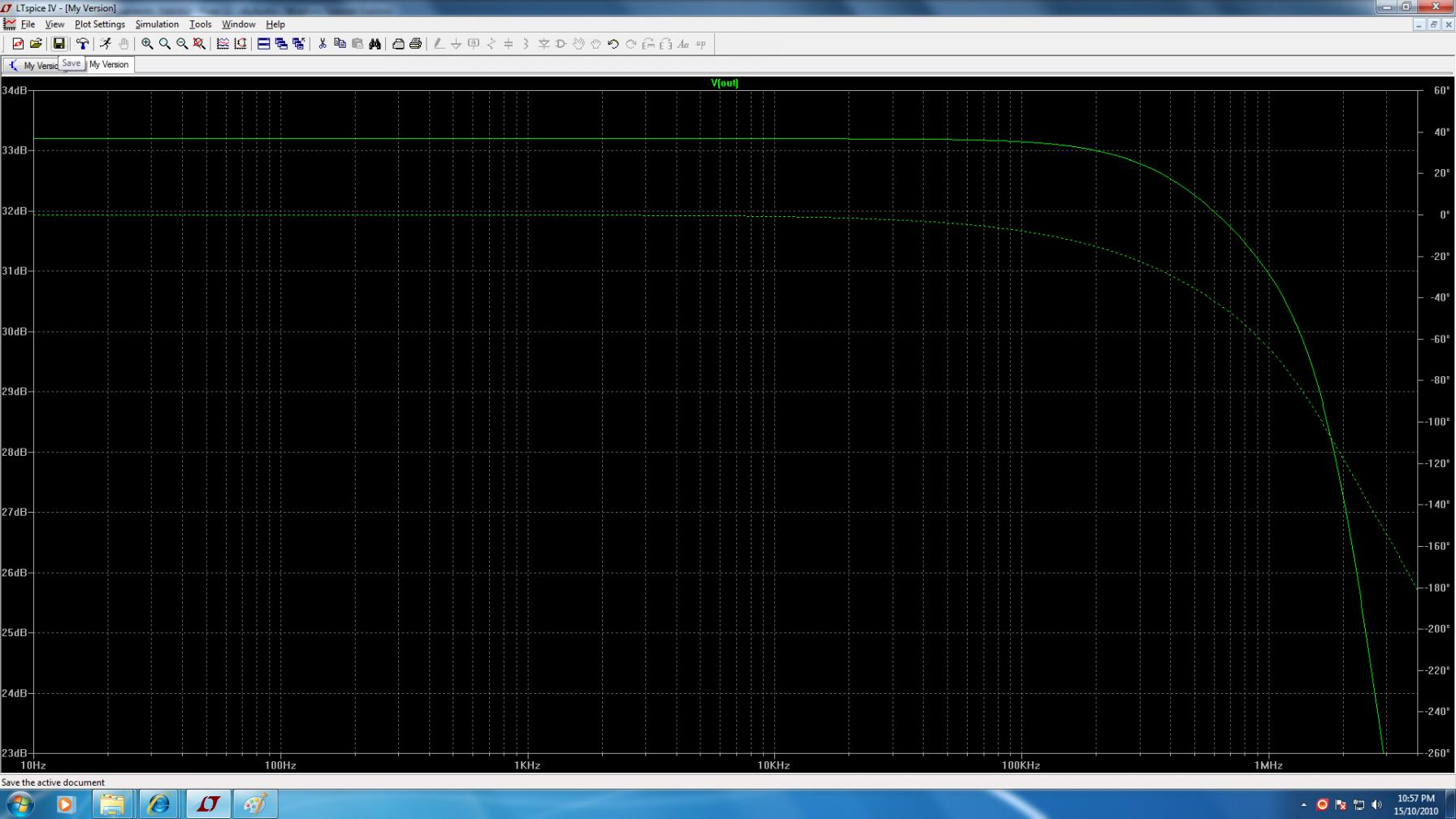

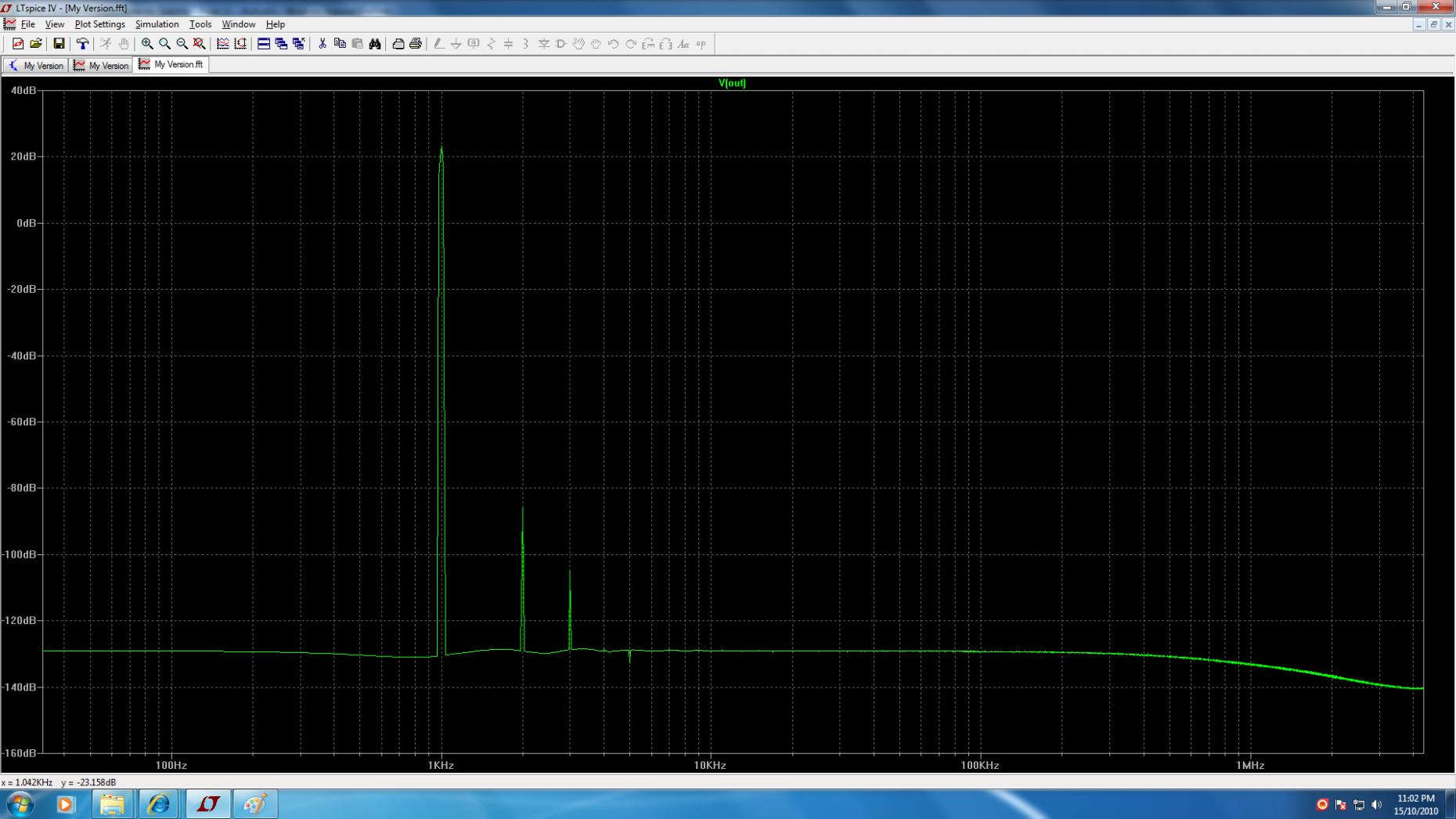

OS, what about your Darlington LTP VAS? How does it compare to cascoding? Cob is much less important now. This looks pretty useful to me if we want to keep the MPSA VAS.
- keantoken
- keantoken
P.S. I think OS had some Cmult in one of his amps, maybe he can say how they behaved when the amp was fully driven. He must have been seen some loss after the multipliers too if fed off the main Tx too. Also can his THD % and spectral differences with BJT subs be affected by different accuracy between companies models up to a point?
