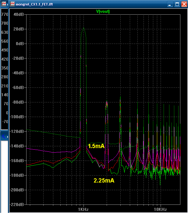

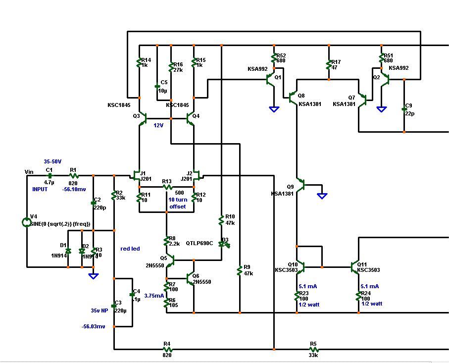

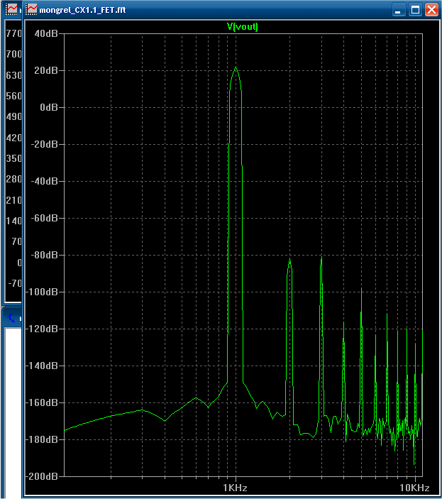

High bandwith/slew hitachi mod.
Since nobody else has offered a direction , may I intervene ?? Inspired by mr. Chua at Ampslab.com and his flagship Bi240 ,what I got was a hitachi based topology that has 120+ V/us slew (everbody's requirement) ,a OLG of over 72DB (lee's issue) and is stable with 87 degrees margin at a UG of 890KHZ (pretty high bandwidth). All I had to do is alter the VAS with EF's (below) and degenerate the stages appropriately.
Still tweaking it , but it has possibilities. THD 20 .0015% / 1K - under .0008% @ 40v p/p. About twice as good as my original symasym (CX) , with over 20db more gain. :)

Which JFet are you using?
Can we modularize this so we can test it with Different backends?
If we can can we then have different output power specs like 100W and 200W and 300W?
J201 fairchild low noise Jfet (40v Vgs) , cheap at mouser , says "made for audio"
Product Folder - J201 - N-Channel General Purpose Amplifier, Fairchild Semiconductor - Global Leader in Power Optimization
At the "high end" 110v p/p (77vrms- 392w , truly fictional), I get .008% @1k and worst .012% THD20. About 4 X as good as my big symasym.
I already am on my way to replacing the CX with this , at least in prototype form (CX1.2/3) so , I can try it on my 200w BJT OPS. :)
CCS adjust stepping (PIX1) 2.25 mA is the best at the "tails"
(winner - pix2/.0006%)
LT below "CX_1.2fet.zip"
Edit : this would be a "no brainer" to port to driving laterals ... eassssy!!
