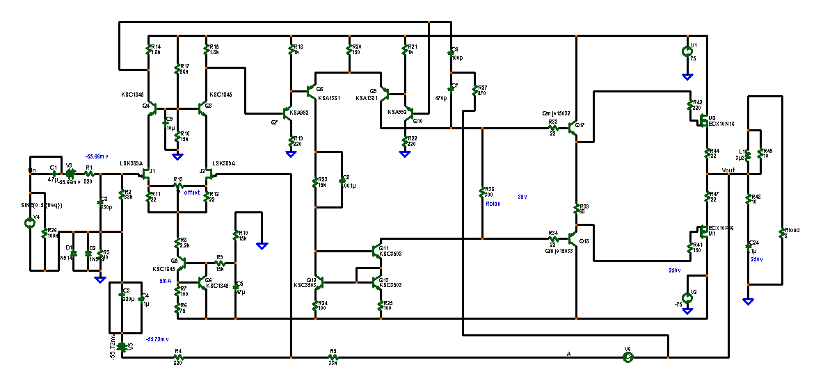

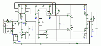

BTW , if someone want's to know what is best , I really don't absolutely know.. truthfully. But , by looking at the closest existing commercial kit , High End Power Amps - AmpsLab
I would bet on it as it is not a dream .. and of course we will be using the FET's for both the input and output.
My "take" on all of this is below... actually, I get way better specs than the ampslab in simulation. in real life with the fets and parasitics I should be at least on par with the BI240 while having the "magic sound" of the laterals. (see schema/LT asc below - exicon lateral models).
OS

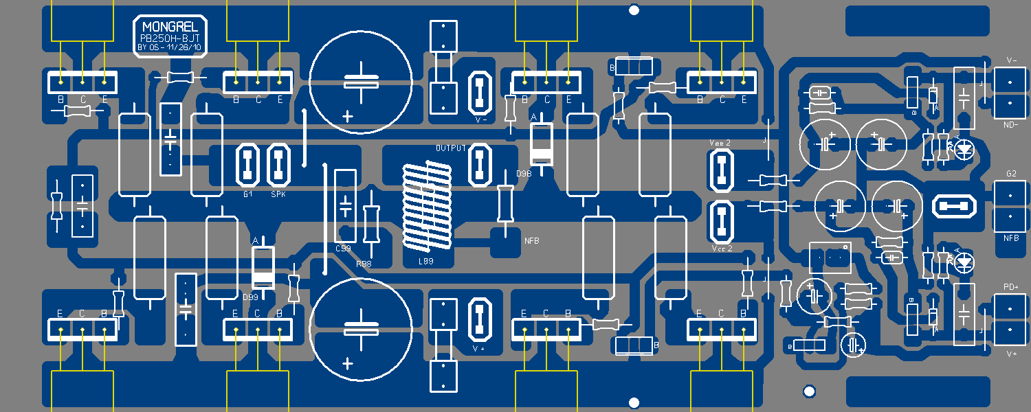

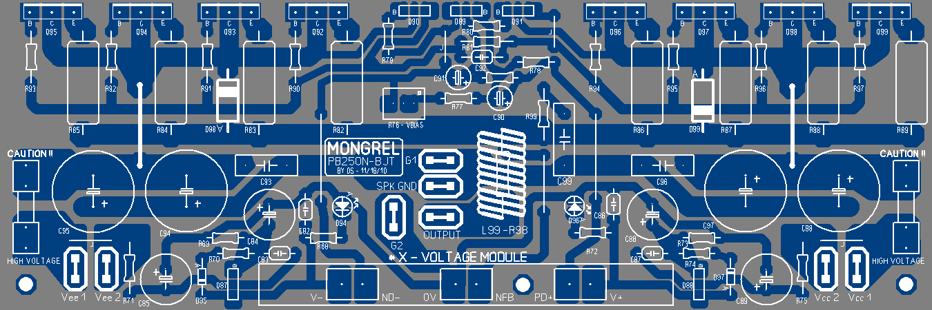

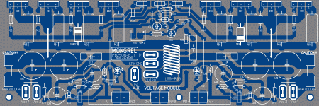

y' all must choose (pix 1 -vertical board) or (pix 2 - horizontal board).
Pix 1 will fit a 5" (125mm) high 200mm or longer heatsink and pix 2 will fit a 3" (76mm) heatsink for a lower profile. I will add the LTP /VAS to the boards , huge filter caps, split ground and supply fastons. The secondary supplies will be jumperable to allow for just single unregulated operation.
OS
