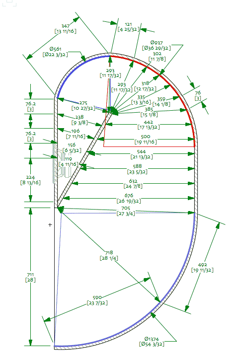

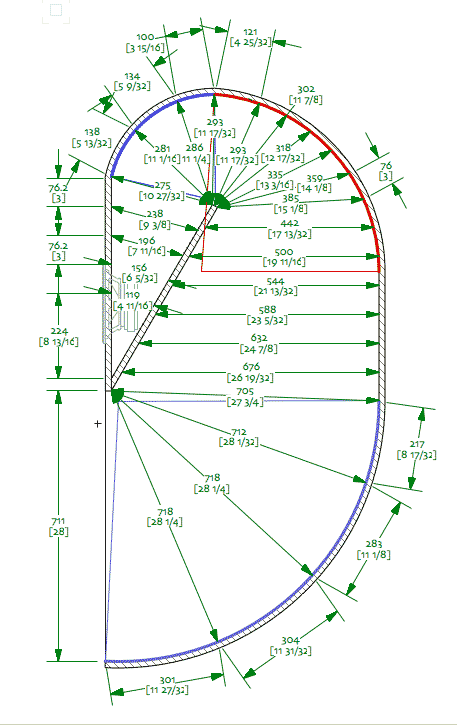

GM, if you can point out what dimensions you need i will measure that. Horn is 2 small straight sections and 3 circlular sections.

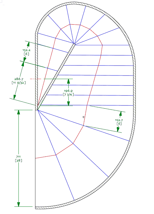

Can your program tell if it's expo, etc.? Regardless, every 3" like shown is plenty good enough and for this horn, maybe every 4" in the last, larger expansion. Once these are known it can be broken down into flat panels to 'trip up' its excessive HF.

OK, can you factor in the width to make each 'slice' an area dimension? Also, too little info [for me] to figure the area expansion for the circles. We need somebody with AutoCad......

Thanks! ...like I said....... 🙁 Oh well, if you can give me enough 'pie slice' areas, I can try empirically finding a 'close enough' flare frequency, factor if it is indeed near enough expo.

with the offset driver - hornresp could use another section to put the driver where it belongs - can't quite fudge it with the last part having length but essentially no expansion. Is there a good fudge with hornresp?
this may be off in expansion - have to look closer at P10's CAD sketch
has anyone simmed this yet?

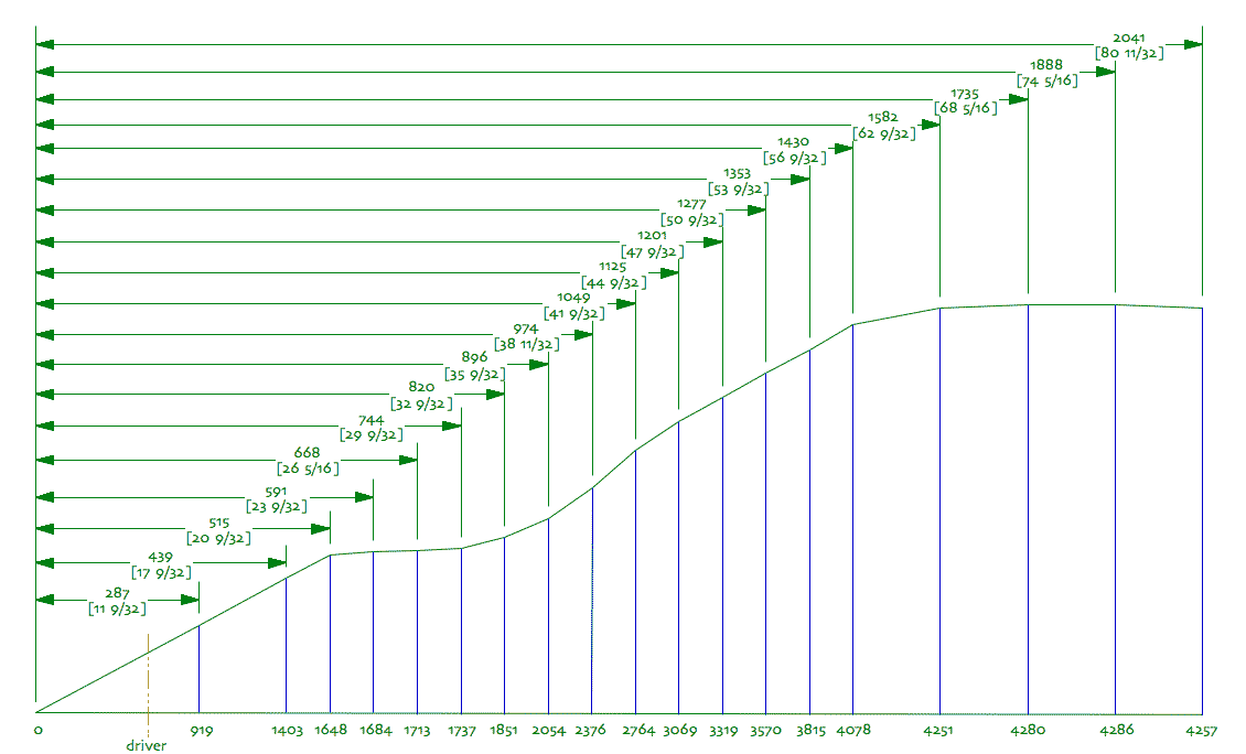

1st detail translates to the 2nd with length in mm/in and area in cm2

what exactly does the above drawing and measurement tell you?
