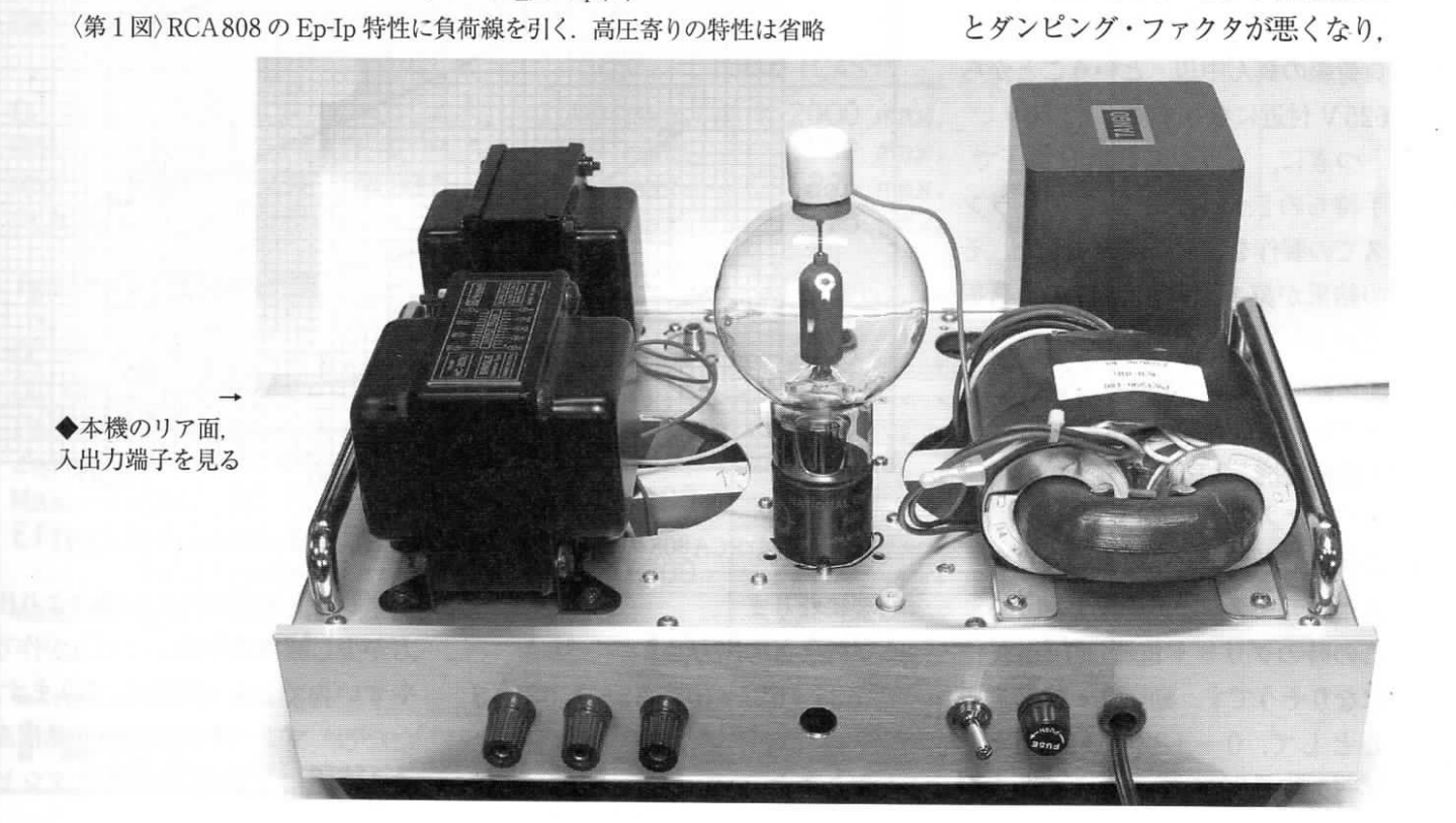

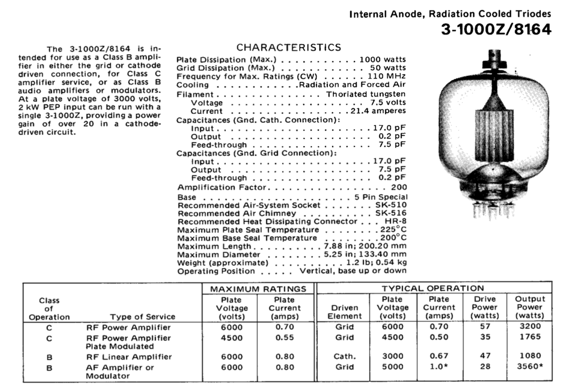

That picture on the right :
they look (to me) like transmitting tubes 😀

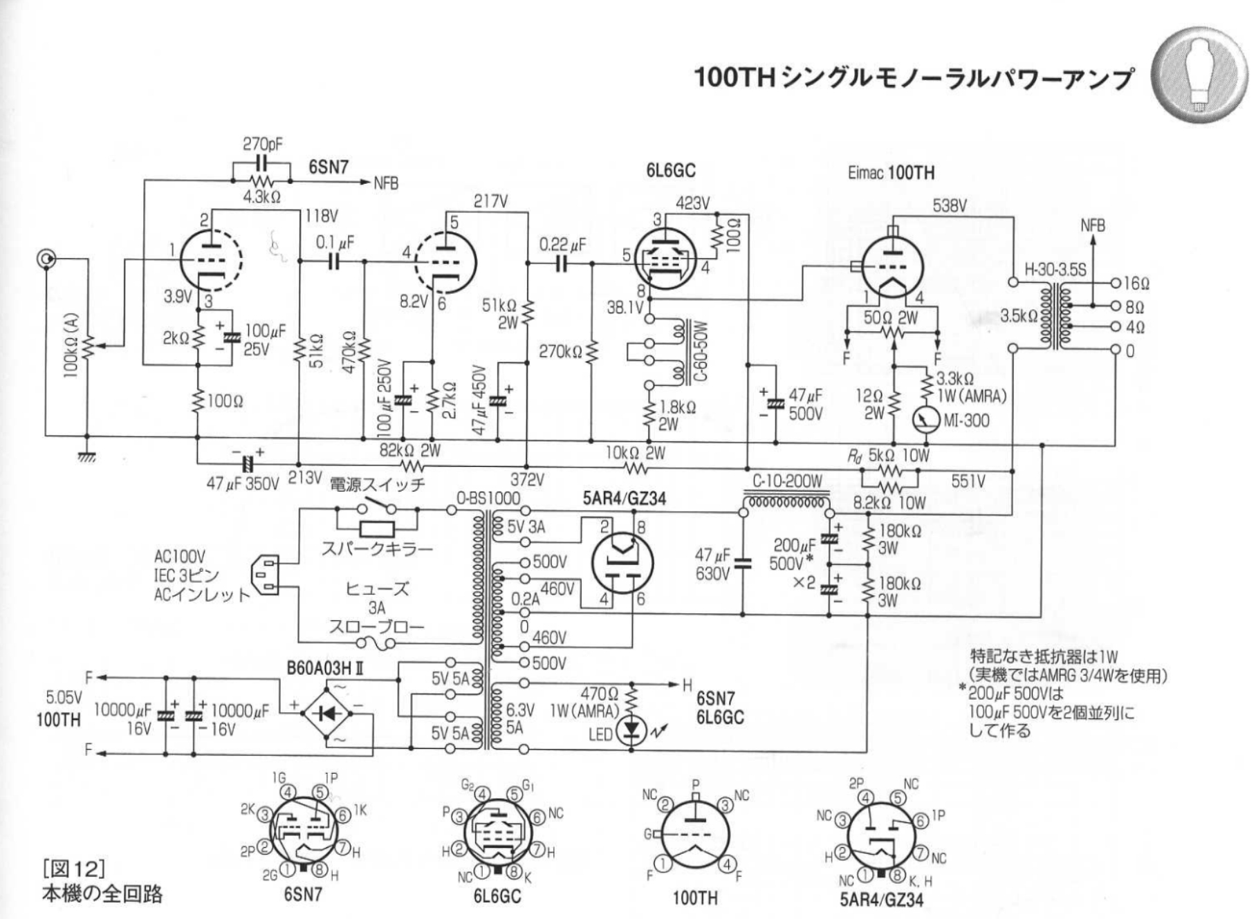

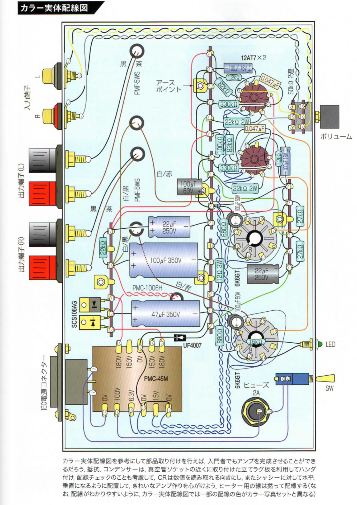

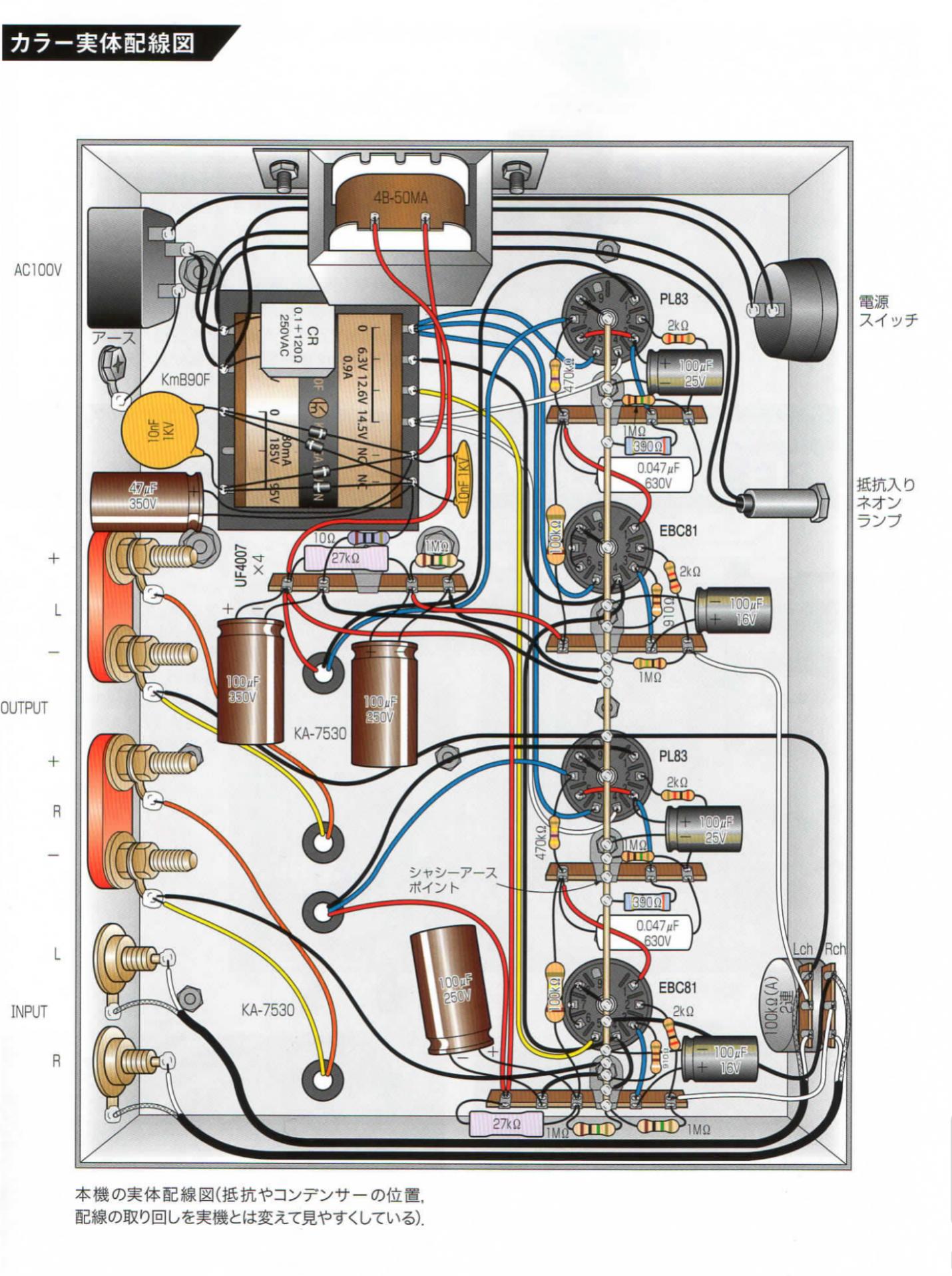

Thanks to Soundhappy for posting these links and stuff. My eye was caught with this PP tube headphone amp: MJ1801_(04)5670WA-pp-headphone-amp_YanagisawaM.pdf - Google Drive
What do you tube experts say - would it be worth the effort to build? Any design flaws?
I'm afraid that the Noguchi output transformer PMF-8P-10K is not available in europe. What would be a suitable replacement?

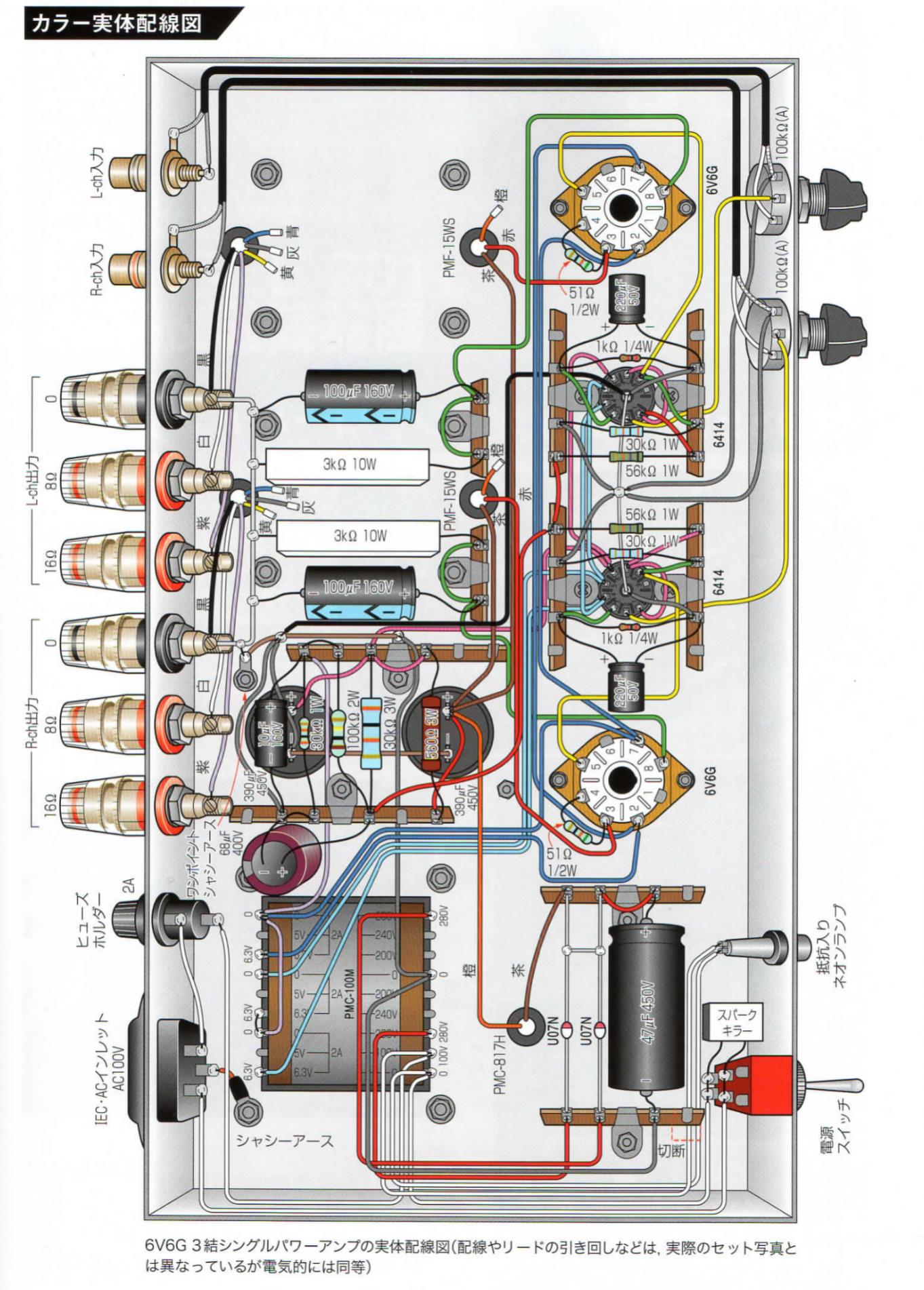

The current source used has, in my experience at least, very uneven impedance depending on frequency. One can bridge rectify the 6V winding, ground the positive side of that supply, then you end up with a negative rail which allows for a higher performance CCS.Thanks to Soundhappy for posting these links and stuff. My eye was caught with this PP tube headphone amp: MJ1801_(04)5670WA-pp-headphone-amp_YanagisawaM.pdf - Google Drive
Power is so low that the choice of output transformer is quite open.

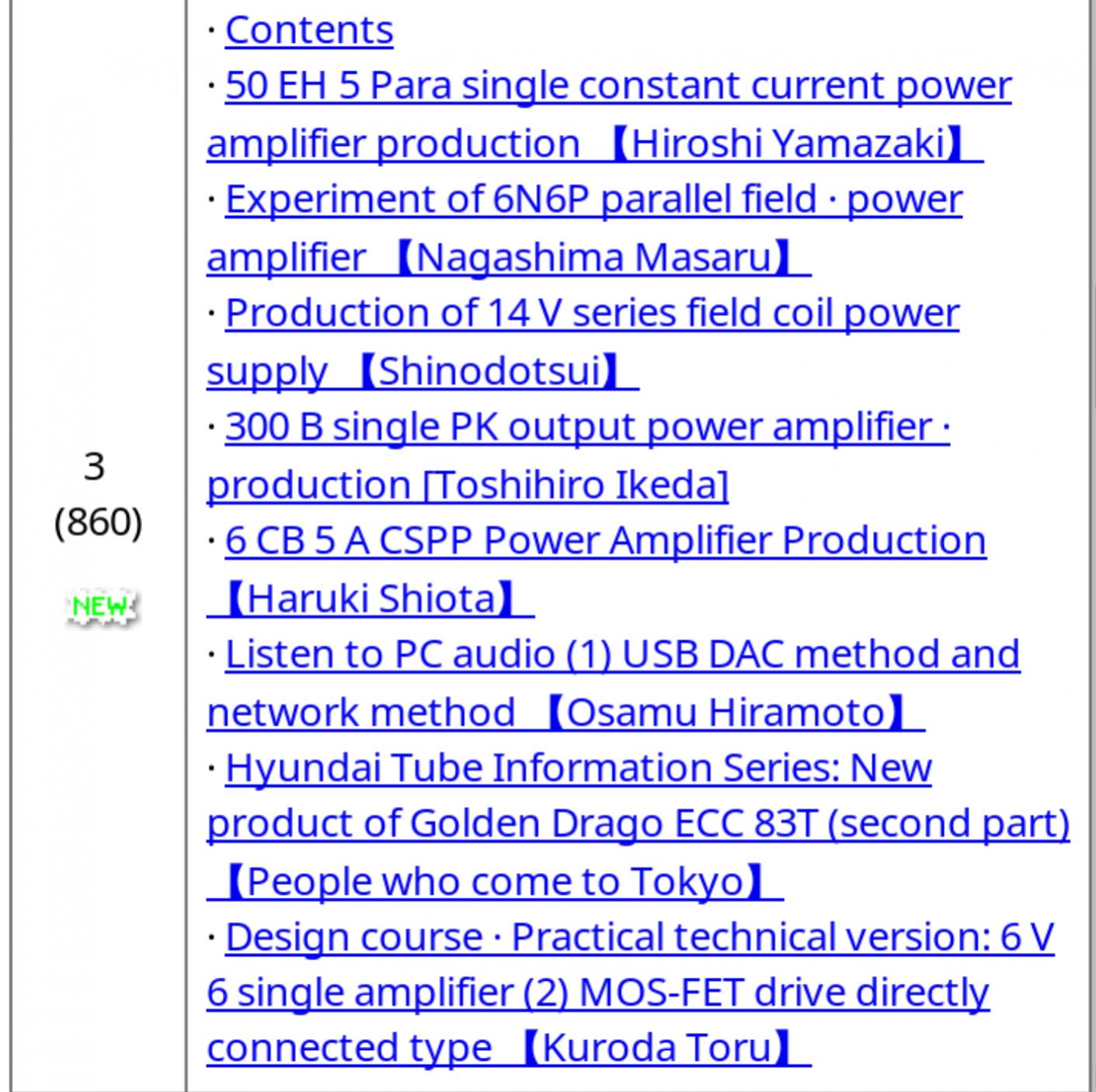

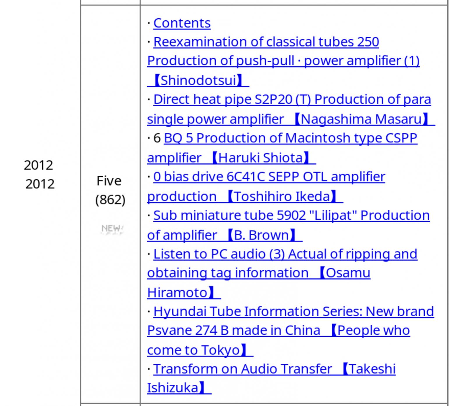

News about older articles now available.
That is possible only because work of Distant Past Radio Boy
Thanks for all DIY spirit of knowledge share with generosity 🙂

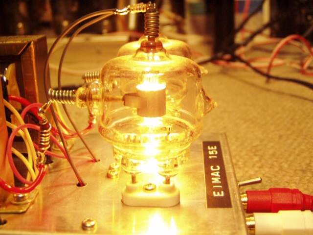

I see a 15E amplifier! Always wanted to try this little tube. Any link to index or info on "Distant Past Radio Boy"? Google provided me with nothing.
-Kent
-Kent
Could you elaborate on this? What CCS would you use that requires a negative rail?
