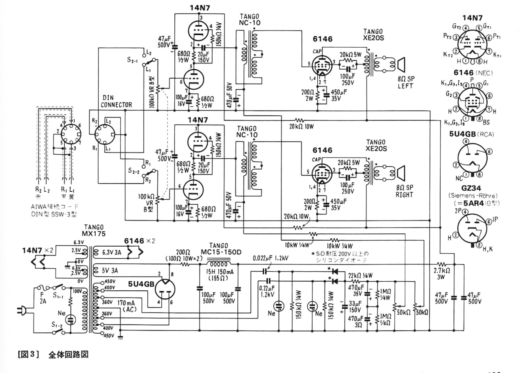

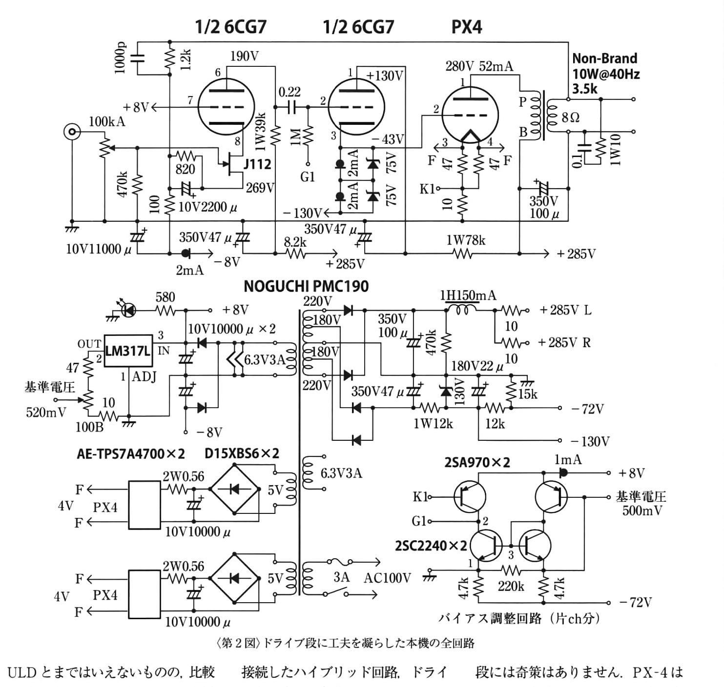

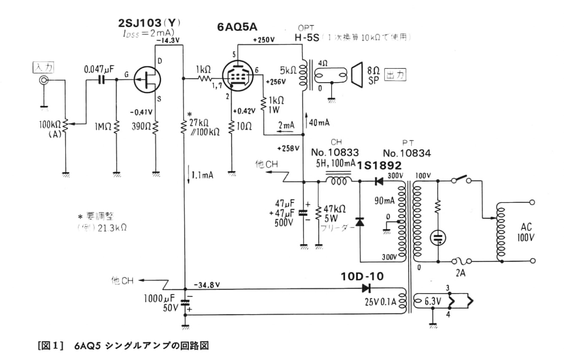

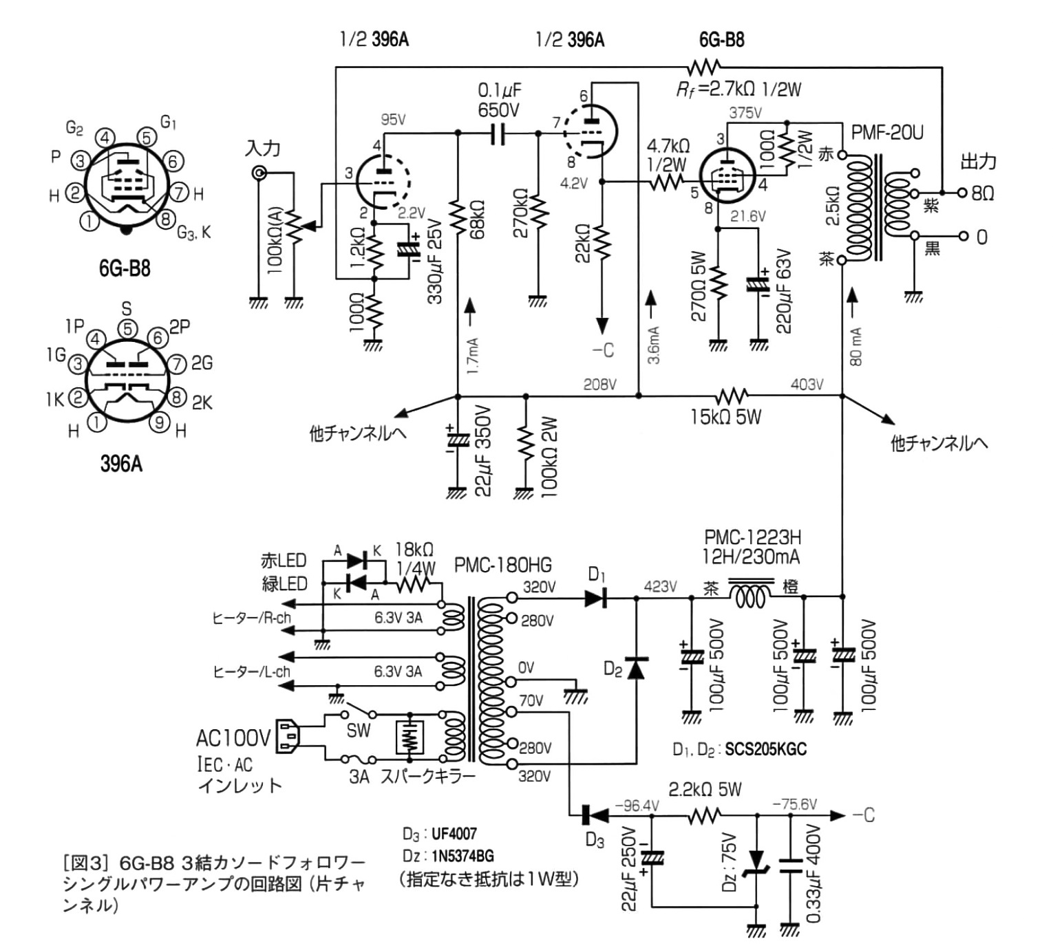

it's just a step up autotransformer. Follow the dot!
Ah, you're right! The way it's drawn threw me for a loop! But what's the benefit of connecting as an autoformer instead of a traditional interstage transformer? Since there is no global feedback, neither would cause oscillation anyway. I believe the NC10 is a 1:1 ratio transformer so neither connection would have step up gain. I prefer the signal to be magnetically coupled even if it's less "pure" but I personally like transformer coloration.
Looks like one of those slightly bizarre part applications only the Japanese are capable of 🙂
The NC10 basically replaces a grid choke with some added gain. It's main function appears to be a low dc path for biasing and the gain is just an added bonus.
Imo this part sounds much better with no dc current flowing which may be another reason for choosing the unusual application.
