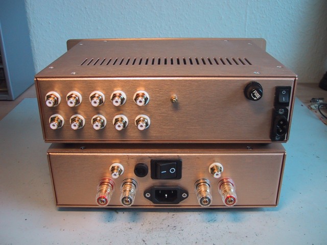

Very nice work Steenoe, if i should comment on something it should be the red leds, but actually they look good together with your champagne kabinets....😀

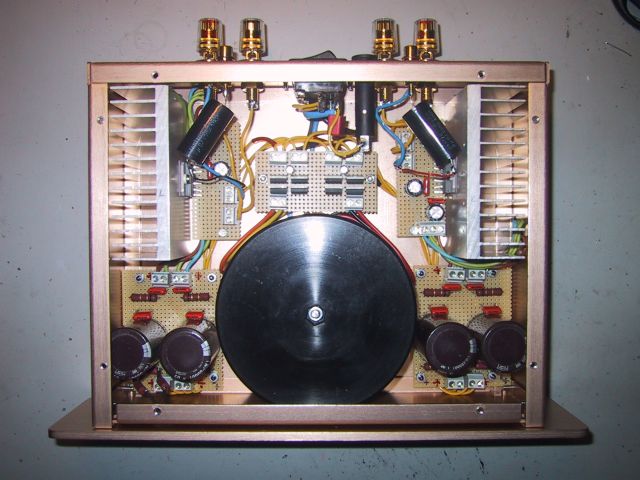

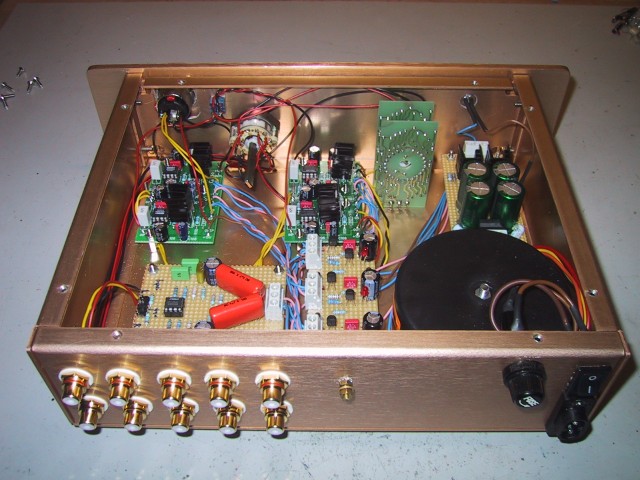

From the downloads of the preamp internals pic, I recon it is fairly
interesting to people right now. Here is a closer pic of the PSU boards in case it could be inspirational to someone🙂
Complete description is found on Nuuk's very good homepage:
http://www.decdun.fsnet.co.uk/gainclonepre.html#gcprepsu1 As said, it is a very quiet supply, it is made with seperat feeds for right and left channels. Great supply.

It is the TO220 case with small cliponheatsinks. The buffers are running in wide bandwith.have you use PDIP packaged buf634 in your buffer?

Steen,
Have you listened to the zener+emitter follower and compared it against Nuuk's dicrete reg?

To get back on thread, I am quite amazed by the VSPS phonostage that was built in to this preamp. For such a simple circiut it sounds pretty good🙂 See this thread:
http://www.diyaudio.com/forums/showthread.php?s=&threadid=33555 . Here is one more pic, showing the VSPS.

No, unfortunately I didn't yet. I had a little trouble fitting the zener/emitter follower in to the small chassis, as I planned.Have you listened to the zener+emitter follower and compared it against Nuuk's dicrete reg?

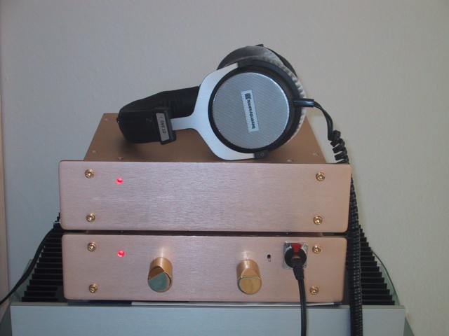

Steen, could you please tell me a litle about those headphones?

Hi there Marius🙂 Yes headphones..... I have tried a few of those. The ones on the pic are Beyerdynamics DT880. They sound great, to say the least. I also have a pair of Stax electrostatics, but they are quite old now. The Beyerdynamics rocks😉 The electrostats used to sound better, but I guess they need an overhaul somewhere!! But they are not cheap!!!! You better make up your mind if you want new speakers or a set of headphonescould you please tell me a litle about those headphones?
Hope this helps, or you can come down to DK and have a listen for yourself😉
