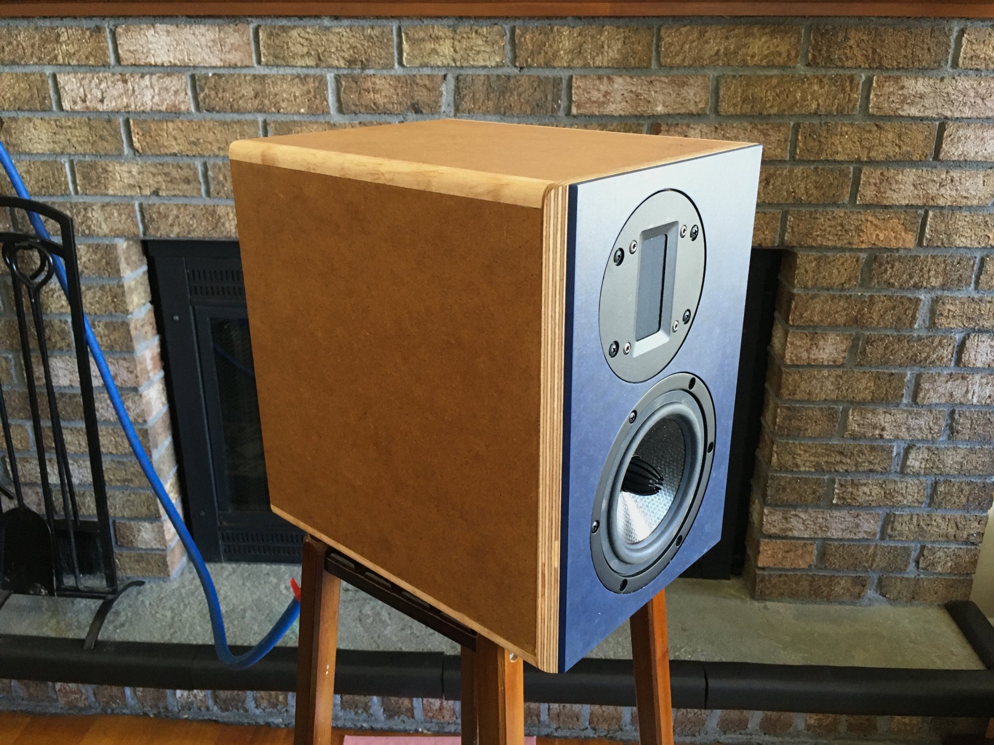

My "day job" is as a classical music record producer--loudspeaker design is a lifelong hobby that morphed into a paying moonlighting job. I don't have the time, money, or the equipment (poor poor pitiful me, Dear Lord, Don't buy me a Mercedes Benz, buy me a Klippel NFS--with due respect to Janice Joplin) to make measurements of all those drivers.
Jim and I wanted to get our ideas out to where they might do some good, and give people one more tool to help select drivers.
I know that AF has helped me in my own design work. The Eton Symphony II 5-inch woofer in the build pictured below was chosen in part on the basis of AF.
