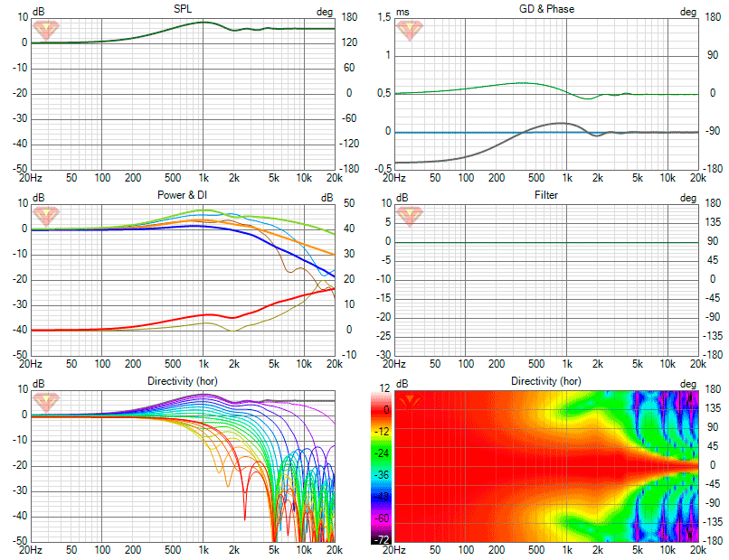

I don’t know much about compression drivers so I am luckily unaffected by that in this context. sound pressure in the listening position (aka far field) is proportional to the cone acceleration. increasing Bl and lowering Mms increases acceleration for the same electrical drive level. hence sensitivity goes up. There is no inherent bandwidth limit other than after cone break up the cone is not accelerating like a piston and sensitivity goes down (after a potential spiky resonance)Can you explain post #21 in light of no difference between mass of cones and it's "speed", in this case bandwidth.
Because I can't get around a restriction to the statement. E.g. BL changed otherwise bandwidth (and sensitivity) will in fact change. I'm not sure where to draw the line between a woofer and a compression driver, even though TS don't apply to compression drivers, yet no idea why the same rules wouldn't apply for mass, force etc.
