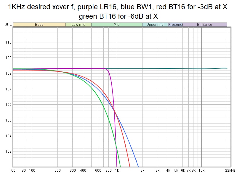

I mean look.... that '16th order Bessel squared filter' posted starts rolling off at < 500Hz, and is down <1 db at 1kHz, 5 dB at 2kHz, and only 22 dB at 4kHz,...4 octaves later. That's a long way from steep !
I'm no expert on bessels at all...bewildering array of options for them in prosound dsp's.
Anyway, below is a grab from the chart previously posted.
It has the same BW 1st order LP, and lin phase LR 16 LP as before.
And I added two bessel 16th LP's, designed to have matching xover points to the BW and LR, so that slopes can be compared. dsp outputs measured, not sims.
The red trace is bessel 16th to match the BW -3dB at xover.
The green trace is bessel 16th to match LR -6dB at xover.
Looks to me like a bessel 16th is more akin to first or second order.....when you look at the entire rolloff.
