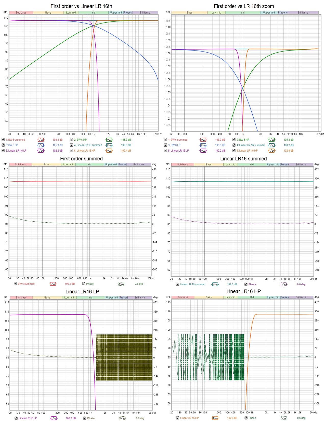

But anyway, attached is a chart showing IIR BW 6dB/oct first order vs linear phase LR 96dB/oct 16th order.
Top two are comparative magnitude traces for summed, LP,and HP... and the same zoomed in.
Middle two are mag and phase for LP and HP summed.
Bottom two are for the phase traces of the linear phase LP and HP, just for additional illustration.
These are measurements. I used an un-calibrated sound card so even the small phase variations of the sound card are shown to be identical.
As far as improved polars, I have made many measurements, that have proven to me that the ability to narrow the range of frequency overlap, reduces the extent of lobing. As per the chart's top right mag zoom-in.
The second benefit to polars is that complementary linear phase xovers allow the xover frequency to be moved up or down to help match horiz and vert radiation patterns, all the while maintaining flat mag and phase on axis. (This assumes pre-xover minimum phase mag flattening was applied to the drivers.)
It's the easiest way I've found so far, of trying to find best xover freq for polars....which is the most daunting task in speaker tuning i think.
