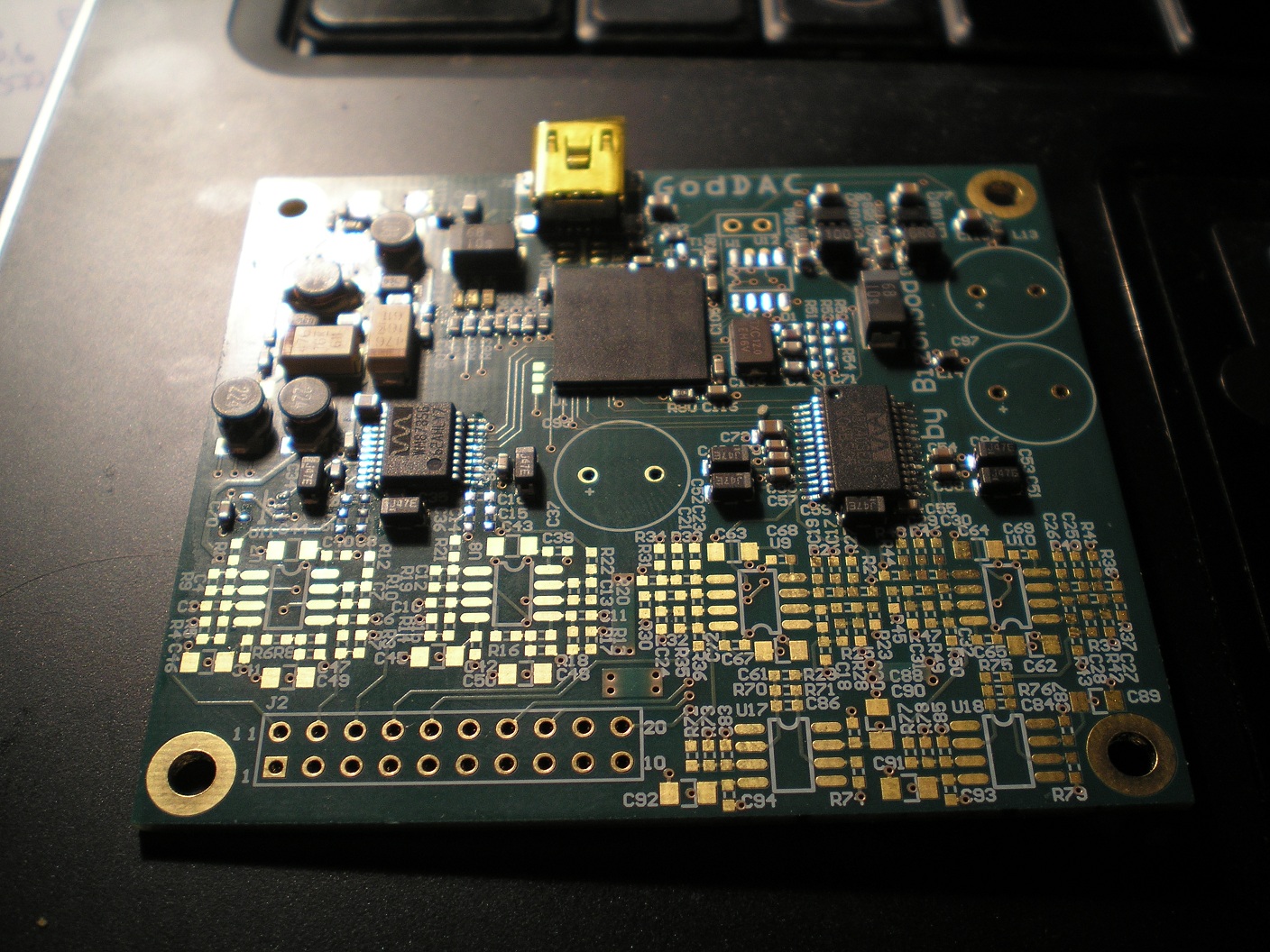

This is a very interesting project ! I actually wanted to do something similar but it seems that you did most of the work already 🙂
Is this project open source, i.e. are the schematics and PCB layout openly available ?
Another question is about the analog input / output: do you use op. amps. before the ADC / after the DAC ? If so, which op. amps. ?
How many layers has the PCB ?
I'd like to buy one of the assembled boards from you but please do not solder on the op. amps. since I might want to use some others. Can you deliver a board like that ? I mean, can you send the board and the op. amps. in the same packet but the op. amps. not soldered on the board ?

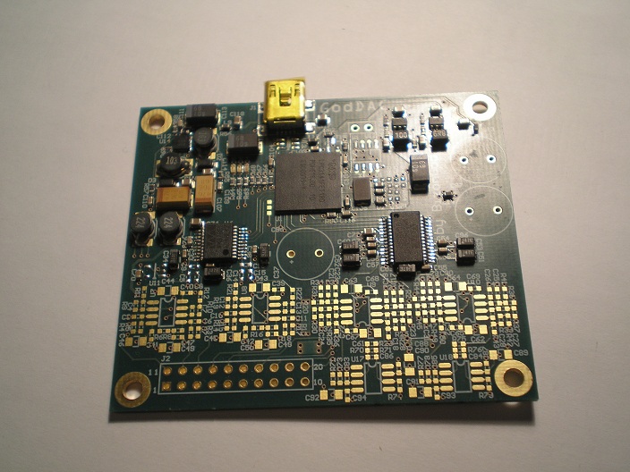

Of course, no problem, You will get one without opAmps 😉
Do I have to solder other components of LPF around DAC/ADC?
Resistors and caps are 0603 size, tantalum decoupling caps are
A size, of course there are no ceramic/tantalum/electrolytic caps in
audio path.
For all 8 pcs I ordered 24 pcs of OPA2134 and 8 pcs MC33078
for dual opAmp (each device needs 4 pcs) and 6 pcs of LME49710 of
single opAmp (each device needs 2 pcs).

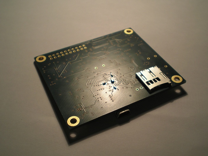

PCB is four layer mainly due to BGA package of CPU, also ground and power
planes are separated into analog and digital parts. Of course PCB is gold plated 😉
I have plans to make it open source (code, schematics, gerber files for PCB),
but I need confirmation from programmers that they will take part in software.

I'm very much interested! Your project sounds very like it's an incredible tool. Do the USB and audio circuitry share grounds of can an isolation transformer (for digital stream) be used?
That would be hard to realize. I2S MCLK is high as 24.576MHz, so it would be not easy
to transport. According DAC/ADC datasheet grounds are separated and connected just in
one place (by small ferrite).

Board is powered by USB. OpAms by DCDC converter with CLC filter including
tantalum caps and large FC series electrolytic one. Every one chip on board is
well decoupled (each power pin of analog part has own 100n + 10uF or 47uF).
Of course, you can bypass DCDC and take power for analog part from external power
supply (-+10V, +5V)

Today opAmps arrived (except LME49710 - will be in week or 2)
Soon I will solder them, and make new photo.
