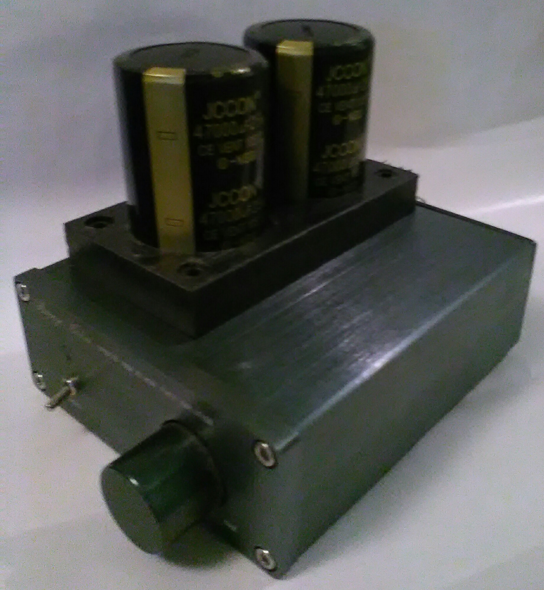

I made my own clamp out of some plastic ( odd stuff, smells fishy when drilled/cut ), but that was mainly because of the external mounting. There is a slot between the two caps, that is closed by a bolt to clamp them. There was a thread on diyaudio about gluing caps, and someone said that hot melt glue absorbs water and it separates the glue from non porous surfaces.
