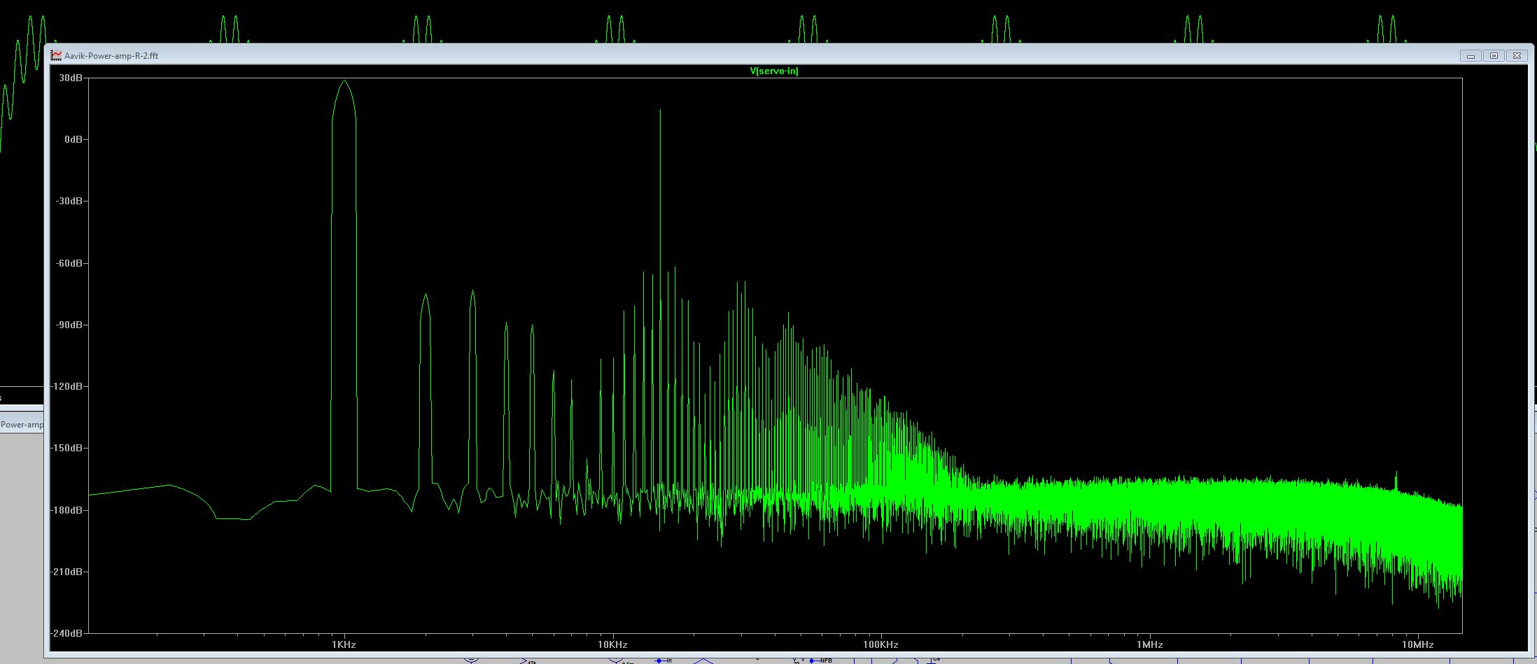

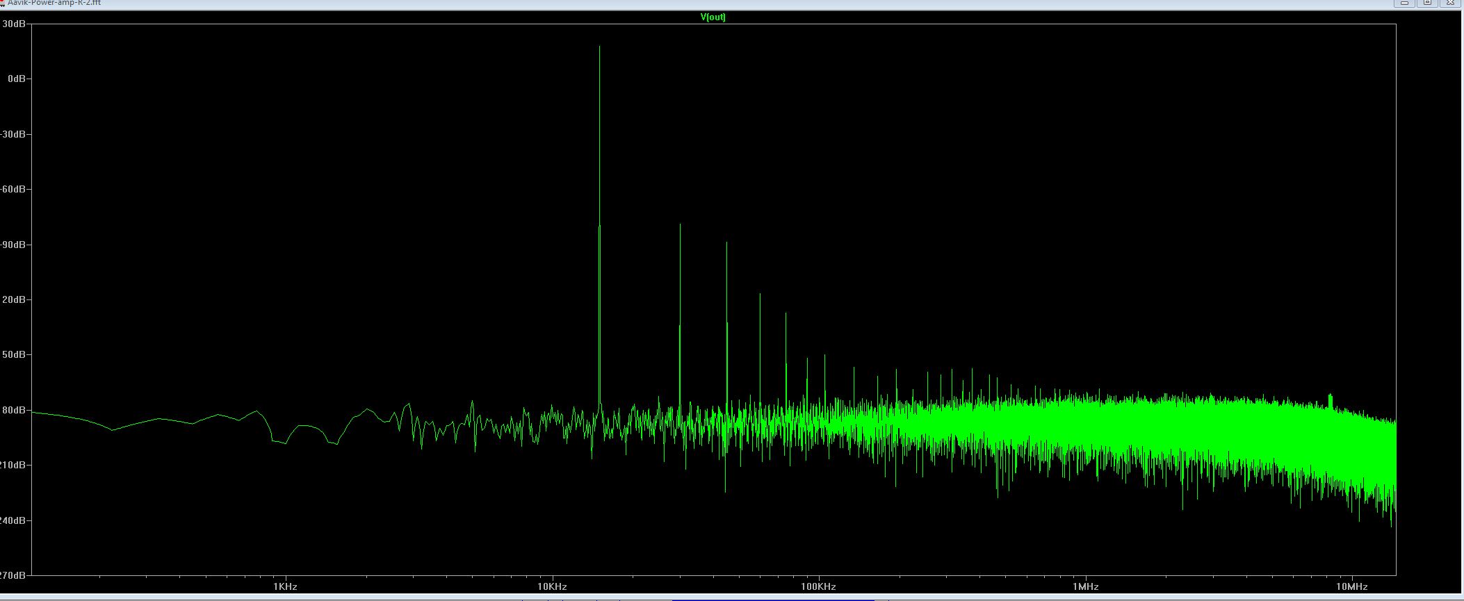

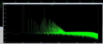

I really do look at all stability issues, and look at square-wave ringing and potential parasitic oscillation.
When testing I use the same output stage and PSU, then I can change input-stage (on a pin-header) and isolate any performance issues to that only.
When I started looking at CFA's I really wanted CFA to be the best, but IRL has show a different result. No doubt CFA's show the best results when you look a single tone distortions, but when a smaller higher frequency signal rides on a larger lower frequency signal you run into something problematic. I believe this is because CFA are not very pure, they mix voltage and current, so you also get voltage modulations where ideally it should only have been current modulations.
