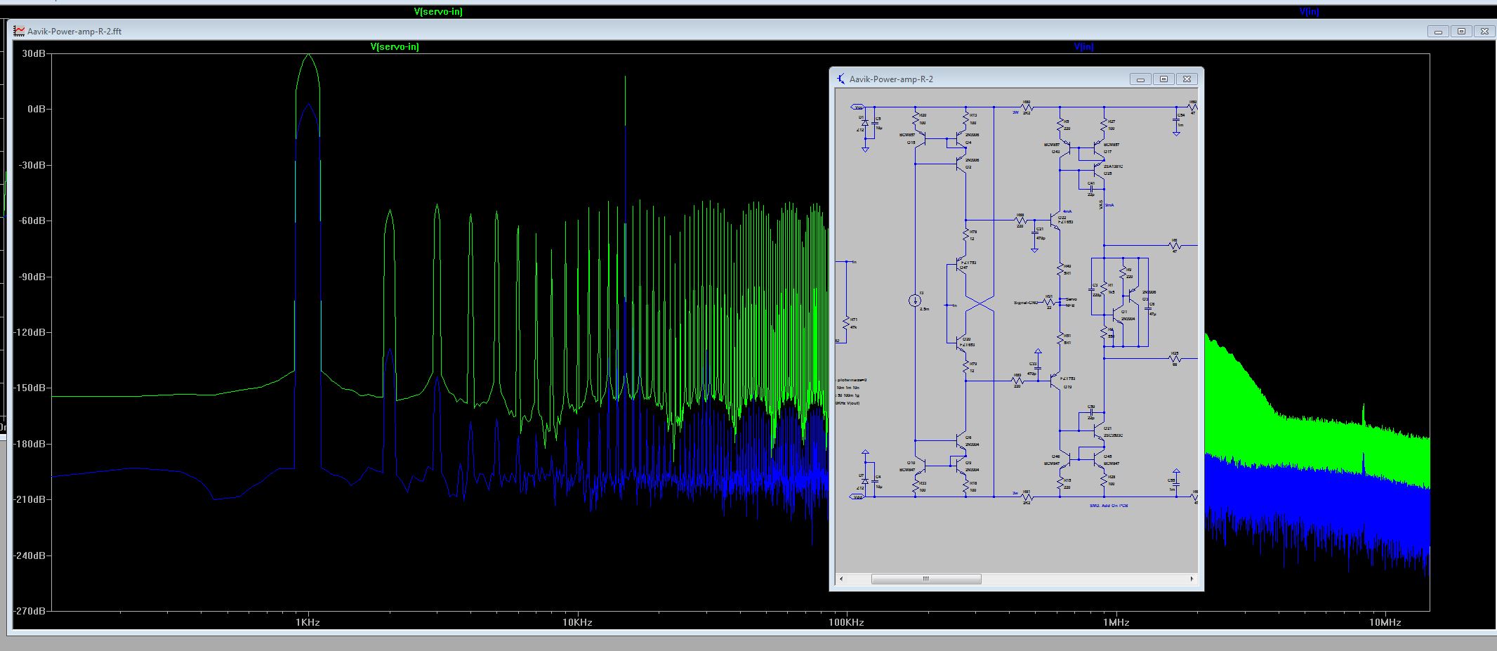

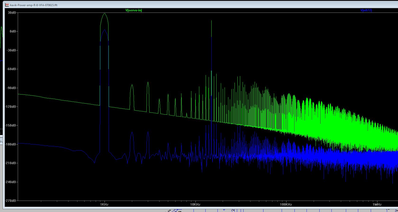

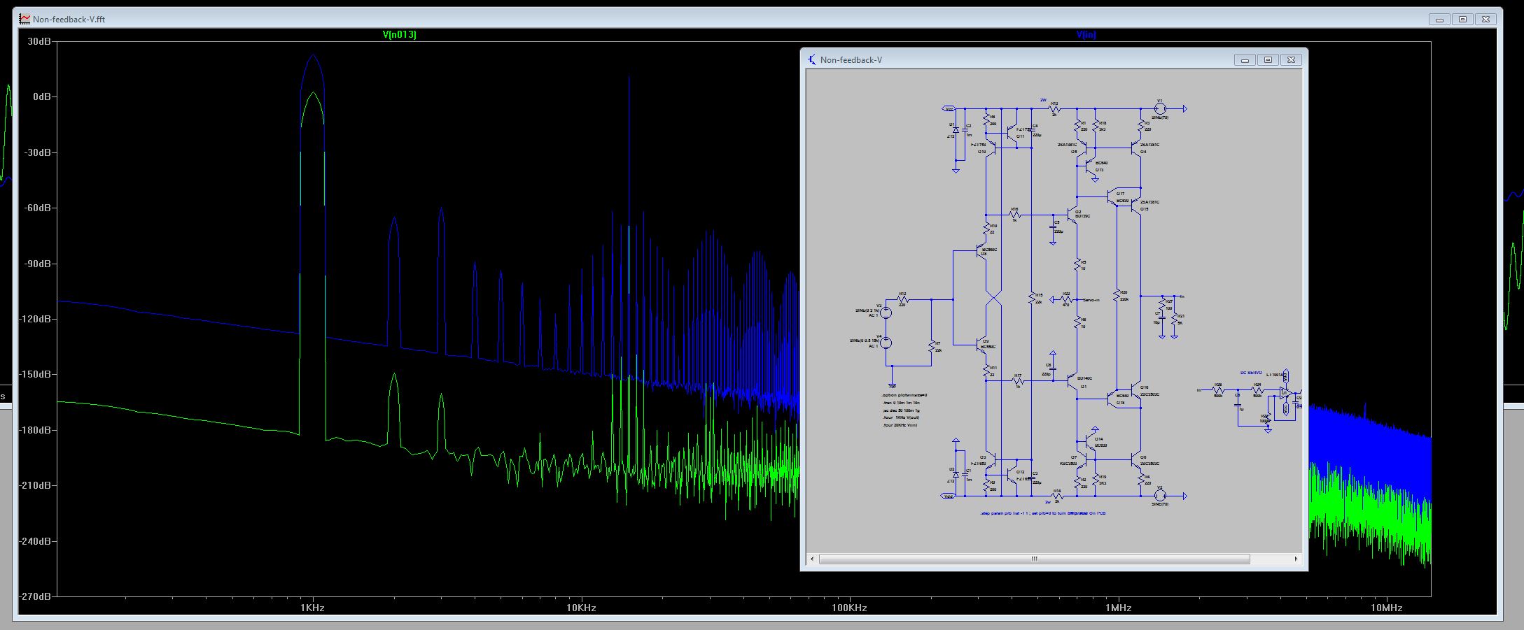

This may be of interest. Voltage gain-stage that has no global feedback loop also produces IMD... CFA's produce a lot. maybe this is why they sound thin and brittle to me, lacking warm slam that at least to me is a must in a good amplifier.
1Khz@2V and 0.5V@15 KHz driving signal.

I really like the sound of a Current Feedback gain stage, similar to a folded cascode but better to myself. There are ways around the brittle sound you refer to, and can be made to sound ballsier than a VFA, the topology and dimensioning makes a difference. I find them unmatched in the presentation of highs and as long as you take care of any potential ringing they can sound just beautiful.
