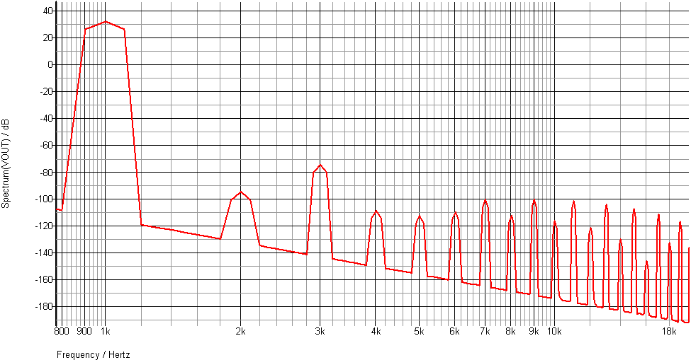

When I put the VAS loading jumper in,my can see the 2nd harmonic do down and the THDcreading also goes down.
If someone is designing for single or sub single digit PPM, it is useful to remember.
28 to 20 ppm is about a 25 % reduction in distortion. That's significant.
This is what i got simulating your e-Amp, are the numbers correlating with your measurements?
Output level is 40V Pk.
