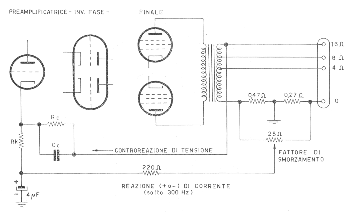

You are correct that one amp does not make 'a transition' but the Fisher was by no means the only line of amps at the time that employed that kind of 'damping' control. At the time the industry was struggling with the lack of a standard- on the one hand you had amps with damping controls, some with feedback and some with none. OTOH you had speakers that had level controls on their drivers for the same reason. By the end of the 1950s voltage feedback was taking over although even at the time (if you read Norman Crowhurst) it was understood that it was not the perfect solution either.
BTW if a tube amp has a lot of feedback it will have a low output impedance that will be a fraction of an ohm; that is how it can behave as a voltage source even though its all-tube.
Something you may find interesting is the definition of output impedance, which is different with the voltage rules as opposed to the power rules. With the voltage rules the output impedance is often a measure of the servo feedback of the feedback loop in many cases; IOW how much the amp actively reacts to the load (which it can do also do to a lesser degree without feedback though Ohm's law). In the power paradigm the output impedance is the actual impedance of the output section. These are two very different numbers!

I believe that Fischer 55A use very similar basic principles showed in this basic schematic ,
where amp operator can manually to adjust 25R potentiometer and to select ratio between two different Global-FB loops , CFB/VFB ratio , regulating in that way relative level of damping factor , or amplifier output Z .

Yes- it was voltage and current feedback on the same control. Current feedback increases output impedance; voltage feedback decreases it. In the middle the two cancel as if there is no feedback at all.
Thus the control was marked 'constant voltage', 'constant power' (at the noon position) and 'constant current' fully clockwise.
