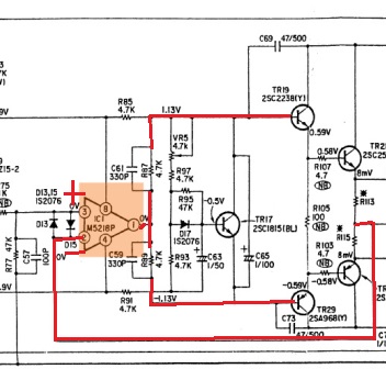

Can you see the feedback network inbetween the LTP and the Q11/13 output stage of the voltage gain section of the amp ?
I see tone controls circuit there. (This was commercial product) It would be much simpler if you would just tell that this amp is not what Denon claims it to be. If so, tell me that Denon lied.
Variable feedback.
(if the voltage on the amp output node exceeds the output at the connection of Q11/13 by more than a diode drop, there's a feedback path from amp output to input stage. Part-time global negative feedback)
So, with tone controls circuit disengaged in normal operation, would you say that this circuit has global NFB and how much of it? When does this circuit become global NFB circuit? In practice, is there an fixed value of circuit parameters when it becomes ordinary global NFB circuit? When will such condition appear, at high volumes, when some tone control freak ODs with tone controls usage, etc?
No this is only a local feedback loop. This loop do not include the output transistors.
But the output stage has its on feedback loop from the output into inverting input of a M5218 opamp.

-First GNFB loop is closed around entire input/VAS/predriver/variable tone control stage , automatically that Denon amp is not GNFB free amp.
-I have no internal schematic of M5218P OP-amp , but I believe that OP-amp not serve only as DC-servo but as OPS error correction circuit too , which I count as second GNFB loop .

Unity gain, non-inverting, power buffer. D13, D15 are protections against exceeding the max differential input voltage.
The preamp has NFB through the tone control, and is providing the overall gain. As such, there is no global network feedback, but two stages (preamp+unity gain power buffer) each with it's NFB loop.
IMO this amp was designed only to satisfy a marketing gimmick request. I can't see anything special in this configuration, compared to a regular amp.
Some people like to define anything less than global feedback as not really being feedback. They also define global feedback as being from output point to input point - anything less is not global feedback and so not feedback. Hence an amp with lots of feedback can be described as free from feedback. This is strange, because the theoretically most excellent form of feedback is global feedback - anything in the output which is not in the input gets reduced. Anything else does less than this. In most cases the feedback is taken from somewhere just short of the output point (e.g. just before the Zobel network and output inductor) and fed back to something other than the input point (e.g. the other LTP input) - so some might say this is not global feedback and hence not really feedback. All this is just playing with words, because feedback is feedback however you do it.
The preamp has NFB through the tone control, and is providing the overall gain. As such, there is no global network feedback, but two stages (preamp+unity gain power buffer) each with its NFB loop.
Concur. Really two separate sections, each with substantial overall FB.
But why compare the output to a signal that is 28 dB lower, would it not be more efficient to compare to an equal size signal like in a gain of one OPS, then all the open loop gain can be used for feedback.

As suggested the overall topology may have been part of a marketing ploy. Probably the pitch was along the lines of no GNF and a nearly perfect output voltage follower.
As usual, given the same bill of materials, one looks for ways to do better.
Also, if the result is truly sensitive to loading enough to make everyday cables an issue, however doubtful that is given the L-R isolating output network, there may be so much loop gain in the output section already that it could be classified as a marginal design. One could go further to investigate if the characteristics of the op amp (or whatever is in the little triangle) were known. I haven't searched to see if that part is described anywhere.
The somewhat-similar approach of driving output and driver devices via the power supply terminals has been used a fair amount. It suffers from the effect of uncertainty in the op amp quiescent current drastically affecting the output devices' bias when the output stage is common-emitter (PNP emitters to V+, NPN to V-). Op amps usually have rather broad specs on Iq, even if they are there to satisfy the six sigma QA people. It can appeal as the output swing can go to the rails, almost---but saturate them in doing so and you are in a world of hurt from storage time. By the time one makes all of that work one looks back at the emitter followers and may realize that they are not so bad after all.
Datasheet for the op amp here: Mitsubishi Electric Corporation - datasheet pdfOne could go further to investigate if the characteristics of the op amp (or whatever is in the little triangle) were known. I haven't searched to see if that part is described anywhere.
