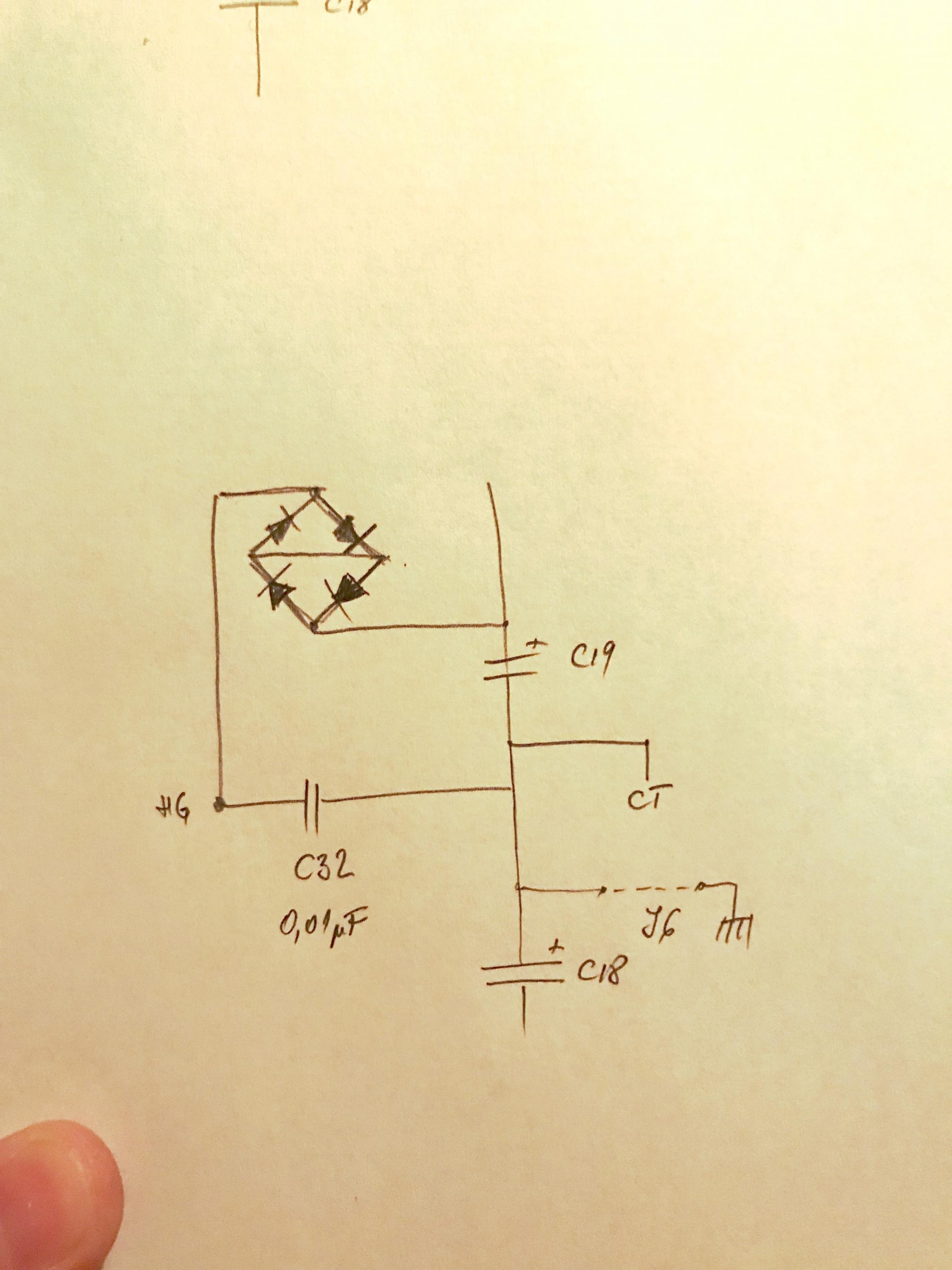

As the title says, I've got a wee hum problem with an ACF-2 tube buffer I've just built, using 6SN7 tubes. Bloody things sounds really nice but the hum is killing me (what has been heard cannot be unheard).
First, I thought this was a ground loop (or an earthing issue). However, I looked at it from all angles and I don't see any loops. The chassis is tied to mains earth right at the input. The board is connected to the chassis from the house ground pad, through a little board I made myself, that has a power 10-ohm resistor and a small cap in parallel, together with 4 diodes in parallel as well (pairs of two). I've tried disconnecting the board from the chassis (leaving the chassis tied to earth), without any success.
The input/output jacks are isolated from the chassis (verified this with my multimeter) and signal grounds are paralleled all the way to the board. I have shielded part of the signal wires, but the shield is connected to signal ground only at one end.
From this, I started to suspect this is heater hum. I've measured it to be "exactly" 50Hz and I also noticed the hum goes away almost instantly after I cut power to the unit (however, some 30s after that, the power amps start to hum terribly loud - not particularly a problem as I never use them like that).
My mains transformer is a Hammond 369AX, which has a 6.3VAC secondary. It's currently wired in the Full-Wave Bridge configuration and I'm thinking the regulator doesn't have enough input voltage to output properly filtered DC, hence the noise. I am considering reworking this into the Voltage Doubler config, while keeping the reg output at 6.3V. It should dissipate a lot more voltage, but I would assume the DC should but much cleaner.
In any case, I would appreciate your input and opinions. Also, if required, I can provide some pics tomorrow

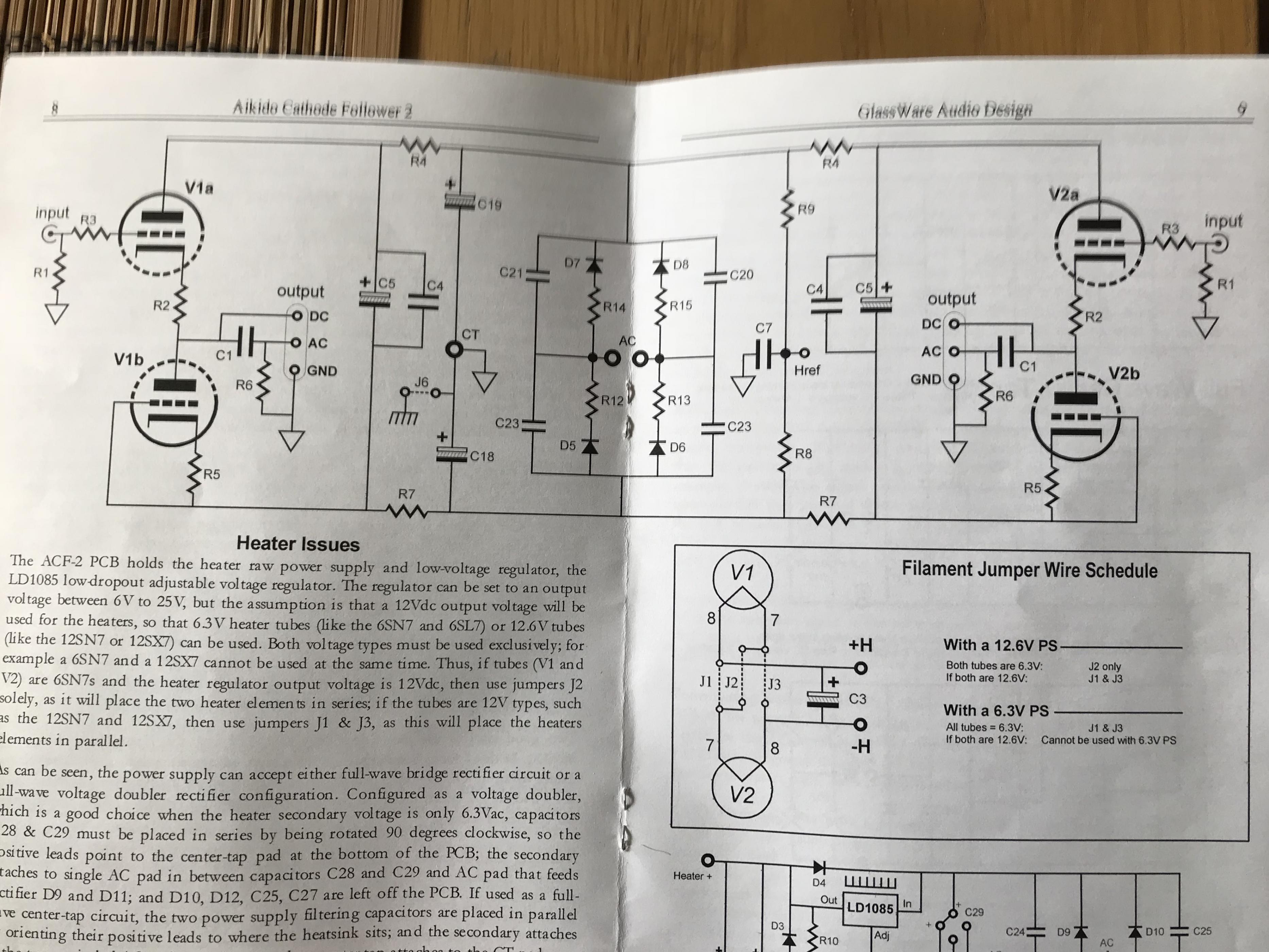

Is the 6.3VAC tied to 1/4 of the high voltage? I have had many aikido configurations including the 6SN7-6SN7 version without any hum using voltage dividing resistors from HV to ground.
The schematic and the manual show the heater ground to be referenced to half of B-. I would assume that’s all fine, considering I’ve built it from a kit. Will have a look at the voltage divider resistors just to be sure.

Yes, that’s what I built (the first schematic, with a slight difference, as the two sets of diodes are completely in paralel, not connected halfway). In any case, I tried disconnecting this, essentially doing a ground lift, without any audible difference.

I’m still thinking about the heater DC filtering. If input is 6.3VAC, then raw DC should be 6,9V which seems kind of low, even for an LD reg. I can’t remember the filter cap values, but I have a strong feeling they’re 2200uF. I’ll check them tomorrow and do the math to see what ripple voltage I get. I have a very strong feeling this is where the hum is coming from.

In the process of repairing it, I did notice some issues, due to the fact that the schematic is different from the actual board. If you look at the schematic in the manual, you'll notice there's the J6 jumper that connects it to house ground. However, looking at the board, I noticed there's an extra bridge rectifier (integrated, not discrete like the power supply ones) and a capacitor that weren't mentioned on the schematic. I tried to draw a new schematic, detailing what I saw on the board (you'll see that one attached as well).
From what I gather, the bridge rectifier and the cap seem to do the same job as the filter I built between the board and house ground. Therefore, I think I'll connect J6 and remove my filter. If my logic is correct, this should do the job and maybe I'll get rid of the noise (or get rid of an extra wire through the enclosure, at least)

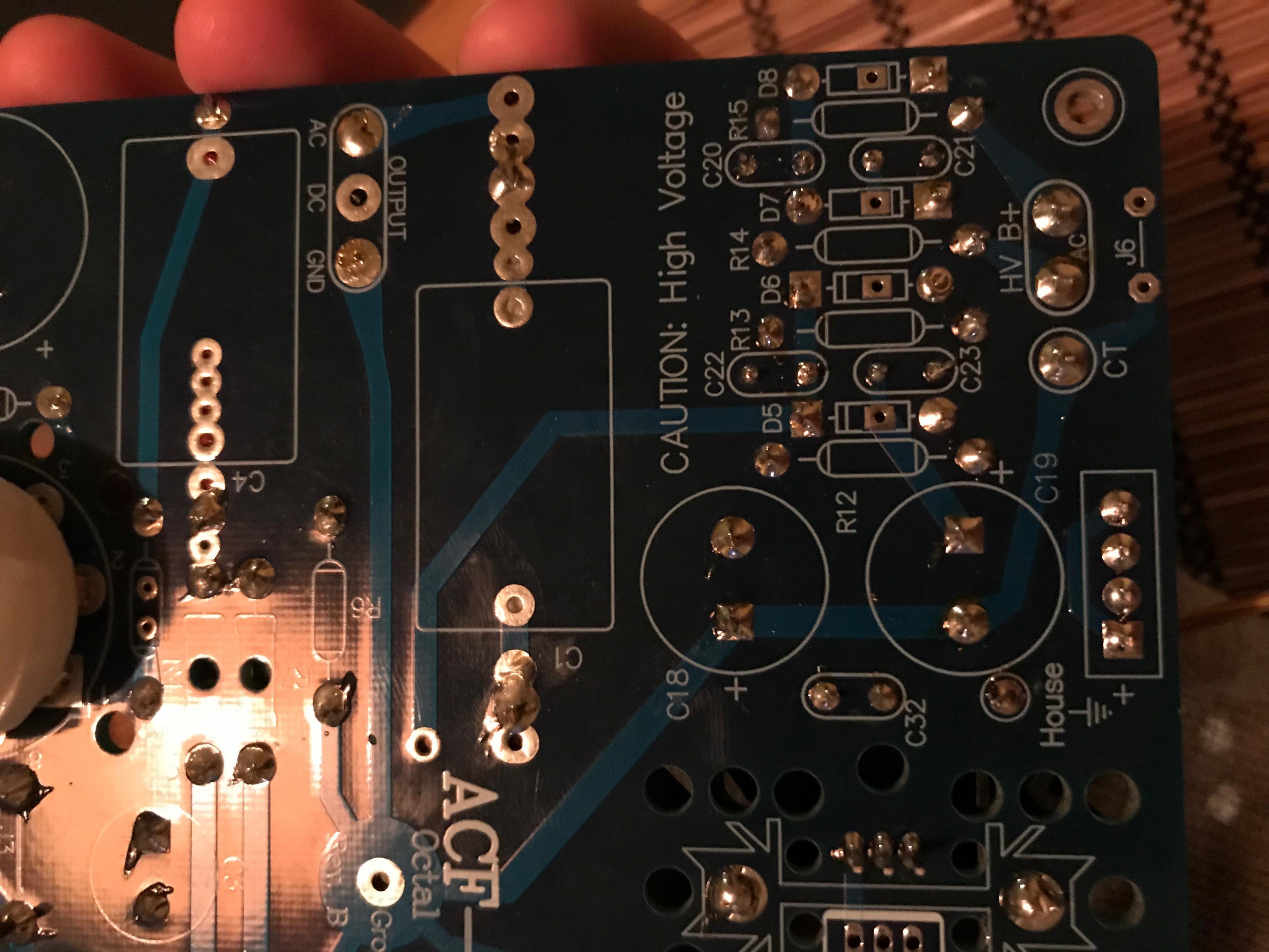

So, updates available. I've tried the following things.
1. Assumed heater DC is not "raised" correctly. Removed C7 from the board... massive hum. Put back C7, but removed the voltage divider made by R8/R9... same low hum.
2. Assumed heater DC is not correctly regulated. It wasn't. Reg input was 6.9V, much lower than the min 7.5V needed for regulation. Changed the heater supply config to the voltage doubler one, set the reg to output 12.6V and put the heaters in series (6.3V tubes). Did it fix the hum? No. But now the tubes glow stronger and have the proper voltage (measured it). In the meantime, changed C3 from 3300uF to 4700uF... no effect.
3. Bit the bullet and removed the trafo from the enclosure top. Put in some longer wires and connected it back. And guess what... still no change. I have tried moving the wires around to see if some EM field is causing this, but without any success. No matter what I do, the hum is constant in volume and frequency,
However, I did notice there is a mechanical hum coming from the board (without any power amps connected). This is at the same 50Hz frequency. Disconnecting the B supply stops the hum, but doing some makes the power amps buzz, just as if the cable was connected to them but not the other way around (same happens if I power down the Aikido but leave the power amps running).
Also, there's something I don't understand. The design says the heater DC must be raised to a sufficient voltage so both the top and the bottom triodes "see" the same magnitude of heater to cathode voltage. This is done by the voltage divider I mentioned at the first point, between B+ and B- (having a bipolar supply). What I don't understand however is why the top resistor in the divider (R9) is of higher value than the bottom resistor (R8). This sets the ref voltage at -50V to ground and it would seem to me that it should've been the other way around.
