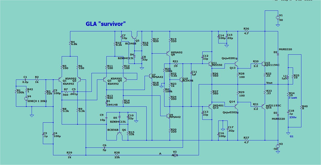

GLA (good little amp) "survivor"
Here is the latest creation (re-creation 😀) from the "badger hole" :drink:.
- A really stable triple OPS - I've swapped outputs , hooked up without a zoble ...
all the abuse.
- This amp is 32 years old and I'm still abusing it daily (just needed a re-cap).
-My LT simulation worked first time , needed to tweak the unconventional compensation scheme - it never exhibited any instability even without the "tweak" .
- Since I actually own the real live amp (and listen to it a lot) , I was able to
compare LT's output to the real world operating points - 99% accurate.
Below are the "goods"
The schematic and the .ASC (spice file)
PS - the PCB is next , I REALLY like this little amp. (try to guess who designed it ? )

Looks like a good solid performer from the schematic. All those LTP's - could include a balanced input option ?

The circuit - I've found that by loading the VAS (R25 -47K) you can control
the H2 / H3 balance in the Fourier results. 22k gives H2 dominant at the
expense of total THD. 33K seems to be the sweet spot , at least for these models.
The real amp uses 2sa992 /2sc1845 almost exclusively , 50VDC rails.
The longevity of this circuit is amazing .... found it in the college of Saint Rose dumpster
( many beer- soaked "enhancements" of "higher education" :drink:).
It worked at lower volumes even with dry electrolytics -amazing.
The compensation is "weird" . I know C17 (lead comp.) and it's effect/purpose.
I'm curious about R7 /C5. I don't know what this network is called , but it greatly contributes to this amps stability.

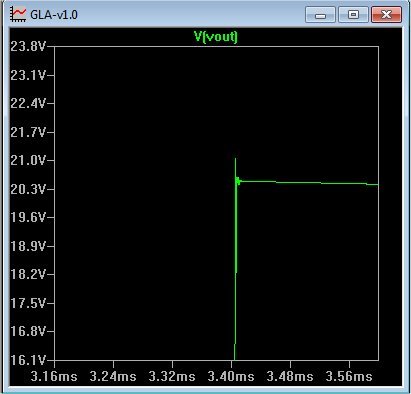

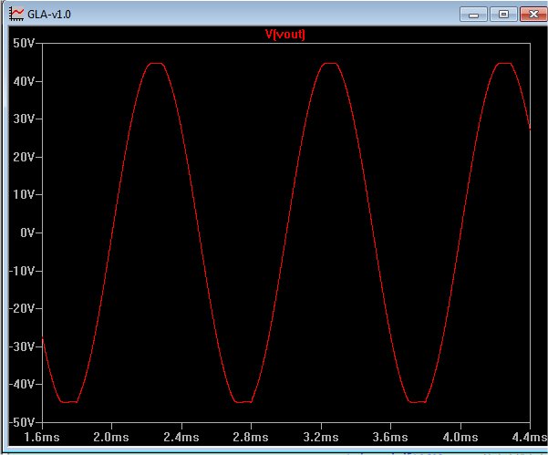

Attachment 1 shows the clipping behavior. At least it is symmetrical , but
shows a small amount of "sticking" . The edges are rounded , not as bad as
"blameless" clipping.
Attachment 2 is driving a capacitive load. I had to really coax this amp to
give me a damped ringing response. Bridged the OP inductor , lowered the
load resistor. VERY stable ... I've not simulated too many like this.
All this is reflected in the real amp , 32 years with original semi's is a pretty good track record .....
This must become a project !

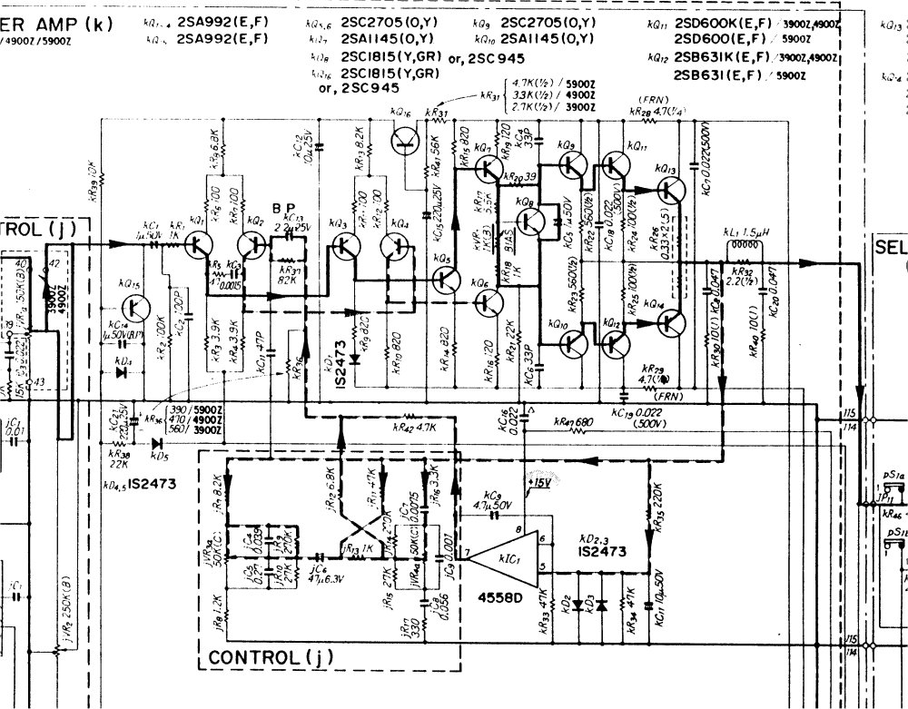

Here is the "truth" 🙂.
Attachment 1 is the amp section. The input stages (I tested them) are run by
a +/- 18VDC supply. It is strange they regulate the positive 18v from the amps main
V+ rail and derive just the negative 18V for Q1-2 from an auxiliary supply.
I might "clean up" the differential supplies and create two zener regulated
ones instead , it will make for a "standalone amp".
This is really a Sansui Z3900 , the PDF is too big.
You will notice the Sansui had a DC servo - I changed this into it's passive
equivalent.

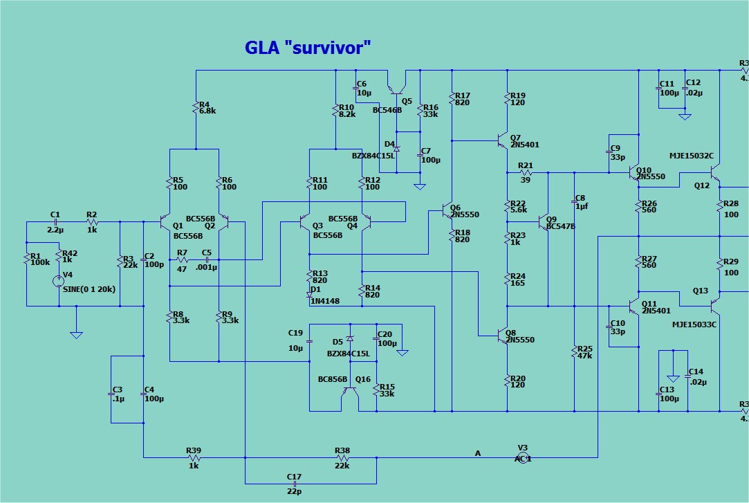

OMG -Q7 and 11
But it actually simulated right - 😕
I fixed this - and wow ! .001% 20k.
- Tiny glitch in the stages is gone , and the loop gain is "more normal"
(typical) 500k UG with 80+ margin....
-Q1-2 nearly superimpose (balanced)
-Q1-2 are 1ma , Q2-3 are 2ma , the VAS is 3ma.
The actual amp measures real close to this.
This is almost ready to FLY! (pcb)
PS- this amp's topology was actually able to compensate for 2 swapped E-C's !

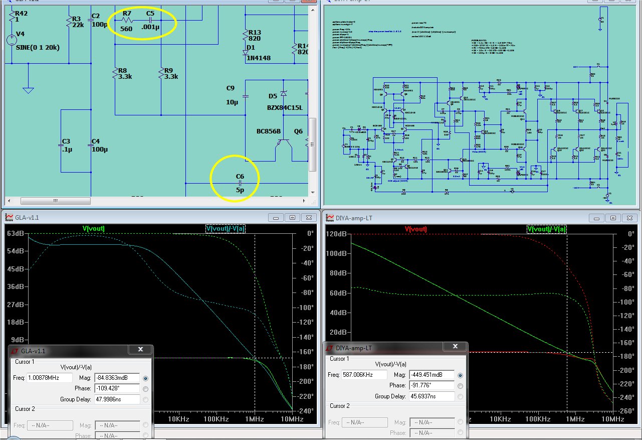

Solved the compensation issue. Standard miller comp. with a B-C capacitor
won't work with this amp !
Phase compensation -(R7/C5) of the first differential plus a little lead compensation from the VAS (R6) let's you "shape" the phase margin and unity gain point of the amplifier response curve. Harder ! , but a more elegant
approach. Original "vintage" (47R and .0022uf) values still gave a stable amp.
(below attachment)... this amp is compared to the standard "blameless".
Latest .ASC below - (with the "vintage" parts modeled) the performance came out real close to the OEM specs - but just a little better.

GLAv1.2 (final)
All is wonderful ... 🙂
V1.2 is SO close to the Sansui 3900 , both in compensation and actual voltages.
(Attachment 1) is the final work.
My tweaks to C6 (lead comp.) and the "lag" comp. (R7/C5) are within range
of the original specs.
The simulation also allows for higher Hfe Zetex devices , 2n5401's , 2sa992's
or any other to-92 device for Q1-4.
Any to-220 (mje15032/33 , 2sa1837/2sc4793) as driver , and any OP device
..including the low gain/low Ft mjl21193/4... work very well with this amp.
R25 and 26 load the VAS , which gives a monotonically decaying harmonic
output.
The differentials and VAS are at such low current (no heatsinks),

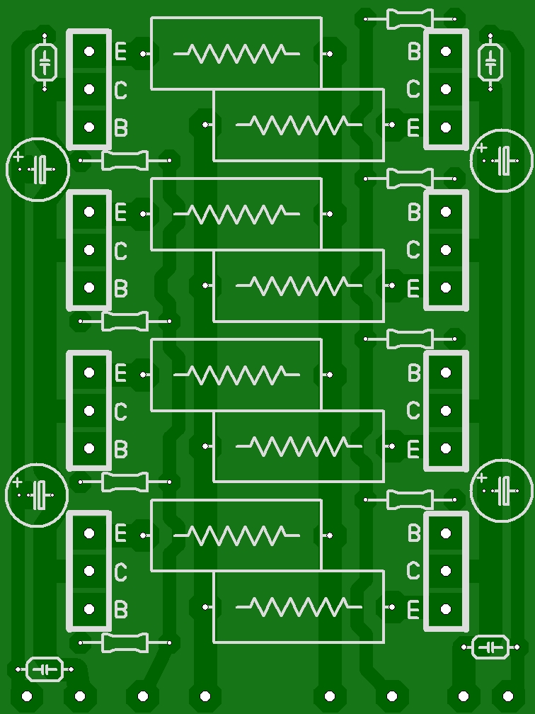

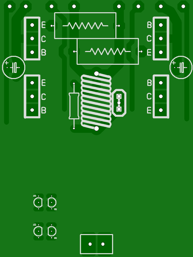

I can squeeze this into a 76 X 102 mm board for the 70W version (attachment 2).
The main board will use njw TO-3P's as drivers !!
For those who want the "Frankenstein" version , attach the "GLAeX" PCB
(attachment 3).Run your 80V rails, you will have a 400W true triple OPS.
Also , the final .ASC is also below.
PCB's + the BOM will be done in the next few days.
