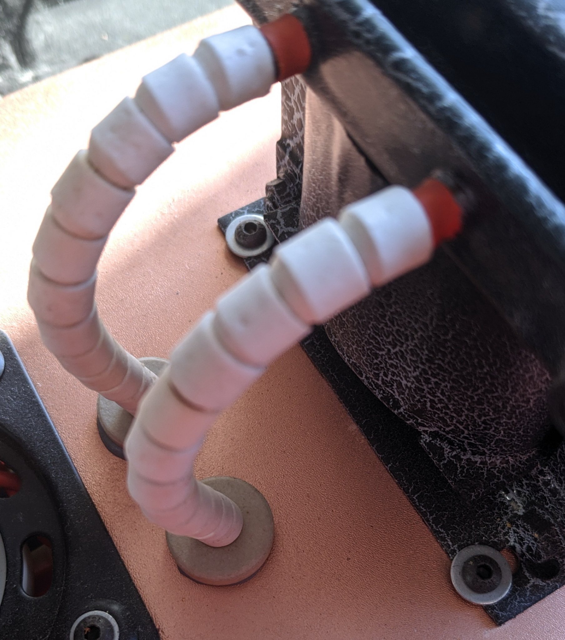

As for the wire isolation against the heated glass top as well as for "through-chassis" ,I use ceramic elements as seen in the pic attached (OK,it's a choke I couldn't cram under but the same policy applies for all the anode cap tubes I work with).

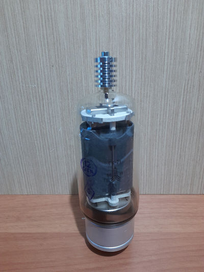

You could take a close look at Wavebourn's build of his GK-71 amplifer . Videos are posted on his YouTube channel. It looks like he might have used some kind of sleeve to go over the pin and then connected wire to that and possibly covered with insulation/heat-shrink.
I don't know a lot about the Russian tubes and their way of doing things but western makes such as Eimac used pins like that where the tube was expected to dissipate a lot of power and the cooling cap needed to keep the metal to glass seal temperature down. If looking to run the GK71 hot, I'd think it not stupid to take that extra step. You could always do what Magz did with his "The Midlife Crisis" amp (posted on this forum) , putting a glass chimney around the tube which together with the right size opening below channels a flow of air around the tube, and made enough taller than the tube with screen above prevents inadvertent contact with the plate cap.

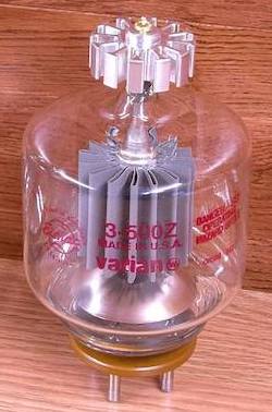

The fellow who used to make the ones pictured here is not doing them anymore but CNC machining is easily accessible these days , and metal printing seems not far behind.
