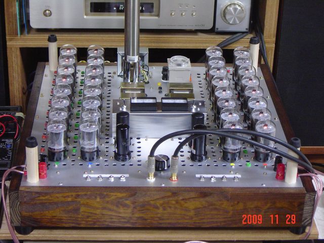

You got it!!
the 12 HeLL 7 amplifier
Maybe should put some Neon bulbs (and series 47K R) across the cathode resistors to indicate tubes that have blown out. Then it will be a redundantly reliable amplifier, you just keep plugging in more tubes as the Neons light up. Well, needs some replaceable fuses, or new film resistors in fuse cartridges, to replace the blown cathode resistors too.

Parallel tube Amps are real. Probably an OTL Amp.
Who needs fireplaces in winter. Maybe they should replace those seasonal fireplace videos (for people without fireplaces) with OTL images. And can you imagine the warm glow (literally) of having an actual OTL amp in ones' home? I can already see myself getting out the marshmellows on a stick. yummm....
Let see, 12 12HL7 per bank, 4 banks for stereo, that's 180 Watts for the heaters. If they were run with low voltage B+, like 75V, that might only be another 2 Watts per tube, so about 300 Watts total heat, for maybe 10 Watts out.
Or running them at full bore, 300V B+, around 7 Watts Pdiss per tube and 3.8 Watts heater per tube, thats about 520 Watts total heat. Yeah, you'll feel the heat from that. But maybe 100 Watts audio output too.
The word boondoggle comes to mind...😀Let see, 12 12HL7 per bank, 4 banks for stereo, that's 180 Watts for the heaters. If they were run with low voltage B+, like 75V, that might only be another 2 Watts per tube, so about 300 Watts total heat, for maybe 10 Watts out.
