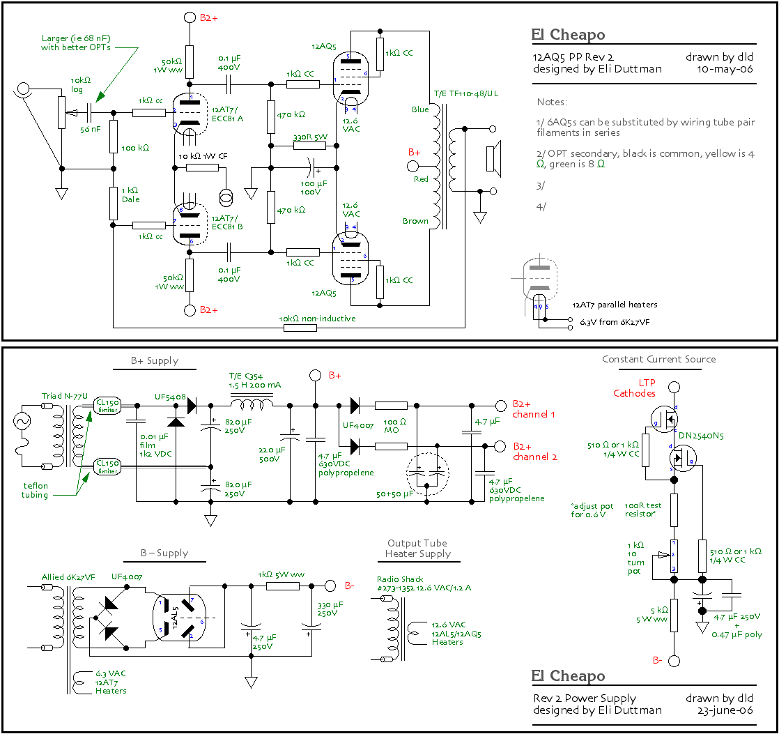

If you are willing to go PP, instead of SE, an inexpensive "El Cheapo" meets your needs. ;)
Any 6V6 family tube will work as "finals", with zero parts value changes. :D As Bulgaria was a Warsaw Pact country, the Russian 6П1П (6p1p) is an obvious possibility.

Eli D's El Cheapo circuit would work with 6P1P outputs (Russian 9-pin version of 6AQ5).

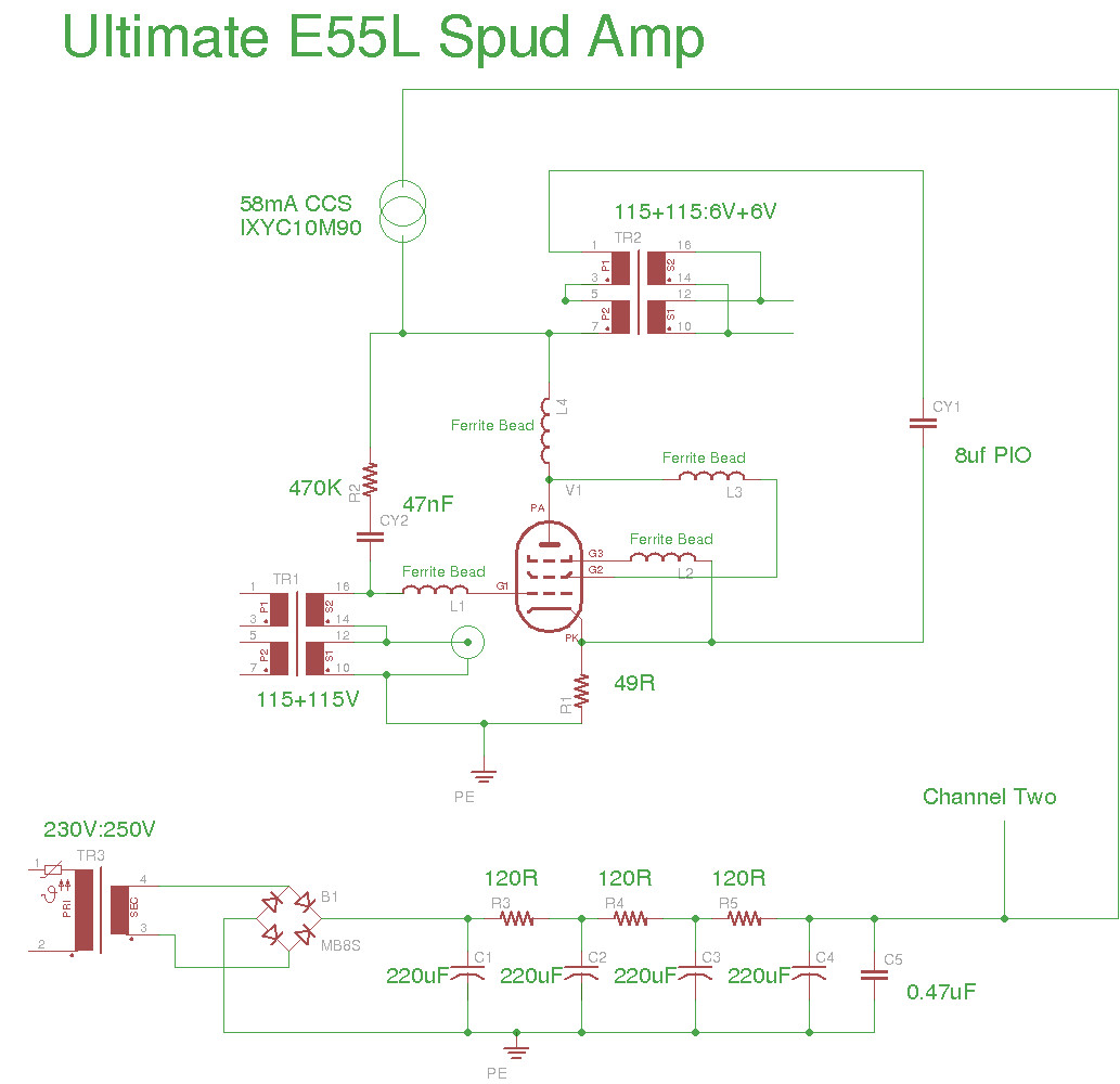

How sensitive are your speakers ?
Try this for size if you can live with a very sweet 3w. The E55L is quite expensive but the toroidal PT used for inputs and outputs only need to be 20VA so are cheap as chips.
(Tune the circuit by substituting a 470K pot for the feedback resistor and dialing in whats best for you, when you find the right value sub in a fixed resistor).
Shoog

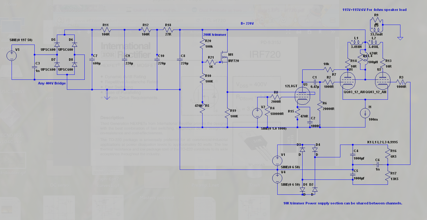

If you need 7w try this for size. Sounds just like a SE amp and uses ultra-cheap Russian tetrodes. the only expensive component is the 12L8GT used in the front end. Makes for a compact 3 valve stereo PP amplifier.
Shoog

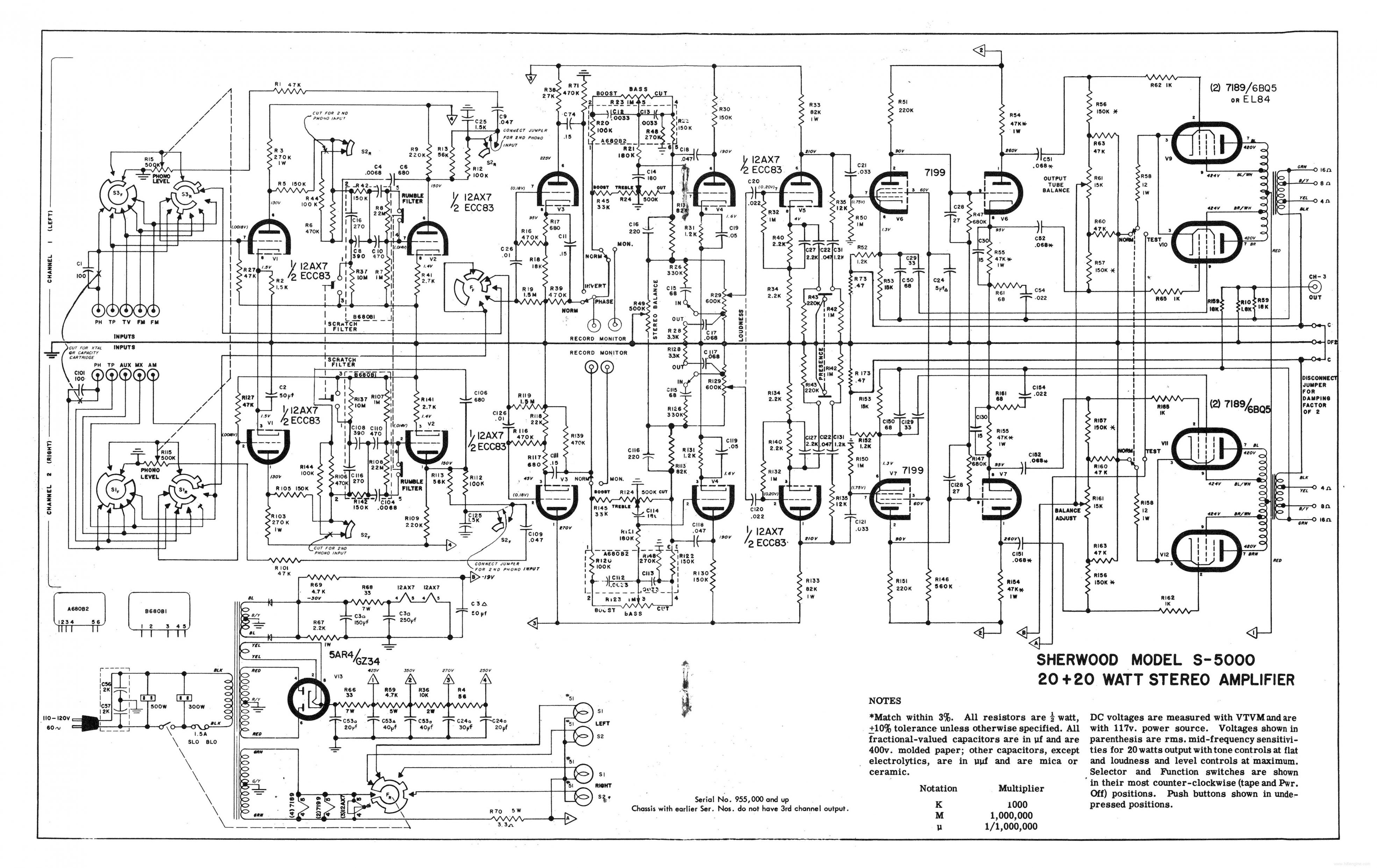

Paul Joppa has provided us with a useful rule of thumb for matching speakers and amps. Joppa's Rule states that in a listening space of "average" volume an amp/speaker combo should be capable of producing 102 dB. SPL at a 1 meter distance. Applying the rule to 91 dB. sensitive speakers yields upwards of 15 WPC, as the power needed.
The Russian 6П14П-ЕВ (6p14p-ev), AKA EL84M, is a genuine 7189 equivalent, with good sonics, that's tougher than old rubber boots. Sherwood, in their S5000, squeezed 20 good sounding W. out of PP 7189s. Something along the lines of the S5000 power section circuitry should do quite nicely.

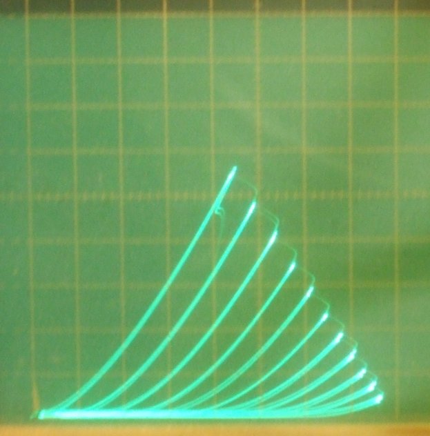

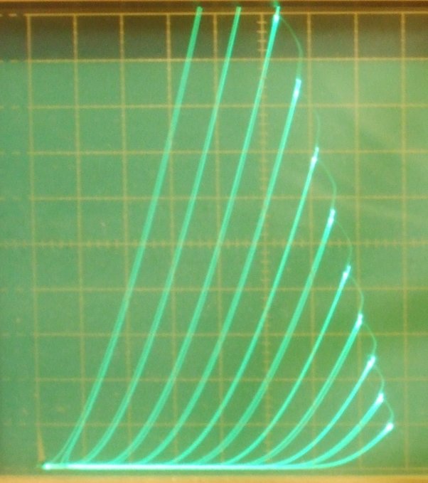

I have never used the GU50 but I am under the impression they are copies of the Telefunken LS50.
http://www.mif.pg.gda.pl/homepages/frank/sheets/043/l/LS50.pdf
On the last page, they show triode connected curves and it doesn't look pretty to me. Anybody out there with a curve tracer take any plots with a GU50 triode connected? I am curious if they look as bad.
