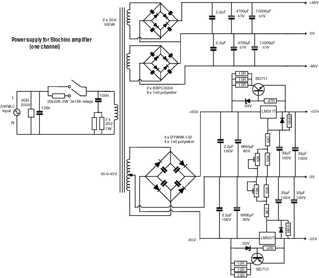

A key point of the discussion was on running off higher rails than the original design. Richard has suitable transformers for +/65v rails
R:I do have some 1kVA transformers - and the power supply design is multiple rail - input/driver stage and output stage. For convenience i will use a single power supply (+/-65volts), which i assume will only restrict the potential voltage rail swings.
G: As you can see in the attached report, I recommend the use of a single dual supply voltage (50V to 60V is ok), but 65V is probably too high and some devices could be forced to work outside their SOA. If you are ready to accept the risk….
Attached is the report, which covers enhancements for improved reliability including removing the seperate supply for the driver stage. These mods were designed to be done on the original board

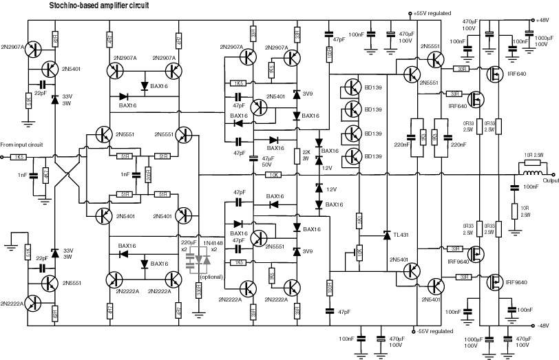

Fast is not as important as low-THD. The THD20 on this amp is entirely unimpressive and THD1 should be much better.
The low-value DC block for the feedback loop is antiquated and contributes to the high-THD.
The gate-spread resistors are too high at 1k3, since these are needed to discharge the gate capacitance of the output mosfets and should be a low value. This is really no different than the base-to-base resistor in an EF2. Attention t this would likely make the amp faster stll.
That was actually my main conceptual objection to the design, and was the reason I set out down the road of trying to reduce the input offset to allow me to remove those electrolytic caps altogether. As Bill has found, I never quite got there...

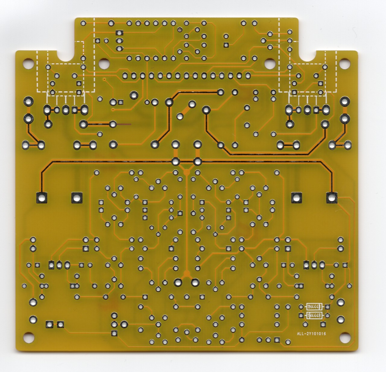

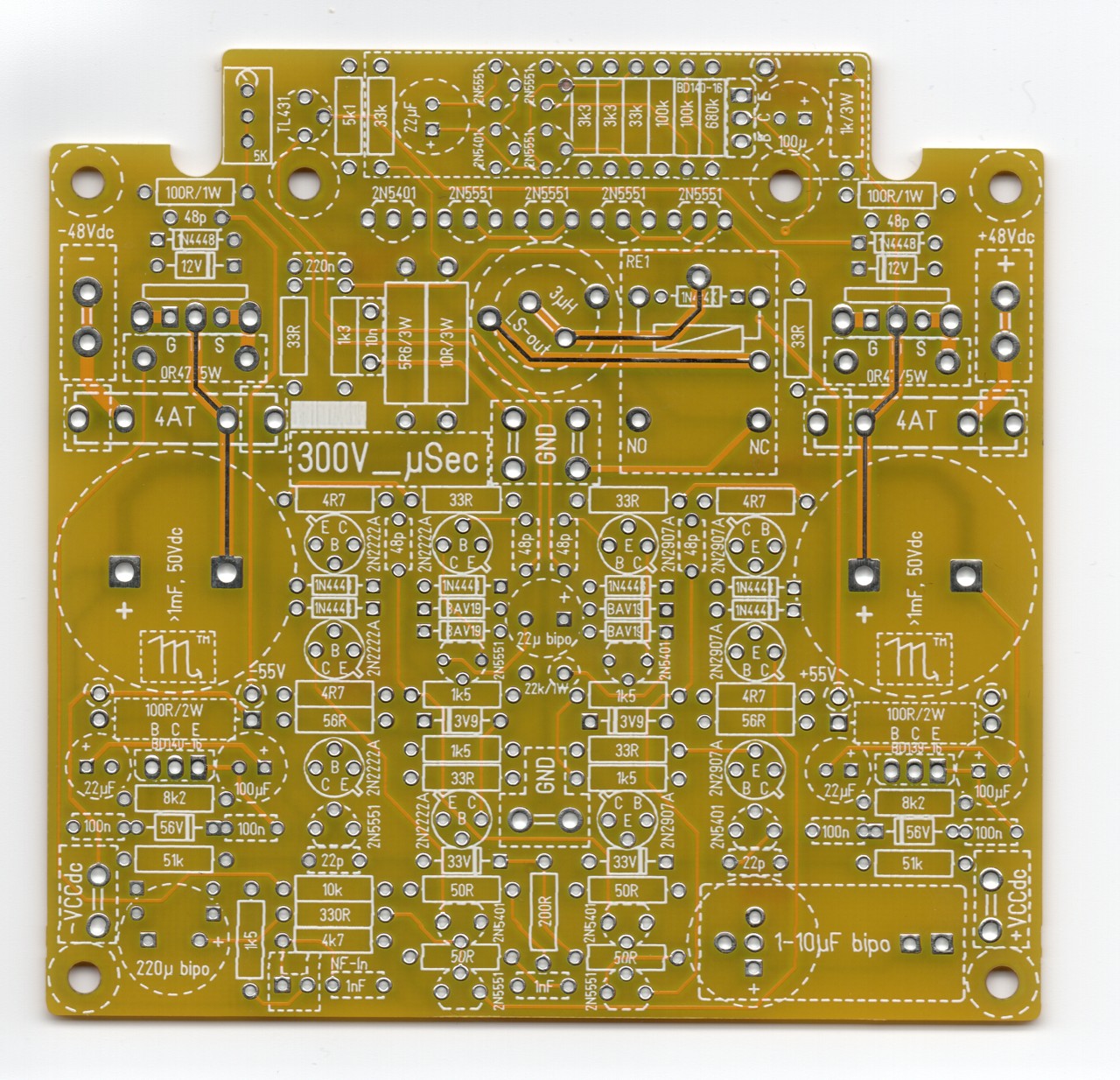

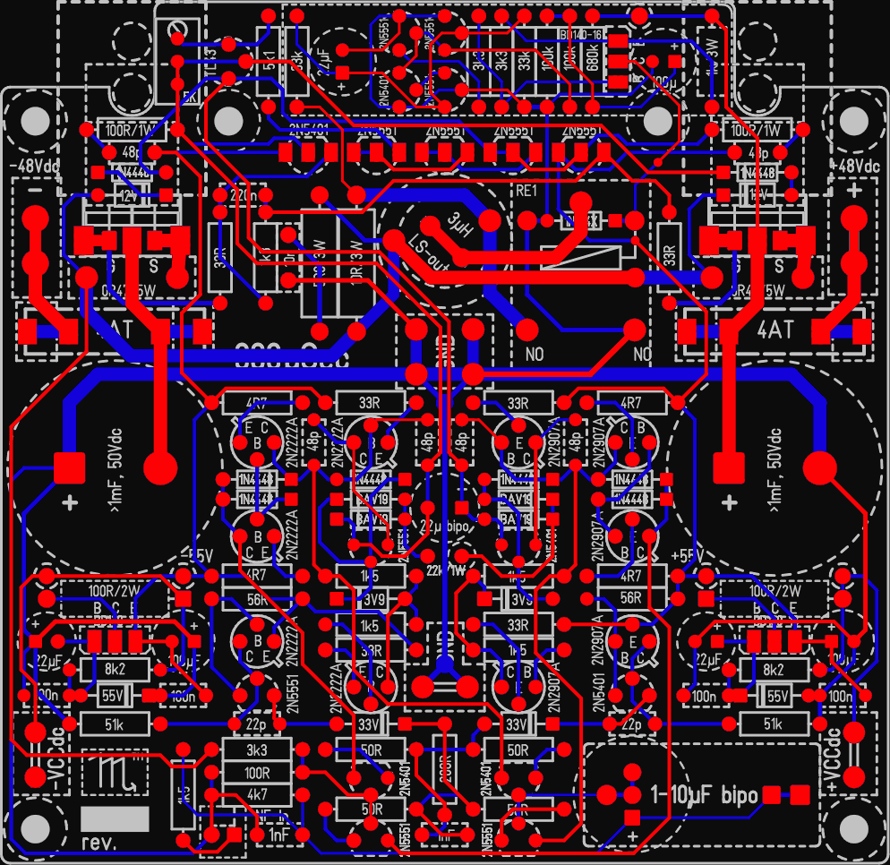

fmmech_24 did you ever complete a Stochino amp with the pcbs in the picture above? What do the 56V zeners do, they're not in the regular schematic.
