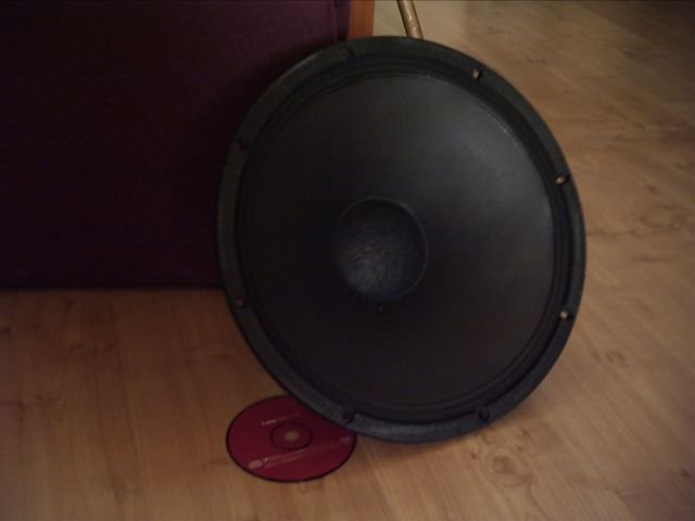

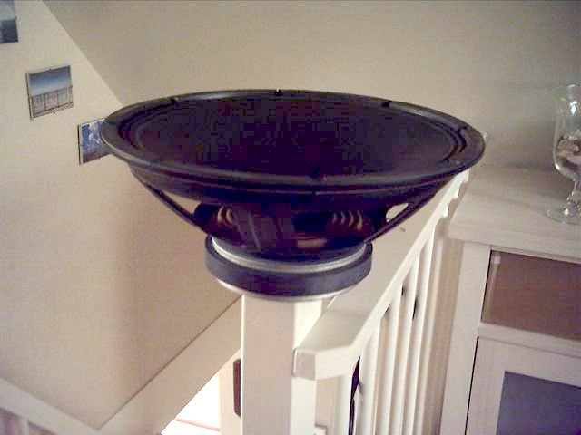

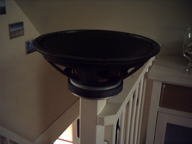

zenmasterbrian said:BenVos,
Might you tell us more about your 32" Clarion?
Is 17hz the published fs?
How did you get it from Clarion, they don't list it.
Rumor has it that such is made by Misubishi. True?
Is the driver's frame rigid enough, won't warp and cause voice coil binding?
May I ask, how much did it cost?
What kind of enclosure do you have it in, sealed, ported, transmission line, other?
Is your enclosure built-in or movable? How big is it? How heavy is it?
How much amp power do you have for it?
The 32”Clarion I have is an SRW 8000.
Te published TSP are Fs: 17Hz/Qts: 0,4/ Vas: 312,9l
Power 1000W 300W continues - 97dB/W/m
I found it in a little PA store in Den Haag. The just used it as decoration.
Normal price is about 2800 euro’s (I paid less)
I do not know if it is made by Misubishi (but my car is)
The driver frame is very strong aluminium cast frame. No problems with it.
My enclosure is just an open baffle like my normal speakers. (I use 6 Db/octave EQ correction starting at 18 Hz.)
I’m driving it with a Denon POA 6600A amp. (260 W at 8 ohm)

Thanks Mike "Mashaffer" for correcting the photograph. I can do this too with Gimp (linux) but i didn't had the time for it.
Btw that woofer i had for free, i saved it from the trashbin, a bad connection to voice coil was the fault, it is repaired now.
