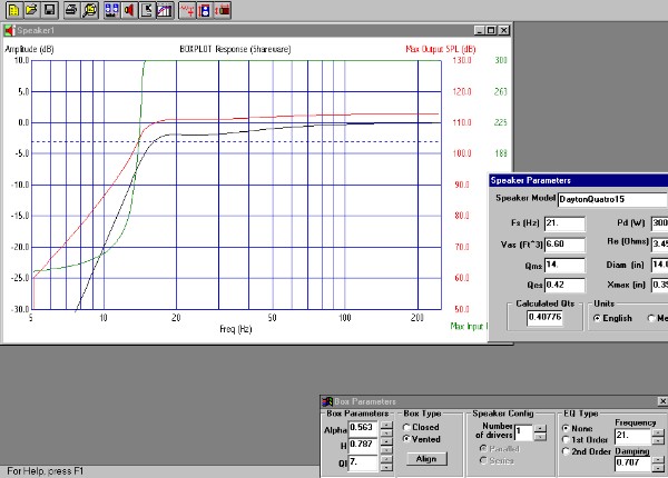

I'm not really operating below Fs the way Bag End does it. My alignment is more of an EBS (Extended Bass Shelf). If you look at the response of a typical EBS system you'll see that it droops a bit, and depending on tuning it will have a flat section before rolling off.
If you went for a QB3 alignment with my drivers, you'd end up with 8 cubic feet tuned to 28 Hz. This would give you an F3 of 35 Hz. My enclosure is 8.5 cubic feet tuned to 24 Hz. Without EQ, this gives pretty close to a 12 dB/octave rolloff from 40 Hz down to 20, with a 24 dB/octave drop below. If the room gain matched theory, no EQ would be required for flat in room response to 20 Hz.
My room has a set of French doors, windows and a large opening to the rest of the house, so I don't get full theoretical room gain. I use an adjustable Q second order 20 Hz high pass filter to compensate for the missing room gain. For Flat anechoic response I'd need 10 db of gain, and would have an F3 of 19 Hz. I ended up with about 5 dB of gain to get flat in room response.
If you look at the response modeled in WinISD you might think I really don't have a subwoofer if you forget about room gain. That is exactly the point - you probably don't need flat anechoic response to meet your goals. Just remember that to apply a lot of EQ down low you'll need drivers with lots of displacement capability.

Which does an outstanding job of illustrating one of the engineering tradeoffs in the quest for deep bass - size vs. efficiency. I probably need more power than Steve for the same output, even though I start with 94 db/W drivers. (500W each for 105 dB at 20 Hz)

Low frequencies are about displacement (Vd =Sd x Xmax). Below Fs the efficiency of the driver (at those low frequencies) drops, to make up for that you need more excursion as Sd is fixed. This at a higher rate then above Fs.
Bag end doesn't use or have drivers with an Fs of 8 Hz. You can use an efficient large Sd driver with reasonable Xmax and high efficiency or a small Sd driver with more excursion.
The lower you want to go the more you trade overall efficiency for the low end extension.
It is a border that can be crossed with consequences not an border that can't be crossed.
With horns you can do more because the drivers efficiency is largely dominated by the horn parameters.
With BR I got reasonable output 7 Hz under Fs without electronically enhancements. 350 ltr BR tuned at 18 Hz, 18" driver, 9 mm Xmax. A Helmholz resonator can counteract excursion at a small frequency band of desire, increasing overall mechanical powerhandling.

It's my subwoofer - I designed and built it. 700 liters, Avalanche 18 driver, tuned to 13.5hz with an 8" diameter port, fed with 600 watts. 7' tall, ~150lbs.What is that you've got a picture of there? Did you make that? Who makes that? Please tell us more about its design.
Umm, right under the picture of the sub I posted a FR measurement. I'm pretty flat with a very subtle house curve.You say it works to 10hz. Have you actually driven it with a sign wave generator, and slewed down from say 200hz, down to 10?
I'm not hearing anything at 10hz, it's all tactile. Definitely no rattles or anything like that, this sub was designed from the get go to be a true bottom feeder. In addition, a large and low tuned ported subwoofer has MANY advantages. In the musical range, which I consider 30hz+, the output is almost entirely created from the driver, so it behaves like sealed in the muscial range and ported below that, meaning you get free clean output where it is needed the most. All "negative" side effects of using a ported design are pushed down so low with the 13.5hz tune that it's like having your cake and eating it too. For a single driver subwoofer, as far as I know of, it's about the best design there is. I've got two more Avalanche 18 drivers, so when I move into a larger space, I'll have three of these subs.And are you sure you are hearing the fundamental, and not overtones or some kind of rattles?
