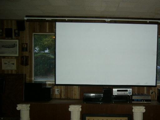

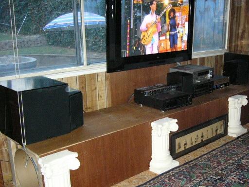

TwisterZ said:Here are a couple of pics of my room. I am still working on the trim, curtains, sheers & blackout shade. I am moving all the electronics to the back of the room this weekend.
Good for you, and welcome to the forum.
I also have cannons (two 20 footers under my bed) and love em....
