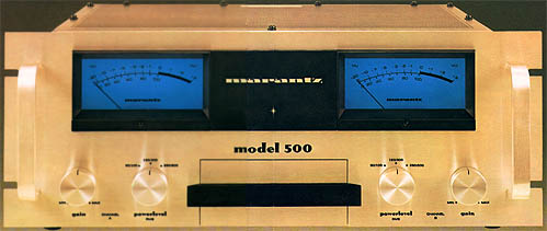

2) If you need more, get a restored Marantz 500.
It combines very high power with excellent sonics.
They are not cheap.
-Chris
Dear Mr. Chris,
which precise Marantz 500 are you referring at?
If the unit is very old I am a little worried about having to replace all the electrolytics and so on.
Any other similar suggestion about newer units?
Thank you so much.
Kind regards,
beppe

Hi beppe,
Yes, that's the baby!
If the amplifier is properly restored, it's sounds really very good. The proper restoration involves matching all the transistors throughout the amp. There are three adjustments for DC offset. If done properly the amp is stable and amazing.
One of these days I'll do one for myself! 😀 Everyone asks too much for them given how much work should go into them.
-Chris
