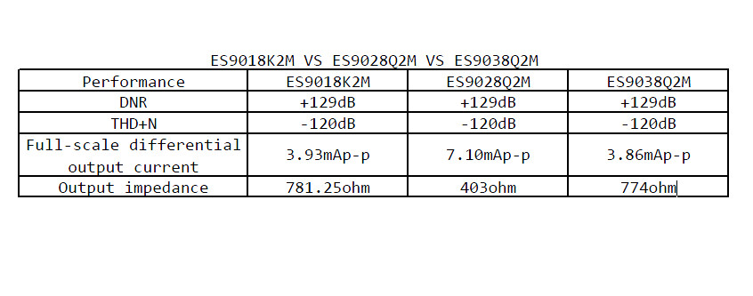

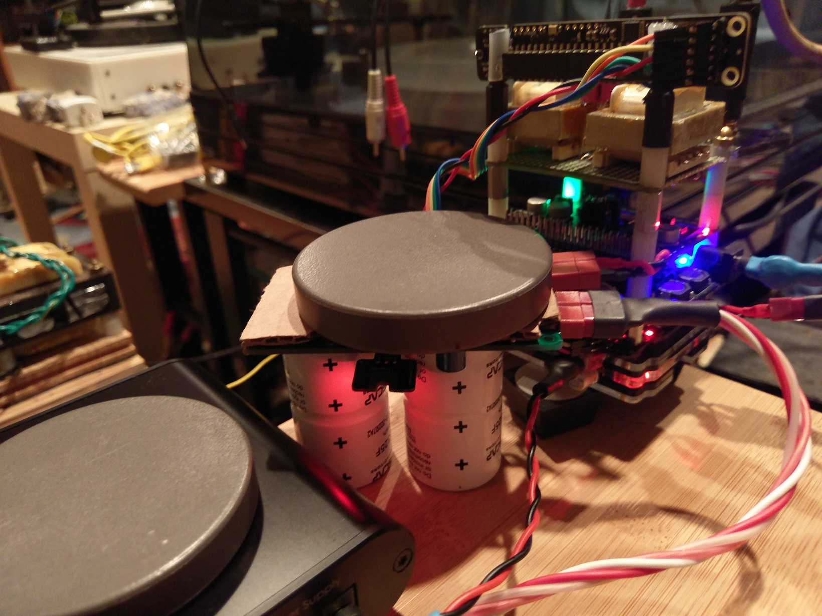

Katana versus Ian's ES9028Q2M prototype
I spent some time comparing these two DAC setups late this week. Ian's ES9028Q2M prototype is a board I got from him almost a year ago (and I believe the same as he is offering in his up-coming group buy). Since the ES9028Q2M is the ESS mobile equivalent to the ES9038PRO, with substantially higher output current than previous ESS DACs, Ian initially intended as a test bed for various transformer-based output stages. So far I tried a pair of the Lundahl 1570XL and the difficult to procure, but VERY good Onetics 600R:600R transformers, preferring the latter. Both were ultimately configured with a gentle pre-transformer rolloff filter similar to Allo's 'Sound Quality' I/V stage version. I ran the DAC on an RPi -> IsolatorPi -> Kali stack, each separately powered.
AND I should add that the ES9028Q2M board was being run in 'pure-sync' mode with the master clock taken from the Kali AND the DPLL disabled, similar to how the Katana runs in master mode.
The Katana was powered by the setup I outlined in post 4 of this thread. The ES9028Q2M had decidedly more 'upscale' supplies (at least cost-wise!), with the IsolatorPi and Kali each having a dedicated Uptone Audio LPS-1.2 energized from a 4-rail DIY'd linear supply. The ES9028Q2M board was powered by a pair of 325F/2.7V Ultracaps in series charged to 3.3V, bypassing all of the local 3.3V regulators, with the only on-board regulator used the 1.2V for the chip's core. That Ultracap was charged by another Uptone Audio supply, their earlier LPS-1, also energized by the linear supply.
Sound-wise, they were decidedly not-dissimilar in character. Both were detailed, dynamic, and very life-like. BUT to my ears and in my setup, the Katana won this comparison. The subtle details I described hearing from the Katana setup in post 35 of this thread were diminished or very difficult to distinguish from the ES9028Q2M board. Lower bass was not as present, powerful, and deliniated from the ES9038Q2M board setup as the Katana. Upper highs were there, but did not sound as natural. Dynamics across the board were VERY slightly muted in comparison to the Katana. Tonally, there was a slight difference between them with the ES9038Q2M setup more centered on the lower mids and upper bass while the Katana was more centered on the middle midrange. IF you had heard high-end audio setups back in the late 1980s through the 1990s, the Katana might remind you of the best of Audio Research tube/hybrid gear of that era (neutral, detailed, dynamic) while the ES9038Q2M would remind you more of Conrad-Johnson tube gear of that time (more centered in the mid-bass, a tiny bit veiled on comparison).
With each of these comparisons, I will outline my planned upgrade paths for the 'challenger' setups... remember, I'm a DIY'er and nothing is EVERY done! For the ES9028Q2M prototype, I have these futher refinements in mind:
- Upgrading the Kali with the same SDA-series NDK clocks as used on the Katana.
- Powering the IsolatorPi and the Kali each with a 5V-charged set of the same Ultracaps as I used on the DAC board.
- Alternative output stages... Lundahl LL1684 and Cinemag 600R:600R transformers.

P.S. Previously the ES9038Q2M DAC board had been powered by an LPS-1.2 feeding 5V to an on-board 3.3V LT3042-based regulator... the directly-connected Ultracap was a significant upgrade in detailing, dynamics, and overall realism. Also note that the multiple off-the-grid LPS-1.2/1 supply setup has consistently been the winner providing 5V feeds for the isolator board (Ian's or Allo's), Kali, and the RPi DAC HAT in most of my previous trials. Interesting that I expected them to be the best for powering the Katana 5V rails. Imagine my surprise when ultimately, my AC-connected supplies won on the Katana!

Greg, I'm not sure if you were comparing three different dacs or two. Didn't Ian decide to go with ES9028Q2M? Katana uses ES9038Q2M. Since both are mobile chips, I think an IC opamp I/V stage could work fine with either one. (I could suggest where you could find a reasonable schematic for one you might try. 🙂 )
Anyway, when you said you compared ES9038Q2M dac with Katana, was that the actually ES9028Q2M or another dac Ian made?
Also, you said ES9028Q2M is the mobile equivalent of ES9038PRO, does that mean ES9038Q2M is the mobile equivalent of ES9028PRO?
Big Oops on my part... thanks for the catch Mark!
@Markw4, thanks for the catch. I DID only compare 1 DAC, Ian's prototype ES9028Q2M board which has a significantly higher current output than the ES9038Q2M board. Sorry for the confusion in my post.
Ian is actually listing 2 DAC boards for his up-coming group buy... an ES9028Q2M board, likely the same as what I used in the comparison above, AND a dual mono board using the ES9038Q2M. Running that chip in dual mono, the current output will be slightly higher than that of the ES9028Q2M.
Note that ESS made this a bit more confusing... and how you stated it in your last sentence is exactly true... in the PRO line, the ES9038PRO is the high-current output model, in the mobile line the ES9028Q2M is the high-current model.
You can see some of the relevent specs of the ESS mobile DAC chips in Ian's post 43 of this thread:
https://www.diyaudio.com/forums/pc-...sd-i2s-dac-hats-raspberry-pi.html#post4962508
I duplicated the chart from that post below.
Again, sorry for the confusion in my previous post. I was comparing Ian's ES9028Q2M prototype DAC to the Katana. AND thanks again Mark, for catching that!
According to the chart, mono mode with ES9028Q2M would output 14.2mA P-P per channel. Still well within the capabilities of OPA1612. Just need to adjust the I/V feedback resistor and cap to get the right voltage swing, about 3v P-P, and retain the same RC time constant (if using the schematic I would offer up as one suggestion).
