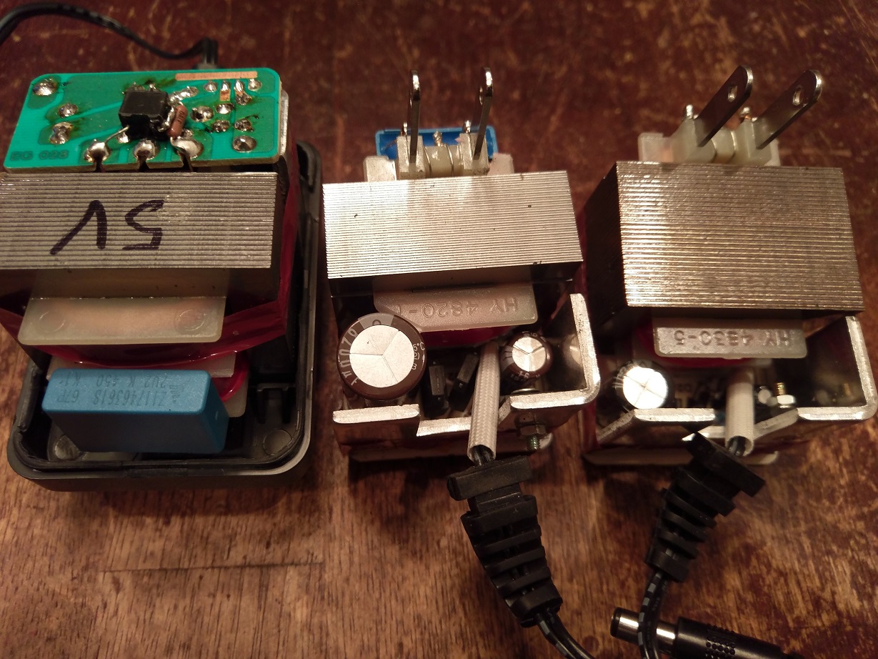

Also on the modified Jameco linear regulated wall warts, if one was really serious about these, they'd look at upgrading the regulator too. My original purpose for these was to replace the SMPS wall warts that came with the various switches & FMCs I use for my audio networks, so I kept the mods simple. Then on a whim I tried some powering Isolators, Kali's, & RPi DACs & they weren't too bad.

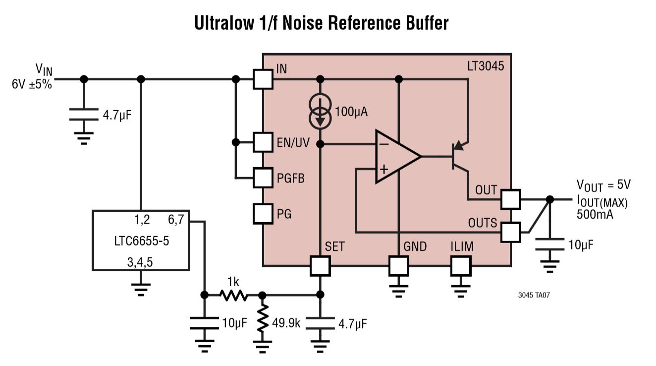

Turning back to the subject of Katana power supplies, I would like to suggest I an idea. I don't currently have everything I would need to test it, but here is the idea. As far as all the 5v supplies go, they can probably be run from one transformer and one rectifier bank. Rectifiers should be ultra-soft turn-off types. Regulators can be LT3042 w/pass transistor boards from China. If the output stage is run from an analog +-15v supply, probably no reason why the MCU and isolator boards cannot share a regulator. The Katana board should probably have its own. A number of people have reported disappointment using LDO regulators for dacs. One likely problem has to do with LF noise. Attached below is a schematic from one of the LDO datasheets showing the recommended configuration for ultra low LF noise. One such reference could probably work with multiple LT304x regulators.
For the +-15v supply there are various options. It is possible to use LT304x regulators for that, but maybe not the best idea. What I use for my modded ES9038Q2M is one of these, with extra, very low ESR output filter caps: Ultra-low Noise Adjustable +/-15V DC Voltage Regulator Module, LT1963A LT3015. 6921407430679 | eBay
The output caps I add are 10,000uf, .053ohm ESR, which help a lot.
The big filter caps for +-15v, and the LT304x regulators should probably be located very near the loads, and use short length heavy gauge wires (since the sense pins for the regulator chips won't extend out to the load).
Seems like the cost of doing something like the above, including transformers, should be doable for maybe $200.

Me, I've been definitely less inventive and more 'practical' minded. I've been focusing on answering Markw4's (and @matthiasw too!) two questions... how does the Kali compare to my other top-quality DIY DAC setups AND how does it sound powered by theoretically less-capable power supply setups?
I've been listening to one of those other 'top quality DIY DAC setups', Ian's prototype ES9028Q2M in a RPi -> IsolatorPi -> Kali -> DAC -> Onetics 600R:600R transformers with Rasmussen-styled filtering for the last few days with a couple of power setups. Best power so far has remained the same as before, 3 Uptone Audio LPS-1/1.2's, with a 1.2 each for the IsolatorPi and Kali and the 1 on the DAC. Each supply has an additional buffer... the IsolatorPi and Kali are each fed through 1/2 of a 5V OPC 4||LT3042 board, the DAC board has a a pair of 325F/2.7V Ultracaps in series charged to 3.3V that is directly-connected to the DAC board without any additional regulation except for the 1.2V rail. NOte those Ultracaps will power the DAC for awhile without the charging LPS-1 connected. I'm not quite ready to share what I'm hearing, but this setup and my reference Katana setup are very close in most parameters.
I've also adding alternative power supply options. I'm putting a pair of modified 12V/1A Jameco Linear Regulated wall warts in the mix. They'll be feeding either the same 5V OPC or Stammheim X||LT304x regulator boards as above or for a lower-cost option, more basic (LT3080/LT3083) 5V regulators.
My alternate supply list is now:
- Basic supplies... 2 5V iFi iPower (if I can borrow a 2nd from someone, I'm not going to buy another!) OR 2 basic Allo 5V supplies (if I can borrow those) OR 2 modified Jameco 5V/1A linear regulated wall warts.
- Good supplies... 2 modified Jameco 12V/1A linear regulated wall warts OR my raw DC supplies as outlined in an early post, with either feeding basic (LT3080/3083) 5V regulators.
- Great supplies... 2 Uptone Audio LPS-1.2's feeding 5V directly. OR feeding the more sophisticated 5V OPC or Stammheim X||LT304x regulator boards from either 2 modified Jameco 12V/1A OR my raw DC supplies as outlined above OR 2-4 Uptone Audio LPS-1.2.
- Alternative supplies... 2 5V direct Ultracap supplies float-charged from the modified Jameco 12V/1A linear regulated wall warts OR Uptone Audio LPS-1s/1.2s.
- TBD supplies... Nirvana and/or whatever else Allo ultimately releases for the Katana, assuming I can borrow one.
- Downgrade potential... all of the above using 1 instead of 2 5V supplies for the Katana DAC / Isolator / Microprocessor boards.
AND for now, I'll keep my +-15V supply constant for all of the above options. I placed an order for a few components I needed to finish preparing the 5V direct Ultracap supplies and the 12V/1A Jameco's. The parts should be in his week and I should have those supplies ready over the weekend.
The other twist I'm adding is to try these alternative supplies powering my other top DAC setups where they work ok. This is to both get a better feel (broader set of experiences) for how those alternative supplies compare... and maybe even learn some new combinations that work better than I expected, such as unexpectedly finding my AC-connected raw DC supplies beat my LPS-1/1.2 setups powering the Katana!
In the meantime before I have more to report, here is a quick picture showing 2 modified 5V Jameco's on the left with a stock 12V unit on the right, as requested by @drpro. Note the significantly more beefy transformer in the 12V model.
IF this remains a good option, hopefully many out there can find equivalent units in their own AC voltage and plug configurations.
