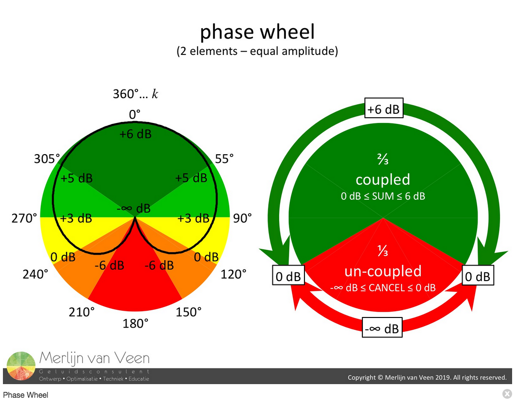

The wavelength is determined by the speed of sound (1130 feet per second) divided by frequency.
When two sources are within 1/4 wavelength (wavelength divided by 4), the two add constructively regardless of listening axis (direction), they behave as a single source.
1130/100=11.3/4=2.825 feet.
Within 2.8 feet, the sub and main speaker crossed at 100 Hz are virtually a single source.
When two sources center to center distance exceeds 1/4 wavelength distance apart and are listened to/measured off axis, the combined output will start to exhibit dips in frequency response due to the time of flight/phase difference between the two sources, as well as time of flight difference from room boundary reflections of the different source locations. Merlijn van Veen's "Phase Wheel" illustrates some of this concept.
Your drivers have low distortion, you can measure their response with REW to confirm.
In sealed boxes they will have more than enough low distortion output down to the 20Hz range to keep up with your mains at levels under those that will make house rattles far more objectionable. They will require less power to achieve their maximum clean output (Xmax) in larger sealed boxes, you may find a larger than "optimum" (one cubic foot) box to be preferable. Since the most accurate sound, rather than maximum output level is your desire, you don't have to consider more efficient larger ported or horn designs, or open baffle designs that probably won't "keep up" at low frequencies with the mains within Xmax limits.
You will also find the room mode response dominates low frequency response, "the 1/4 wavelength" rule may not offer the optimum placement of your subs for even in-room response.

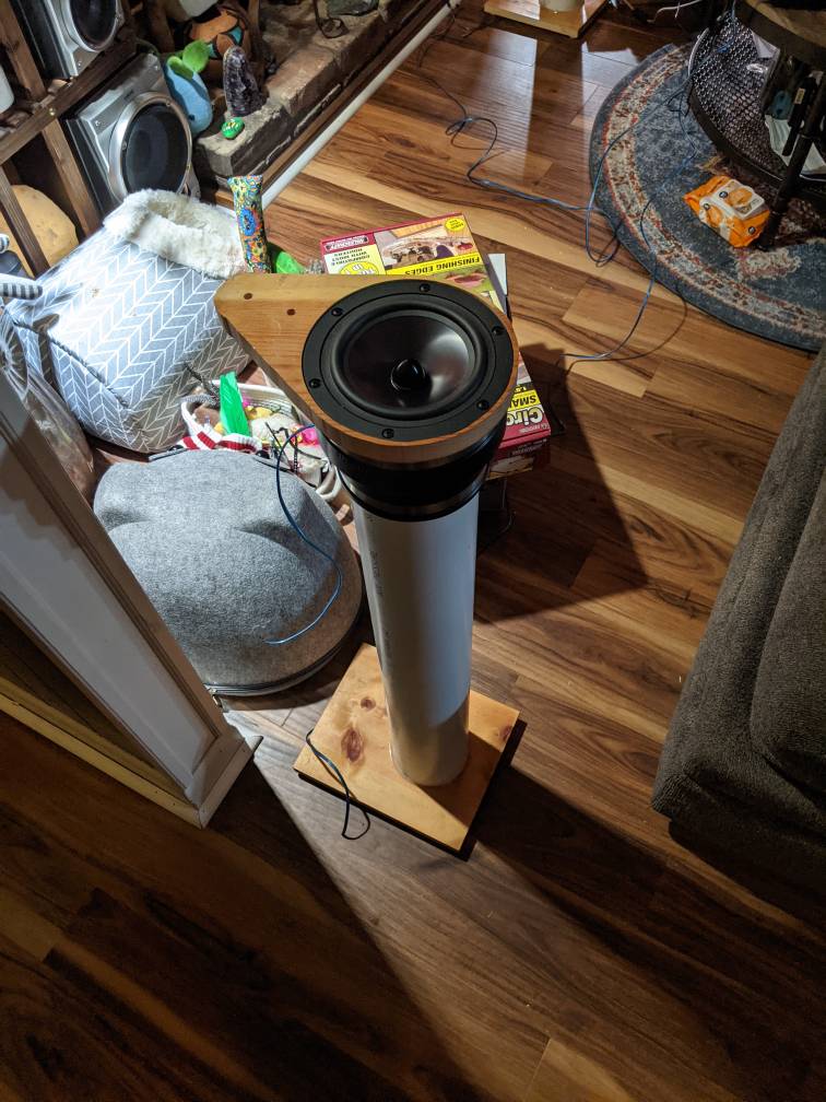

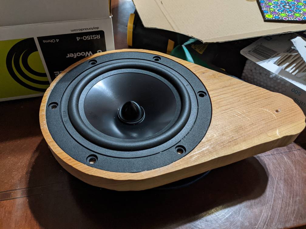

Pictures of the mains?
They aren't finished yet, but I'm building them pretty much to spec. from the link I posted. I'm still waiting on the tweeters which are backordered but I'll post a pic of them so far as what I have, my router work is embarrassing 🙂 and I have have not started any finishing work either, so hopefully they won't look so rough in the future. But here's a few pics of the "so far"
