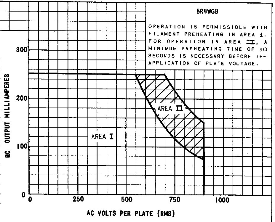

It is certainly known and documented in rectifiers.
The combination of high voltage and absence of current-limit will cause actual arcing, as anyone who has crash-started directly-heated rectifiers into an excessive load can verify.
Here is evidence for that, in the RCA 5R4WGB data sheet, where we are warned to preheat the filaments for ten seconds, if high voltage and a heavy load is present.
