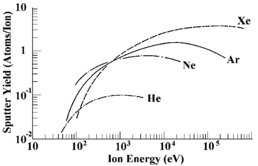

Last estimate, Ek(nickel) ≈ 516 eV, looks reasonable, even for ion-atom collisions; because most cathode sputtering theories based on the billiard balls model, fail at low energies.
Supposing elastic collisions, heavier ions should make more sputtering, but a result provided for a measurement equipment manufacturer, for a silicon target
This shows how capricious can be low energy collisions.
