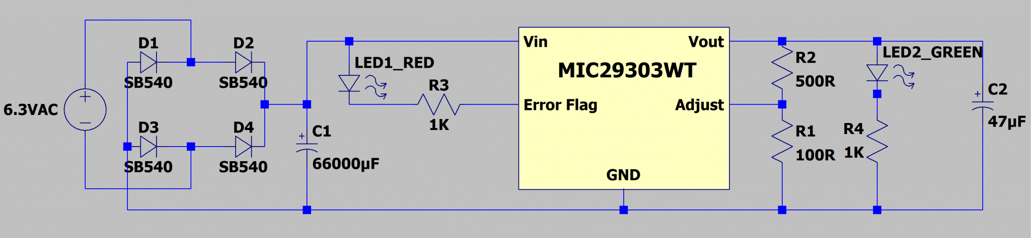

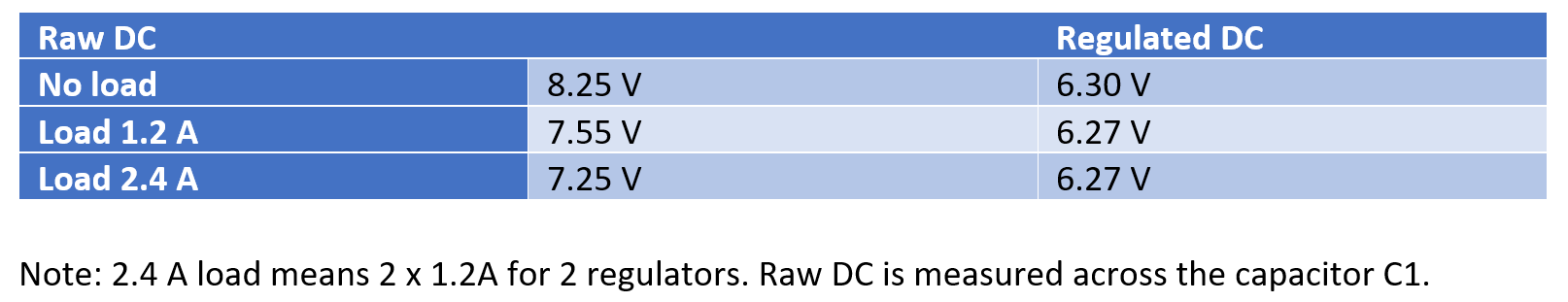

Yes, wait and see. Your 5.6 mA without load is just below the minimum load, but you already got 6.3 V without load, so it seems to be OK.

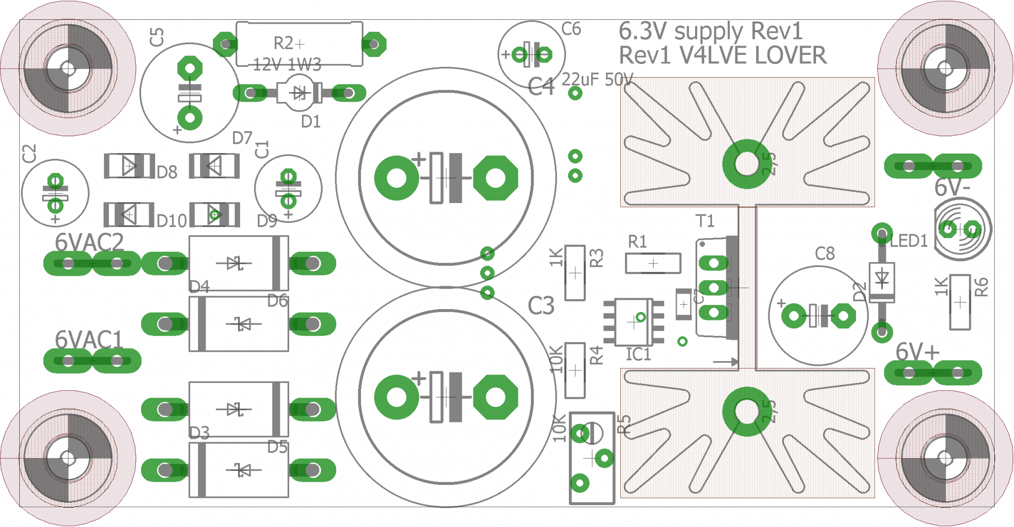

Update: AC voltage = 6.85V (it will supply the heater of the output tubes, maybe I will reduce it with a series resistor)
Average DC voltage on the puffer capacitors: around 8V (changing +/- 0.1V), ripple: 0.75Vpp
Stabilized voltage: 6.36V, no noise 🙂
Calculated dissipation: 2W (1.7V drop x 1.2A load current)

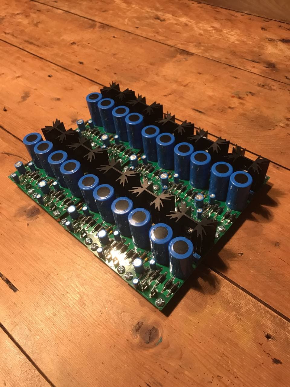

Ive posted 6 boards that i have left in the swapmeet, last parts will arrive by Friday.
