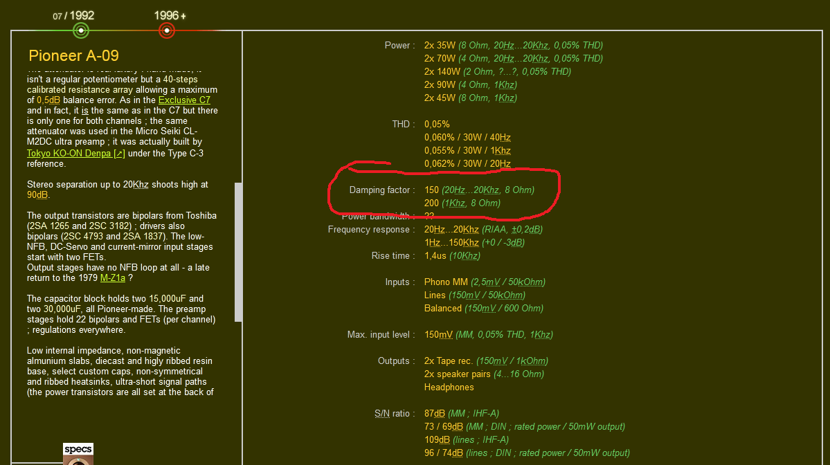

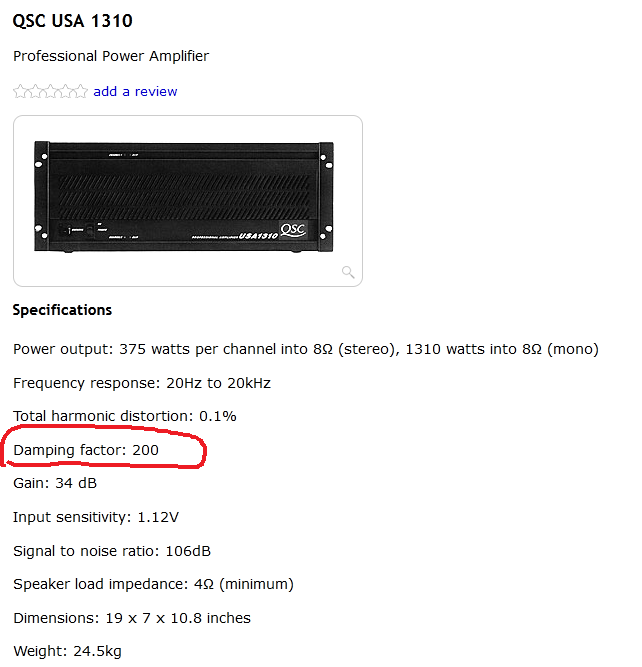

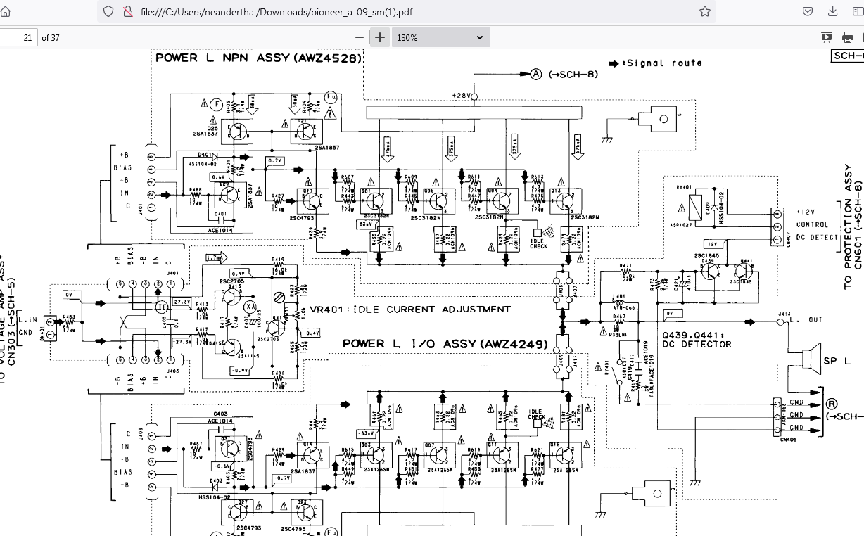

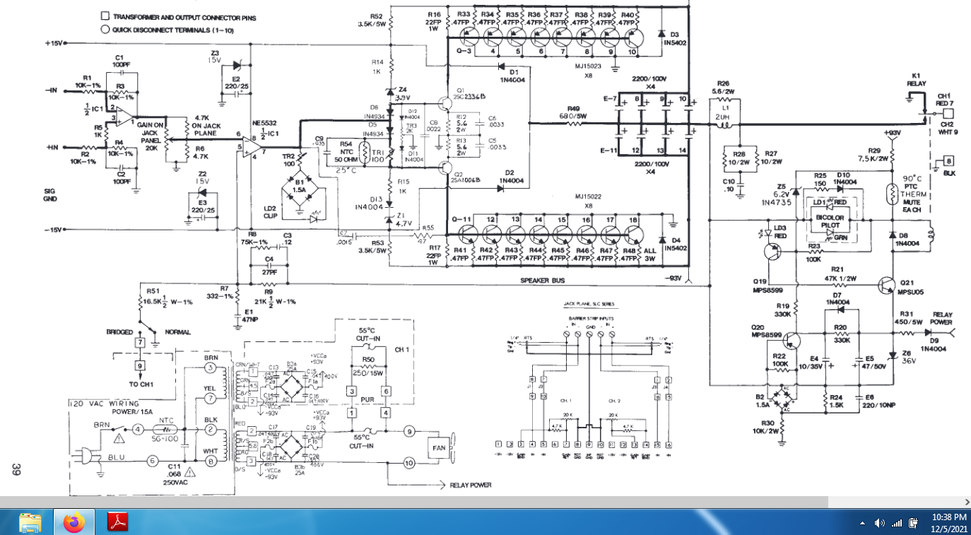

You really need to proove that THEORETICALLY in the first place cause Pioneer a-09 amp quoted by Cioffoli had a diamond buffer with no global feedback, while QSC USA 1310 is using a virtual ground relying entirely on unregulated...electrolitic capacitors .If you ever heard a QSC USA amp you know what BASE means... I doubt a guitar player will ever care about damping factors when miking a cabinet at 80 hz...Unlike you maybe i had a Kenwood ka-1000 and huge damping factors arent really what people believe they are as you always need to factor in a relay in series with the output in 99.99% of the amplifiers...Unlike your usual Crown pro stage amplifier QSC has some capacitors and at least 0.05 ohm emiter resistor in series with their woofers ....never heard of audio amps based on silicium transistors with no emiter resistors either...I assembled several Ge output power buffers along the Ciuffolli Follower lines.

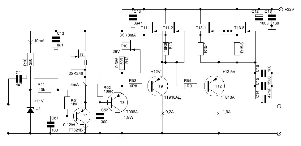

I have measure output impedance at 1 kHz 13mOhms by using this preliminary draft Ge SE output buffer schematics. It was Ge quadruplet emitter follower schematics, designed along with Ciuffoli Follower lines. Cases of all transistors can be grounded, very convenient,
Later on, trying to improve sound further, I have replaced the first and the second Ge stages by one BC109B Si stage. Also I have substitute the D1 Zener by a resistor shunted by decent capacitors. Some base resistors have also been removed.
I should also to mention, that in this schematics, there is no problen to put several Ge output transistors V12 in parallel. For this, each V12 transistor must be loaded by its individual current source, and each collector must see the load via its individual output capacitors. Outputs of all capacitors then connected together and form common output to the load. So quite powerful SE output buffer is possible in this way. The 1T813 transistors are in fact two 1T806 chips placed on the same substrate in parallel.
At present, I use such Ge buffer with single-tube triode connected 6E6P-DRU preamp, C11 is placed at the preamp output.
