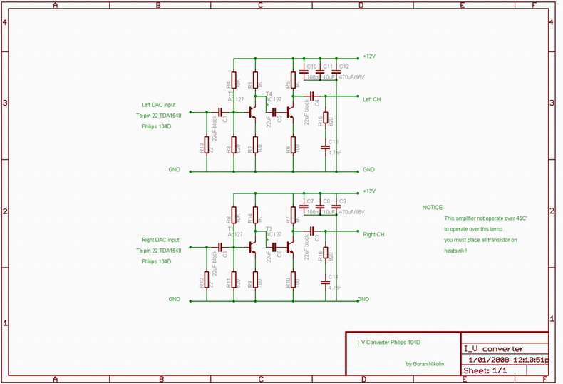

@tvicol
I'm interested in your version with GERMANIUM trasistor!! I'm a fan of Ge transistors, I asked many people in my country to make exactly what you do, but without any success... So, PLEASE, can you post me YOUR shematics?

Sometimes I wish I could read Polish/ Chineese/ Japaneese/ Russian etc.....
In the diagram, The second transistor , T2/T4, does not have any bias.
I assume that it is a repeat of the first stage?
I also like the note re. operating temperatures !!!!!
Andy
I wil try to translate the explanation...
Transistor bias is controlled trough inverted (polarization) capacitor, this way the operating “class” of germanium transistor is controlled by his current “leaking”…
Unlike Silicium transistors, this is posible with Germanium transistors, and works very, very well…

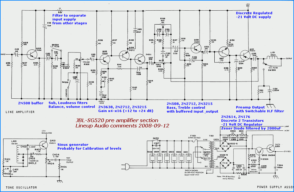

Lineup Audio LAB verdict:
JBL SG520 pre amplifier circuit
- Just great! Very High Quality, with today's standards,
.. eventhough being 'very old' amplifier
See my detailed comments in circuit.
My Attachment, here below.
Enjoy 🙂
