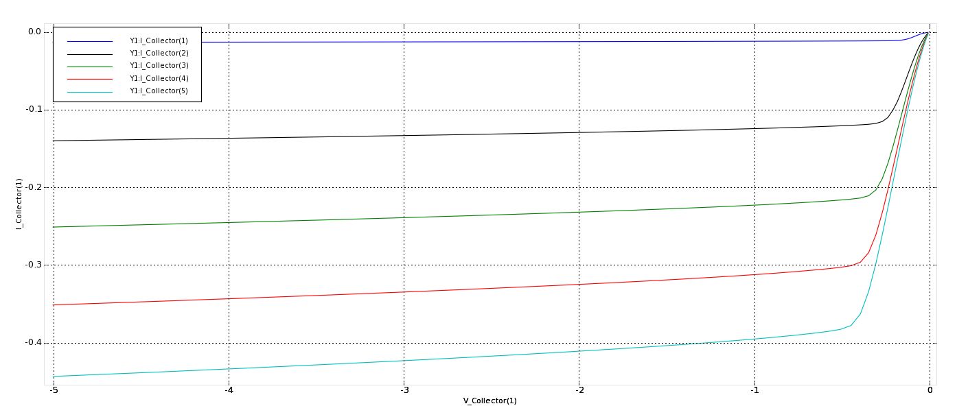

After watching the NP interview where he discussed his interest in Germanium, I ordered some parts. The parts have begun to tricke in.

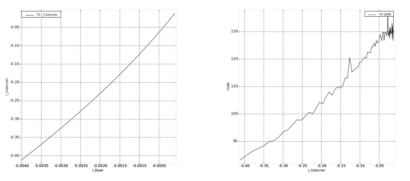

This is a 2SB63 power device. It looks to me to have a built-in compressor. Where a MOSFET is a square law device, this Germanium BJT looks like a 1/X law device.

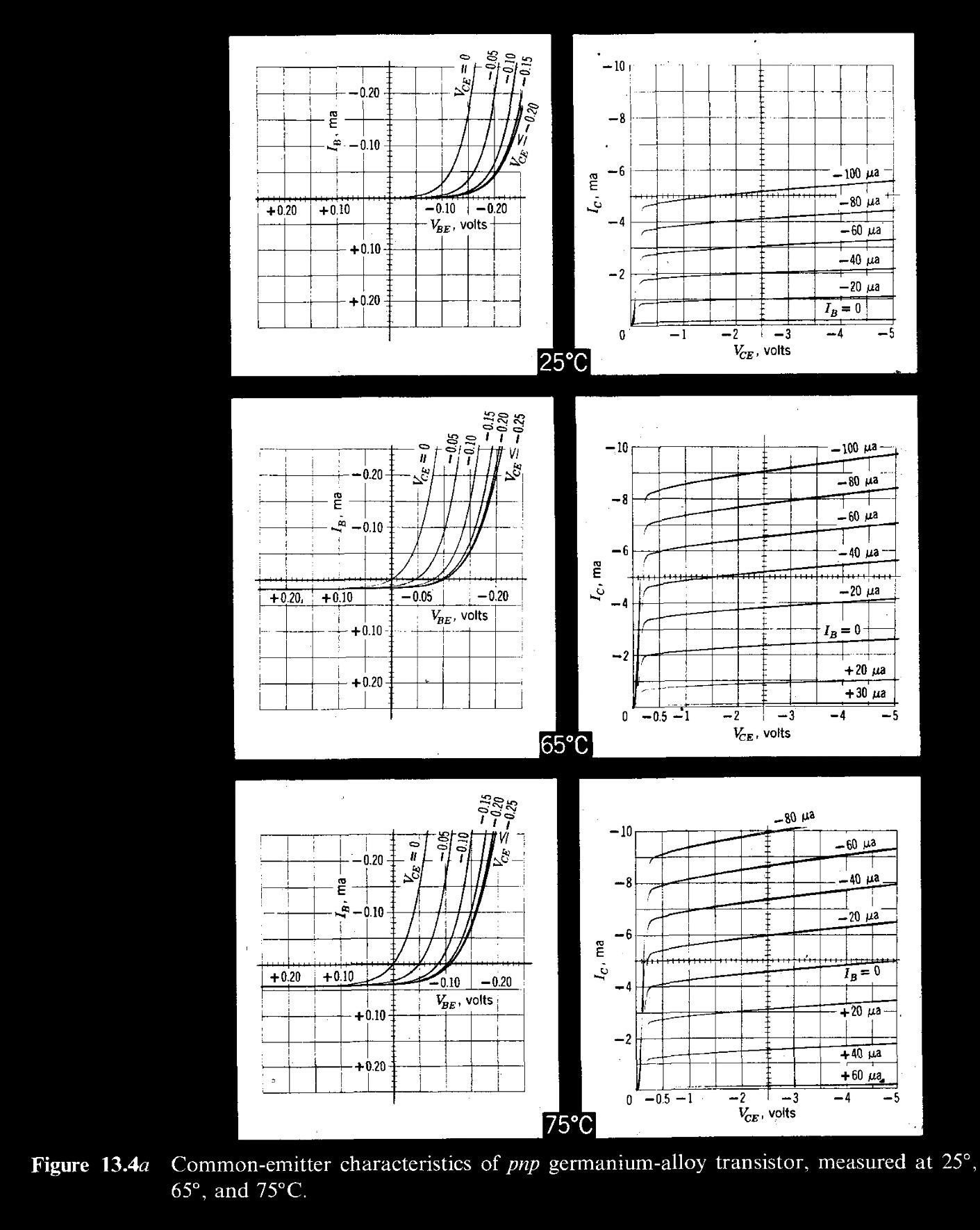

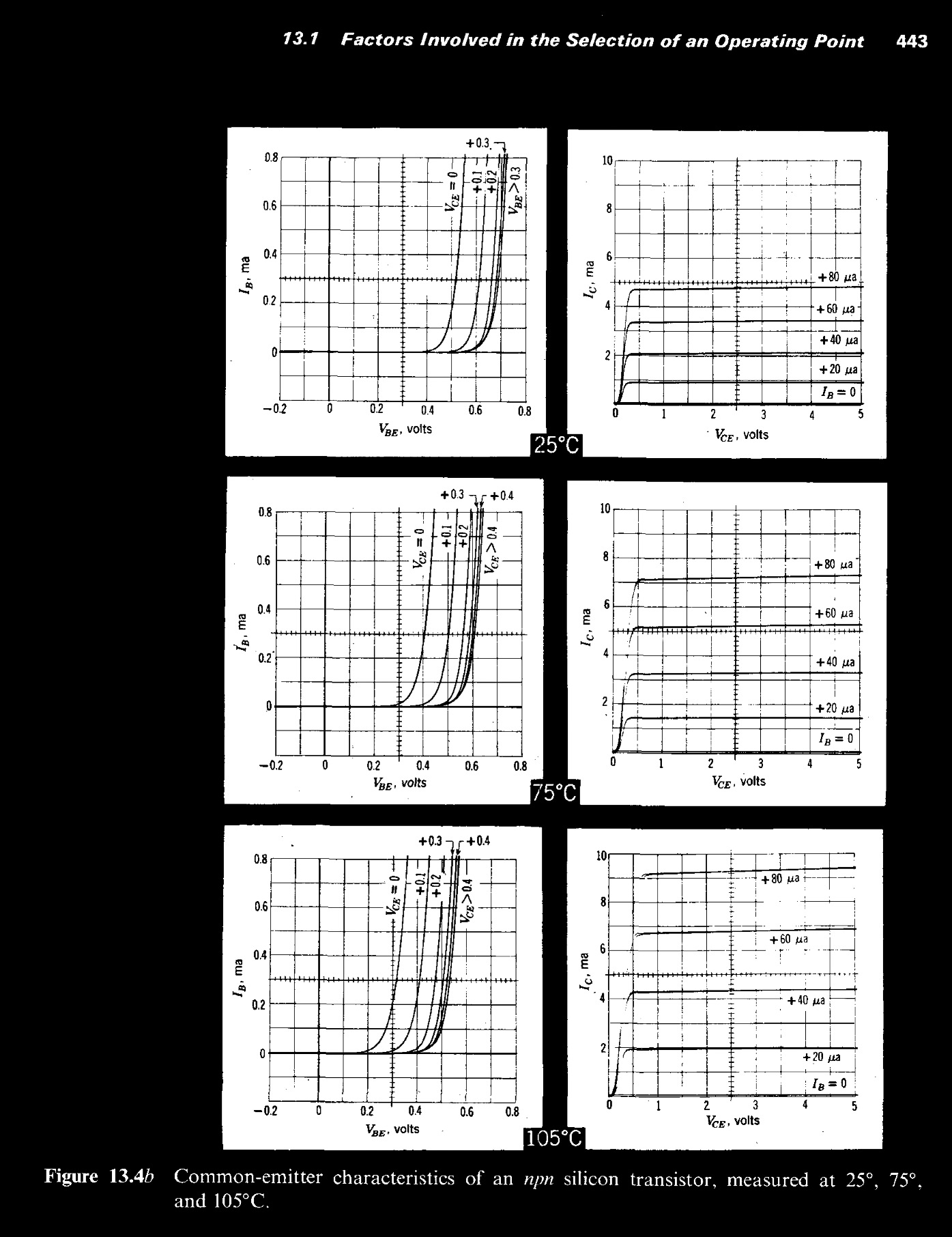

Standard BJT curves. Early effect evident in the first plot, gain droop at higher currents in the second. Its traditional for that second plot to be log-log scaled. Both plots are upside down (!)

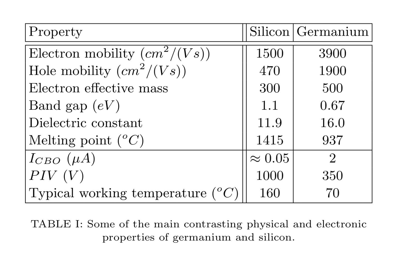

The only blatant differences you'll see with common Ge BJTs compared to Si is the lower bandgap voltage and the much higher leakage currents, the physics is the same.
Careful soldering Ge devices, they don't like any kind of temperature.

Thank you for the info and the soldering advice. I will use a spring loaded scissor clamp heatsink on the transistor leads.
More measurements to take on more devices.
I will curve trace and compare some power silicon BJTs.

I have ordered quite a few different Germanium devices. Just getting started to measure them and try to understand them. I have already destroyed one. The small signal devices appear to be easy to make into a dead fuse.
So far, I like what I see. No devices yet have the horrible quasi-saturation behavior I saw in the KSC3503E that I used in a preamp/driver project.
The harder you drive the Germanium devices, the more the linear region expands.

I was impressed by something that NP said in one of his videos. He looks for devices that are more linear before degeneration. A corollary to that could be looking for devices that behave better at boundary conditions.

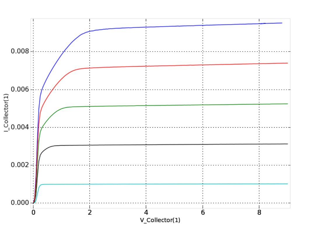

KSC1845
KSC1845 Family of curves. I set this up to show the pertinent info for biasing at at 5mA class A and show the behavior at clipping.
My experience with a KSC3503E having a similar shaped family of curves is that clipping is ugly.
If this device is cascoded at 5V or more, it is nicely linear.
So far, all of the Germanium devices that I have run through the curve tracer have none of the quasi-saturation gain compression near clipping.

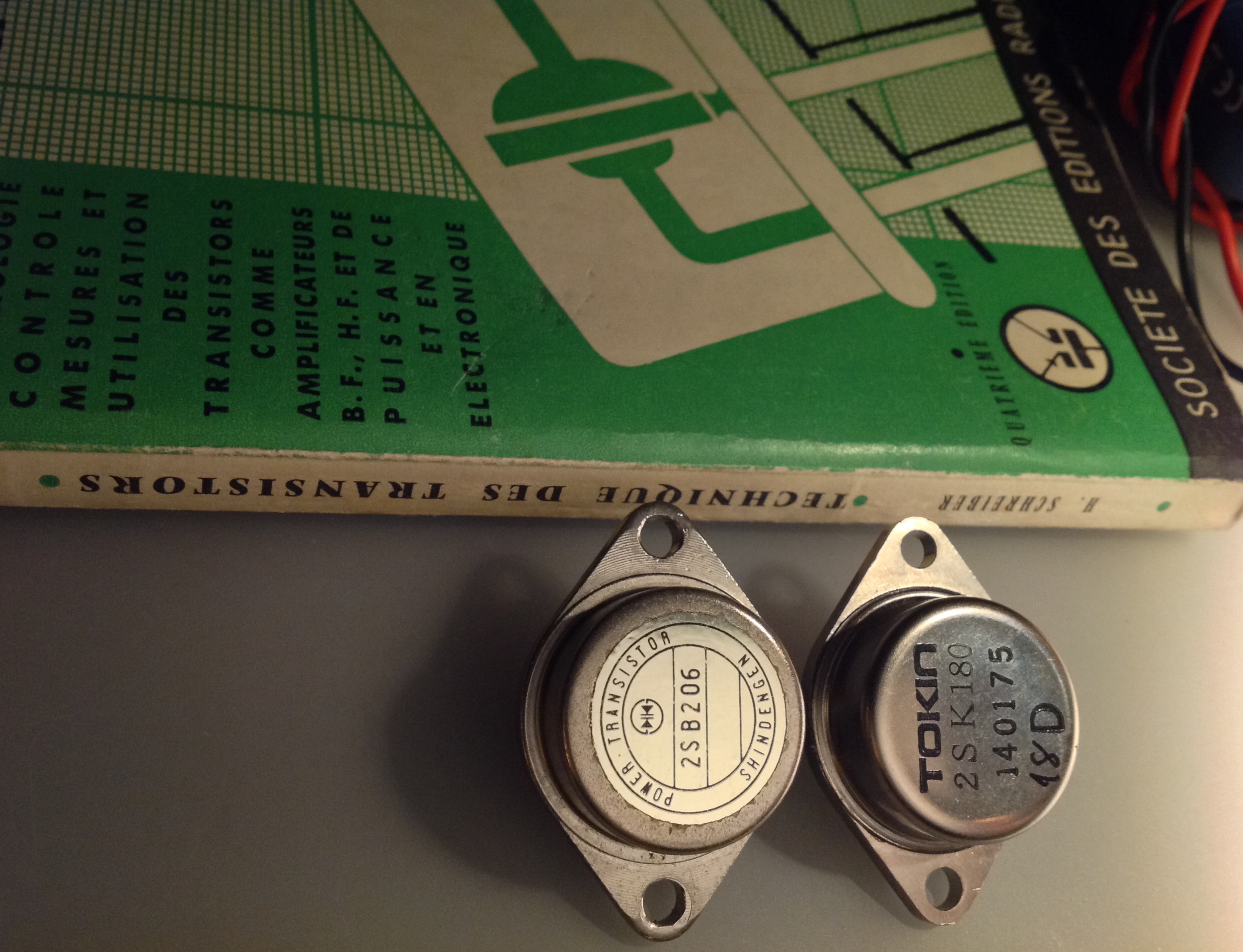

Cool Woofertester You received them :happy1: let's start Germanium curves show!

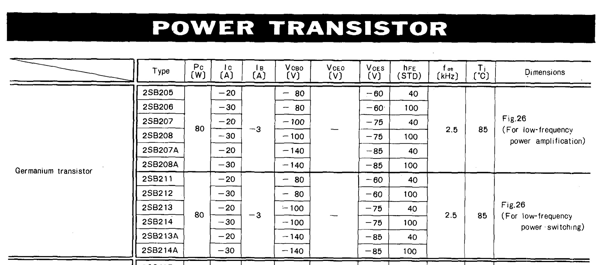

Datasheet say 2SB206 power dissipation ~ 80Watt's.
Strange because transistor package size is similar to big 300Watt's 2SK180.
That is an interesting point. I have bought different germanium power devices that do have data. They all seem to be low power rated compared to similar size silicon devices.
I think that it may be because they are junction devices. Just my opinion based on reading how they were manufactured.
