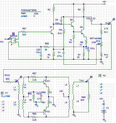

Three years ago I spent too much time simming a studio microphone preamp using only Ge devices (SmallBear has good stock, and knows the good from the bad (the bad are good in fuzzes)).

I put together a small germanium headphone amp together some years ago, and its great 🙂
GERMANIUM Single ended Class A Headphone Amp.
That's a very nice circuit with a good use. I'll see if rediceman's list will fit in.
Why a supply of 6.8Vdc?
Do you have some extra spec's available? Just to be sure, germanium renders different settings.
I calculated (so far) the current source Q4 at some 60mA and output node Q3e-Q4c-R15 at -3.2V.
Amplification is nearly 6x, so suitable from line level (150mV).

A 6.8 volt supply was about as high as the two nominal 4.8V battery packs would support and listening tests showed it was more than ample given reasonably high efficiency 'phones.
Some of these ancient germanium devices begin to conduct at around 130mv V-BE and the quiescent current of the output stage is about 45 to 55 milliamps depending on temperatures.
I'm afraid I've no other specs on the unit, it was all built and optimised subjectively but it certainly performed very well.
So Q5 is at Vbe 165mV given 50mA (median) and R10 (3R3).
Battery pack (NiMh) of nominal 4.8V (6.8 topcharge value).
So when not in use on charger (on-off-charge switch).
Open loop gain of Q2 is below 1x (est at 0.75x). Not intenionally?
To raise it above 1x, R8 should become 330-220 (& adjust R12).
Do you mind I adept your circuit for rediceman with given semi's?
There are to few to incorporate the volume bufferstage, so that's omitted.
If ok I'll start the calculus.
