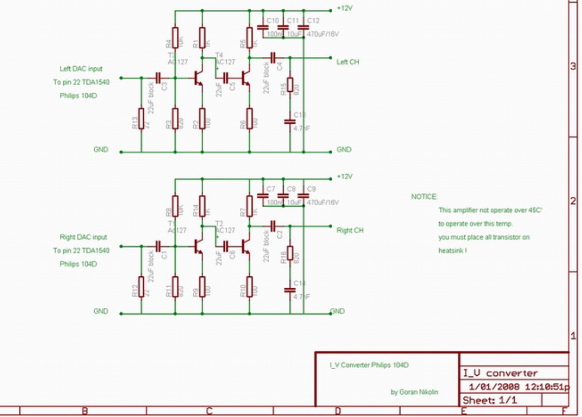

Mooly's circuit referred above can suit this. It's an easy to modify universal circuit, often used for video amplifiers. I'll run a silicon mod if Mooly approves.
But, as Mark Tillotson points justly, things will be different making a direct comparision rather wacky.
I've overlooked one small but very important issue: there is one npn (2SD77) in Mooly's circuit, but no npn on rediceman's list...
Sorry, but a no go for now unless rediceman can purchase 2 proper npn germanium bjt's.
Here is a quick sim of a silicon version delivering approx 20mW into 33 ohms. A couple of biasing resistors have been altered.

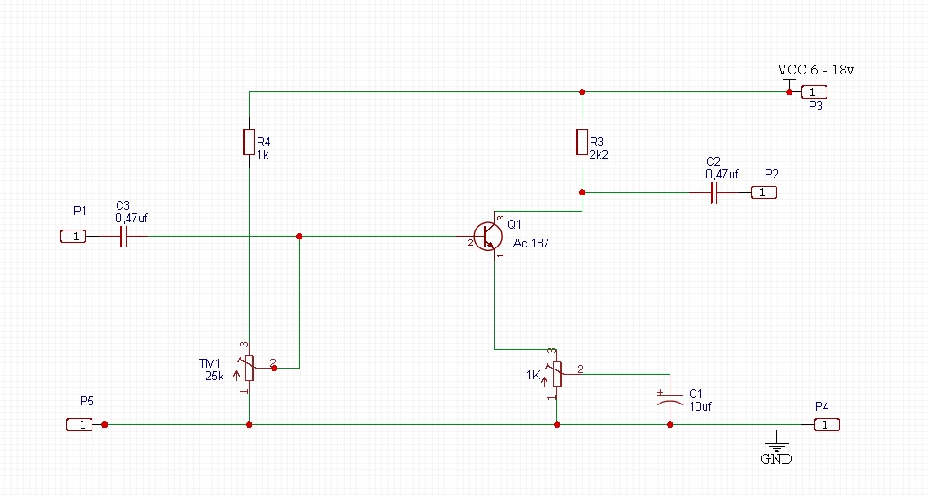

Hello MarsBravo,
I found 2sd77 equivalent transistors. 🙂
Ac127, Ac176,Ac187,2sd30
Thank you for your interest
Best regards.

Absolutely I approve as long as it's realised that you will have to alter the circuit to suit your exact needs. Remember this was designed to drive a low impedance load.
Here is a higher resolution sim and also a sim running into 600 ohms rather than 33 ohms and with a higher supply voltage. This one is delivering 1v rms into 600 ohm with a -15 volt rail.
Ok, I'll suit it to -12Vdc supply and adjustable bias (5-50mA).
I omit the inputbuffer and volume (the input res may be replaced by a pot if preferred)
Just straigtforward as is with the given GE bjt's.
Considering a SI-variation for a two-channel left-right switchable box.
