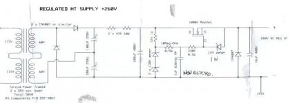

I need a gerber file for a very simple Power supply schematic. I have no clue and I have no time. Its for a personal project, I want to make some really smart mono blocs that look professional. I have attached a schematic, hoping that someone might take pity and help me. If you live close to Canberra I could buy You a beer,]

Its everything after the after the 47r resistor, and the ability to have different rectifiers?

ok this is the schematic. I dont need the voltage doubler. Can anyone make this into a Gerber file? Or give me some advice? Or help in anyway at all?

I have done pcb for this circuit.
Would it be OK for you (as Gerber file) ?
Yes usually I would jump at this but my project is my ultimate/amp for ever type. That's why i don't just draw it with marker and etch it. I want it to look like it came from the store. Maybe stupid but I plan on having them forever and money isn't the issue. I already have the dc heaters. Just need the reg dc for first stage. But many thanks
