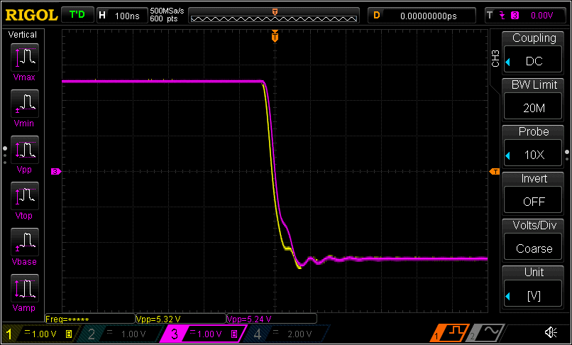

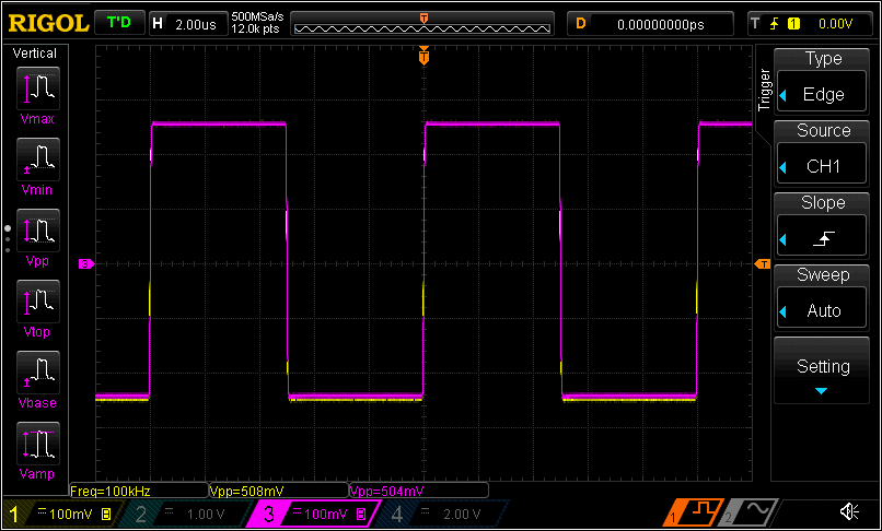

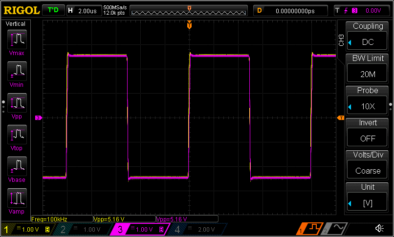

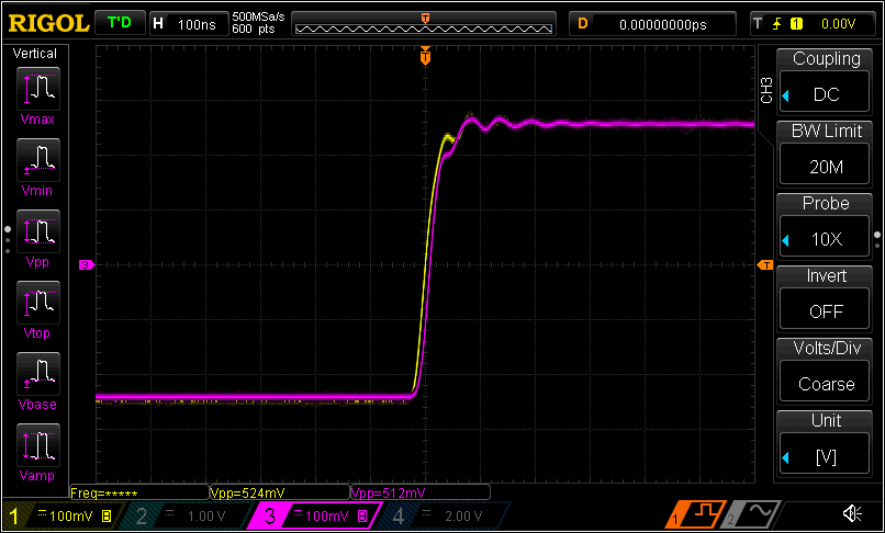

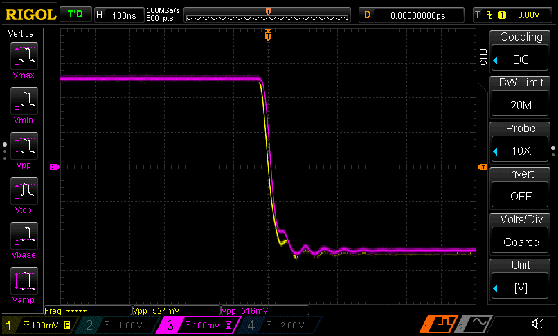

As a result of a PM from a fellow diyAudio member on the OPA627, I decided to add a few more measurements on a genuine OPA627AP.
I already posted the results of comparative measurements in this post, just over four years ago. But now that the test equipment I have available at home is a bit more sophisticated, I can post better images of the results.
I chose to do similar measurements as back then with the OPA627 setup as voltage follower (buffer), no load on the output. The circuit was fed with +/- 15 V from a linear lab PSU.
One set of measurements was taken at 100 kHz, 5 Vpp and another at 500 mVpp. First a couple of waveforms and then zoomed in on the rising and falling slopes.
Channel 1 (yellow) shows the signal right at the input pin of the opamp, CH3 (pink) the output.
The setup on a breadboard was not ideal (hence some ringing) but good enough for comparison with other opamps. The OPA627 can follow the input really well, though with larger signals it doesn't have as good a response as with smaller signals (as expected).
If a suspected-to-be-fake OPA627 doesn't do this equally well, then it most likely is indeed a fake.
