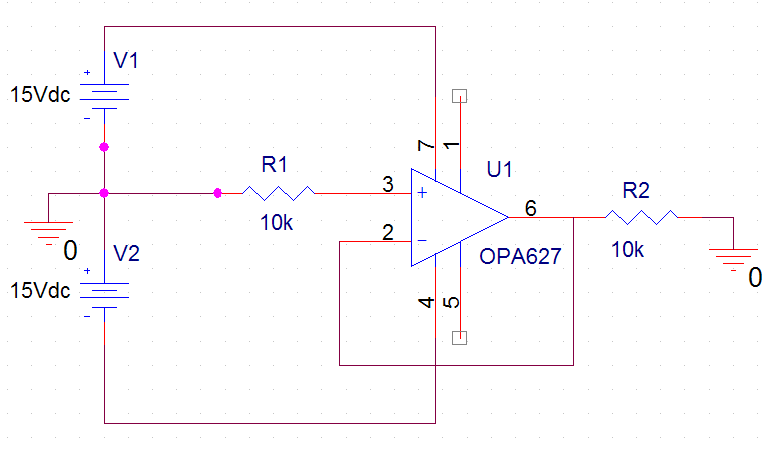

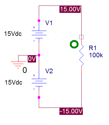

You want to know the current drawn by the internal opamp circuitry only without the current drawn by the load on the output.
Leaving in- and/or outputs floating is, however, not a good idea. The output of the opamp will go into positive or negative saturation immediately if there's no feedback. I found that this affects current draw by a few tenths of a mA.
What you need is a stable circuit that doesn't deliver current into a load because the output = 0 V.
I chose to build a voltage follower (aka buffer) with 0 V in and therefore 0 V out.
You need:
symmetrical +/- 15 V power supply (PSU),
ammeter that can measure in the 0-40 mA, or 0-400 mA range.
two 10kOhm resistors,
wires and/or jumper leads
maybe also:
Veroboard
DIP-8 socket
I built the circuit on a breadboard, but you may also solder a socket and the other components on a Veroboard.
Here's how to wire the circuit:
Take a look at the pin configurations in the datasheet first.
1) Connect +15 V to pin 7 (+Vs)
2) Connect -15 V to pin 4 (-Vs)
3) Connect a jumper lead between pin 6 (Output) and pin 2 (-In)
4) Connect pin 6 (Output) with 10 kOhm to GND
5) Connect pin 3 (+In) with 10 kOhm to GND
Pins 1, 5 and 8 must be left unconnected.
I will post a schematic later.
I assume you know how to connect the symmetrical PSU to your circuit. The ammeter can be connected in series with either of the PSUs.
If you doubt you built the circuit correctly, try it with a cheap pin-compatible opamp first (e.g. uA741) and compare measured value with the one in the datasheet.
The datasheet of the OPA627 specifies that the current drawn from a +/- 15V PSU is typically +/- 7 mA at 25 degrees C with a max. of +/- 7.5 mA.
That's what you should expect to measure on a genuine OPA627. Right now I have a OPA627AM in the test setup and it stabilizes (allow some warm-up) at 7.14 mA.

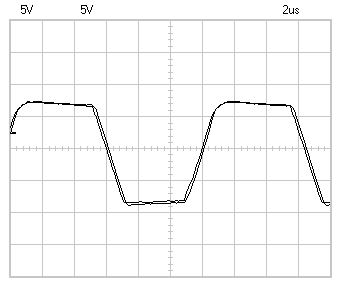

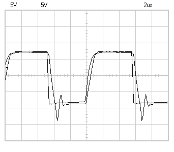

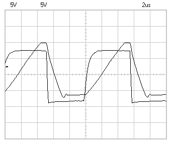

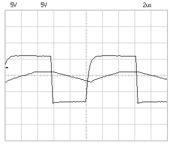

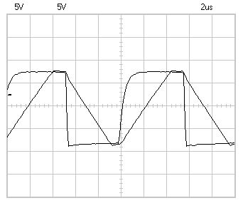

I have been trying to find another method of wielding out counterfeit OPA627s.
So far taking a good look at the OPA627 combined with a measurement of the quiescent current is all that was available to me but I might have found a DIY friendly way that only requires a scope, a LM393 and some resistors and a cap.

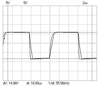

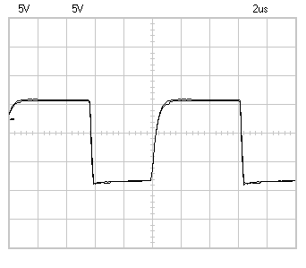

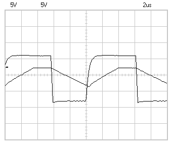

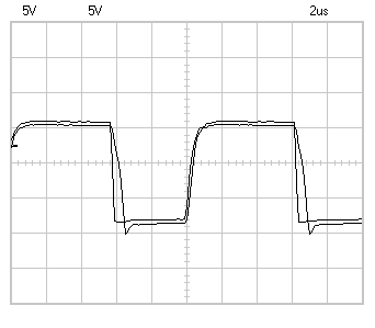

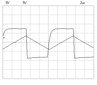

In the datasheet of the LM393 I found the schematic for a simple 100 kHz square wave generator. The output isn't a perfect square wave, but good enough.
I built it on a breadboard and tried some different opamps in voltage follower configuration. That yielded some interesting results.
In the attachment you'll find the results in this order: left to right top: CA3160, NE5532, NJM4558, NJM4560, OPA627, left to right bottom: TL062, TL071, TL082, UA741 and LF411.
These are the opamps I have lying around. In- and output signals are overlayed.
Not all opamps could follow the 14 Vpp, 100 kHz output of the LM393 accurately. The CA3160, NE5532, TL082 and LF 411 seemed reasonbly capable. The NE5532 seemed to load the output of the LM393 a bit increasing rise- and falltime considerably.
The only opamp capable of following the input accurately was the OPA627, as you can see. Some cheap opamp masquerading as OPA627 probably won't be able to do that.
The LM393 was supplied with +15 V and GND, the opamps with +/- 15 V.
