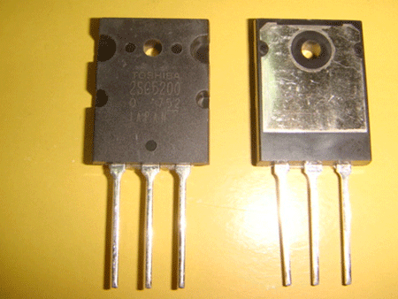

Actually, TOSHIBA produce a pair of 2SC5200-0/2SA1943-0 with mica together, and I put the original photo of 5200 to let you have a look.
Some people will use simillar funtion transistor to fake 5200, but you look the face of 5200 and see if it is laser typing.

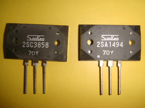

Actually, the packaging of 2SA1295 /2SC3264 is not TO-3 is called MT-200. I put the photo of 2SA1494/2SC3858 with same packaing of MT-200.
Check if the transistor is fake or not, you just see the typing on the face. The origianl one's typing used laser and clearer.

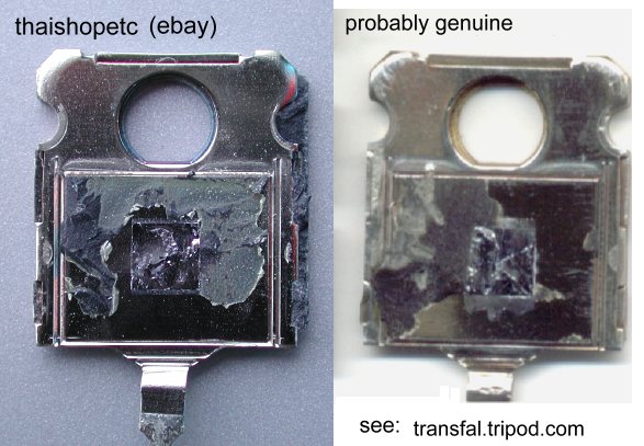

I bought a dozen of these 2SC5200 from ebay seller thaishopetc. Looks good and sounds good. $ 1.40 each, and rather low shipping cost. The seller has a wide range of electronic components on his list, and none of the fancy stuff one sees from some h.k sellers etc. I would not be surprised if he uses good sources for the stuff. He also has a very good feedback rate
